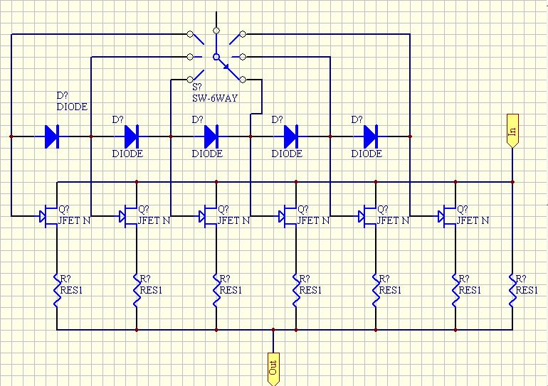

I can't divulge much due to the NDA. I need to select a load that increases the current based on additional 100 ohm increments when placed in parallel like the picture below. It does not have to be parallel, but the only series implementation I have come up with isn't feasible.

If you use FETs, you could actually implement the rotary switch control, by stringing the FET gates together with diodes and connecting an increasingly-long string of them to gating voltage with the switch. (If you don't get how this would work I could draw it out.)
I'm picturing a string of 8 diodes with each switch position. There would be a switch position, a diode cathode, a diode anode, and FET gate all connected together at each but the first and last (they would be missing a diode cathode or anode connection). Here's my question, when selecting minimum current, the last voltage of the last FET gate will be 7 diode drops less than the first diode. When selecting maximum current the FET will see the most voltage, will the FET gate handle that or work under both extremes. I'll sketch something shortly.
P.S. I thought of a similiar design using relays but was fairly sure there wouldn't be enough voltage to trigger the last relay after 7 diode drops.

If the last few diode drops are a problem (don't think they will be, just set things so that the gate with the most diode drops still gets sufficient gate voltage), you could use Schottky diodes with smaller drops (or germanium: 7 x 0.3 = 2.1V).
You would want to use P-MOSFET or PNP bipolar transistors for you switches if you are driving a grounded load.

I definately don't want to use PNP transistors. Why P MOSFET for grounded rather than N-MOSFETs?
Because to drive a grounded load an N-MOSFET has to operate in a source-follower mode, thus the gate of the N-MOSFET must be 10V above the drain (supply voltage) for a typical FET or 5V above the supply for a logic-level type MOSFET.
