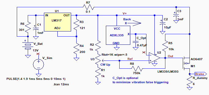

If you're confident in your initial circuit diagram, I'll order parts and put it up on a breadboard.
Any last minute ideas or tweaks before I place the parts order?

It's as good as I can do with just simulation. You'll have to be the Beta tester. :rolleyes:
You will also need some sort of small proto board and housing with provision to be able to tweak the trimpot U3 to adjust sensitivity.
The P-MOSFET can be just about any with an Rds ON resistance of ≤0.2Ω, so just buy the cheapest you can find.

That should be okay as it has the same accelerometer chip with apparently an added regulator so that the power input voltage can be from 3-5Vdc.
The LM317 is set for 3.3V so that's not a problem.
There is a small addition.
I added an optional capacitor (C_Opt below) on the magnetometer output to filter out possible spurious flashing due to vibration.
You'll have to experimentally determine if it's needed, and if so, how large.
It will slow down the response time some so that's the tradeoff.
I would buy 0.22uF, 0.47uf, and 1.0uF ceramic caps for that purpose.
Note that the box must be mounted to a solid location on the bike but some foam padding underneath would minimize the effects of vibration.

Thank you. Tomorrow I'll put the order together. I might have some questions if I don't understand the symbols or other terms.
The idea of an LED so the rider can monitor the performance is good, and shouldn't be too hard to add.
I don't understand some of the nomenclature or assumptions.
1. What power rating should I get for the resistors, especially R1 and R6, that have direct connections to the battery?
2. What is R_dummy and "6" beneath it?
3. The capacitors, all rated for 13-14 volts (bike's system voltage)? Get non-polar ceramic caps for all?
4. Regarding U2, which I think is LM339 or LM393, the datasheets of the products all show integrated circuits with about a dozen connections (see example attached). How do I wire it in? Which points are used for this circuit?
5. M1 A06407 - this is a mosfet, right? I couldn't find it Mouser's catalog. Is it written correctly?
6. U3 is potentiometer with a 1k maximum, is that right?
I apologize for the many questions. This is an area I'm still learning about.
They dissipate very little power so can be 1/4W or smaller.
That simulates the bulb load so is not on the real circuit.
The ones with the polarity (+) sign are too large (1mF or 1,000μf) for ceramic so they must be electrolytic and rated for at least 25V.
The rest should be ceramic.
There are 2 comparators in the LM393 and 4 comparators in the LM339 but you will only be using one, so you can ignore the others.
Power and ground are pins 3 and 12 in the schematic you referenced.
Using the top left (#1) comparator, the (+) input is pin 5, the (-) input is pin 4, and the output is pin 2.
I forgot to mention that you should buy a socket for whichever comparator you buy.
Make sure you buy the comparator in a DIP package and get the DIP socket with the same number of pins (14-pin for LM339 and 8-pin for the LM393)
Yes, that's just an arbitrary device I had in my model library.
You can use just about any P-MOSFET with sufficient current rating.
This, for example, is cheap and should work.
Yes, it's a small trimpot with screwdriver adjustment.
Pick one that is 10-25 turn and has the adjustment screw where it's readily accessible.
Note that you should buy at least one or two extra of everything to allow for attrition (goofs). ;)
