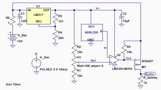

Design Request - Deceleration Activated Brake Lights
Here's my basic circuit concept:
What is the brake light bulb type and how many are there on your bike?
There is a single brake light bulb, 12V and 21 Watts. Standard incandescent, although I was thinking of going LED, but that's a different project for a different time.

Can you do some tests to see how long it takes your bike to slow down say 10 or 20MPH when you back off the throttle under the conditions (speed and gear) that you want the brake light to come on?
(Just don't kill yourself in the process). :eek:
That will allow the calculation of the negative G forces involved and thus how much signal to expect.

I think you are looking for what's called "engine braking." I used to work in traffic accident reconstruction, and book values for engine braking are available for passenger cars. None are published for motorcycles, but they would be greater (greater engine to vehicle weight ratio). Standard book values are:
less than 20 mph = -1.3 ft/sec sq or -0.39 meter/sec sq
20-40mph = -1.6 ft/sec sq or -0.48 meter/sec sq
over 40 mph = -2.6 ft/sec sq or -0.78 meter/sec sq
Does this help?

It's not a problem. I'll do it this weekend; I'll measure the time it takes to slow down in gear in average traffic. Say from 40 mph to 30 mph, or from 40 mph to 20 mph. Should be a few seconds.
I see that the accelerometer measure acceleration in "g," a multiple of the force of gravity (9.81 m/sec squared or 32.8 ft/sec squared).
The figures from my earlier post, converted to g: vary from 0.040 to 0.079 g. I expect my bike should come out around 0.08 g.
Is that the kind of information you need? The range of "g" of the deceleration?

Yes. If you measure the time it takes to slow 10MPH, the average g force can be calculated.
The worst-case is likely the slowest initial speed in high gear that you want the device to work.
Since the accelerometer output is give in V/g, I need to know the g to determine the output signal we will be getting.
g is just another unit. e.g. 1g, 2g meaning 1x the acceleration of gravity, or 2x the acceleration of gravity,

Looking at the instruction manual for the listed unit where they mention mounting: Mount flat or on edge with arrow pointing forward. Mount module as level as possible +/- 20 Degrees. I think we can pretty much figure they use an accelerometer to detect deceleration. I liked crutschow's circuit. If I went with a uC I would consider a simple 8 pin flavor maybe like a PICAXE 08M2. Also with the originally linked unit they mention Sensitivity and how to adjust for Sensitivity.
