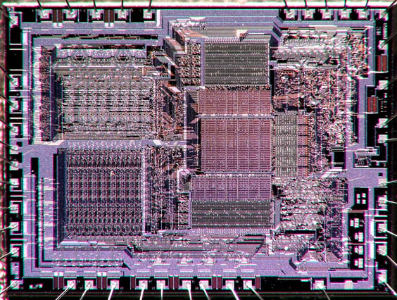

I also know that Intel built the prototype for the 80286 ('286) in TTL logic on 10 breadboards. Here is a pic of the 8085 die. I believe the micro decode ROM is the lower left. Also, on the block diagram, you can see how they group 2 8 bit registers into 16 bits. The HL register was also the index register.

The data and the address bus widths are rarely the same. On the 8085 microprocessors, the data was 8 bits, but the address was 16 bits (same with the 8051 microcontroller, you can put the code memory external). The instructions were of 1, 2, or 3 byte lengths, depending on the instructions and where the operand was located. On the 8086, the data was 8/16 bit (8088/8086), and the address was 20 bit. In order to run 8 bit code (software development cost a lot more than hardware) and get 8 bit users to migrate to the new 16 bit processors, the 20 bit address was obtained by adding a segment register to a 16 bit operand/address register. So the 8086 has a superset of the 8085 instructions. It runs all the originals, plus a few segment resgister commands that won't be found in 8 bit code, so they had no effect on the processor. This is the 64k limit of the old .com programs. Remember that DOS can run three program types: .exe, .bat, and .com.
The original IBM PC used the 8088 (8086 16 bit core with 8 bit data interface) to save on memory width. IC memory was also expensive in those days, so IBM chose a 9 bit memory interface architecture, but used the 16 bit cpu core to address 1M bytes of memory.
ALU width depends on what types of functions you are trying to do. 8x8 multiply? You better be able to access a 16 bit output register. Most micros do this by using register pairs. Divide Instruction? 8 bit / 8 bit isn't very practical, but 16 bit / 8 bit is.
Decoder? Is this the instruction decoder? The instruction decoder width would depend on how many instructions you want to use. This is where the CISC and RISC battles take place (complex instruction set computer, and reduced instruction set computer). Complex instruction set computers can do a powerful operation in one instruction, but may take 2, 3, or 4 CLOCK CYCLES to carry out each instruction. This is because of the complex decoding an operation of each instruction. RISC machines have a very simple set of instructions and complete each instruction in one CLOCK CYCLE. However, it may take 2 or 3 instructions to do the same task as a CISC machine. Our guided missiles had the very first 'microprocessor' design for its control computer. What makes a microprocessor different from the 'normal' computer of the day is that most computers used instruction decode loops (hardware) to carry out instructions. Each instruction had a chain of logic gates that was responsible for implementing the instruction, gating data in a sequential order. With the microprocessor, it has a micro decode ROM, and each instruction op code is actually a pointer to a program to carry out that instruction. Basically, it is a set of gating commands. Data from each decode ROM address is put into the micro decode register, 80 bits long in the case of the guidance computer on the missile, and each 1 or 0 in the instruction register caused the gating of data from point a to b. 80 bits long means there were 80 different flow commands it could turn on and off in sequence. That sequence being programmed from the micro decode ROM.
