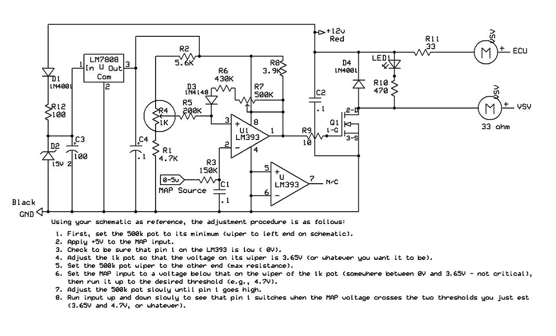

I am looking at this and I cant see any way to get my Vset up past 4v. By using the voltage divided method, if I use R2 at 5600 and R1 at 5700 (1000+4700) at 8v the formula is only 4v. I can see the 3.65v on the voltage divider when going by 6600 R2 and 4700 R1 when the pot is at the bottom of the wiper. What am I missing here? I have to get to a Vset of 4.7v into R9.

From post #99 (referring to the schematic on that post):
The adjustment labels probably look like they are swapped, but they are not.The adjustment labels probably look like they are swapped, but they are not.
The pot that used to set the threshold for when the input is rising now sets the threshold (range≈3.3V to 4V) for when the input is falling. The pot that looks like the hysteresis pot now sets the threshold for when the input is rising (range≈4.4V to 4.9V).
I explained all this before, but I know stuff like that gets lost in the noise.
Using your schematic as reference, the adjustment procedure is as follows:
1. First, set the 500k pot to its minimum (wiper to left end on schematic).
2. Apply +5V to the MAP input.
3. Check to be sure that pin 1 on the LM393 is low (≈0V).
4. Adjust the 1k pot so that the voltage on its wiper is 3.65V (or whatever you want it to be).
5. Set the 500k pot wiper to the other end (max resistance).
6. Set the MAP input to a voltage below that on the wiper of the 1k pot (somewhere between 0V and 3.65V - not critical), then run it up to the desired threshold (e.g., 4.7V).
7. Adjust the 500k pot slowly until pin 1 goes high.
8. Run input up and down slowly to see that pin 1 switches when the MAP voltage crosses the two thresholds you just est (3.65V and 4.7V, or whatever).
If this doesn't work, You may not hear from me until tomorrow. I'm going out gold prospecting today.:)
BTW, your LED is still upside down, and you have two R4's (the pots).

I didn't say that the LED and resistor were in the wrong order. I said that the LED was upside down. What I'm saying is, the anode and cathode are swapped. An LED has to be forward biased, with the anode toward the positive voltage.
I think it will be safe to eliminate C4 and C5.
I definitely like this new version that doesnt use the other side of the U1 pins. Saves components. why did you modify it this way anyways? Just curious.
I modified it because it is simpler.:) IIRC, I originally used the second section because I thought we needed to invert the output of the first one in order to drive the MOSFET.

OK, last run through to make sure it looks OK.
BTW, find any gold nuggets~!
Stu
Schematic looks good.

I suspect that eventually, you won't even need a pot where R4 is. A fixed voltage divider of something safe, like 3V, should work fine. Trouble is, we would have to redesign the R5 - R6 - R7 network after you did that, in order to keep the same upper threshold range. In the meantime, 1-turn trimmers should be OK, because I designed pretty narrow ranges for both of them, so you should still get adequate resolution.
I would use this capacitor for all the 100nF parts.

You are confusing the heck out of me. You are not planning to drive a relay with the MOSFET, are you?
In your latest schematic, when the input is below 4.7V, the comparator output will be ≈+12V. This has the MOSFET turned ON. The VSV will be energized. When the input exceeds 4.7V, the comparator output will be ≈0V (not 0.75V - where did you get that?). The MOSFET will be OFF, and the VSV will be de-energized.

The simplest solution is to use the second section of the LM393 as an inverter, as we did previously. You only need 3 more resistors (2 for the voltage divider on the input and 1 for the pullup on the output). Otherwise, you have to swap pins 2 and 3, as you said, but the positive feedback still has to return to pin 3, so significant redesign would be required to maintain your hysteresis requirements, possibly requiring even more parts.

That should work after you swap the inputs on the second comparator.

OK, here's what I came up with. I'm hoping you aren't using the other half of the LM393 for anything. I used it so we can get full output swing on the first one, making the hysteresis easy to attain. If the other section is not available, there are other possible solutions.
I think you were trying to build this with parts on hand. Let me know what you don't have. If it is not difficult to get parts, I recommend the values shown - except for the 2N2222, which might be susceptible to CE breakdown due to spikes on the car's battery rail. Something like 2N5550 would be much better. A small MOSFET could also work, which would also eliminate the need to use the 2nd half of the LM393.
