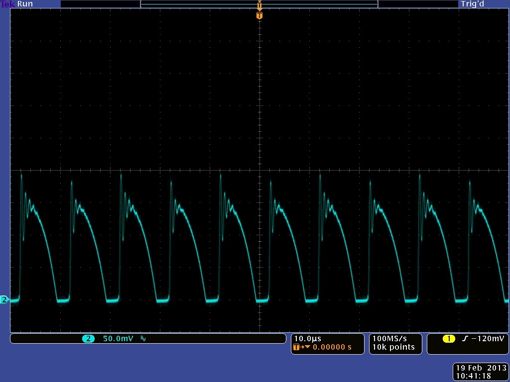

Actually, we also have a requirement for a C/10 charging current. In other words, charge at C/10 for 19 hours. However, the trickle charge rate is C/20.
Will it be ok if we PWM our C/10 charging source at 50% duty in order to make it C/20 on average, or will this kind of pulse charging make the battery life degrade quicker?
Our charging current source is a resonant inductive coupler, and these bad boys only chuck out one current level.....however, we can turn it "off" by shorting it out.
I fear that if we constantly trickle charge at C/10 , then our battery capacity wil degrade too quickly?
Also, i feel that C/10 constant trickle charging could result in the batteries overheating, do you agree?

Pulse charging is supposed to actually be better so you're ok there. C/10 sounds too high for long life though.
incidentally , this is what out battery charge current looks like, its 379mA average, peaks up to 1 amp...i know you say pulsey is good, but is this current waveform ok for battery charging?

Interspersing discharge pulses between charge pulses is known to improve charge acceptance of nickel-based batteries. Commonly referred to as a “burp” or “reverseload” charge, this method assists in the recombination of gases generated during charge.
The implication I took away from that source is that adding a "burp" to the charge cycle may be good for the battery. What you show looks more like relatively high frequency PWM. Since we know that PWM discharge is worse than average current discharge, I would be very suspicious of any claim that PWM charging was actually good for the battery.

PWM charging is ok but that look like 1MHz pulsing. The normal PWM would be maybe around 10kHz at most. So i cant say with certainty that the high frequency (1MHz) will charge the battery well enough or not. I can guess that it would, but without a test i would still have to wonder a little.
But a test isnt that hard. Charge it for the required amount of time knowing the average current, and then test the discharge of the battery to see if you get the full capacity or close too it.
I assume that you've used that waveform to calculate the average current. If not, post the amplitude of the highest peak and the lowest valley.
