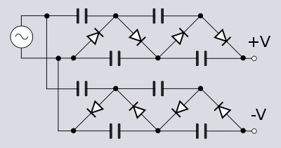

A diode buffer like this will work, just supply th 555 with the output of this ....

Note: That multiplier looks like a Cockcroft Walton multiplier .... (see video links below) I'll see if I can find the build instructions for the capacitors. I used tranparancy film and adhesive aluminum tape
7kV - Cockcroft Walton multiplier powered from a 12V supply
21kV - Cockcroft Walton multiplier powered from a 12V supply

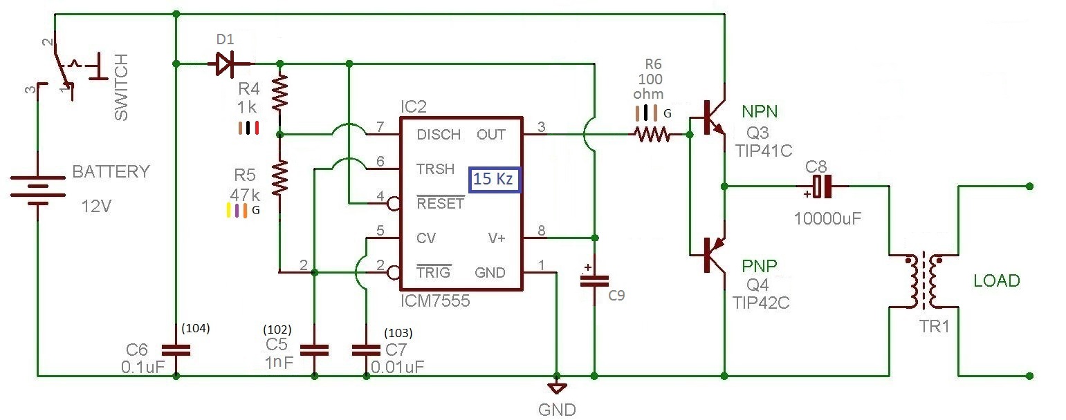

Beau thank you a lot for your reply. I draw a circuit with the buffer diode, just to confirm i am doing it in the right way.
If it is correct, can you tell me pls also the value of c9 ? Also with a the frequency at 15kz, will just an electrolytic capacitor work or do i have to use a film one ?
Your schematic shows a Cmos 555. Have you seen on its datasheet its puny output high current that is much less (1/25th) the output current of a bipolar 555?
Your diode has no part number. Use a 1N4148 but not a 1N4001 slow low frequency rectifier.
Why is your value for C8 so high that it passes extremely low frequencies?
Don't you hear the ringing at 15kHz from the transformer like an old TV or are you deaf?
The schematic was taken from internet and i just edit it a little bit. The 555 i use is a NE 555 IC, not the ICM7555. Ok i will use a 1N4148 diode for D1. Also the 10.000μF cap was there from the original schematic, i just use a 1.000μF 25v electrolytic capacitor, this cap is ok ?. Also what capacitor i must use for a C9?

The added diode & capacitor should be in the power feed to the 555 oscillator with just the power transistor stage feeding directly from the switch and power source.
The idea is to stabilise the 555 supply voltage so the output stage load current does not affect it.
As drawn, the transistor bases will be permanently "high" once the oscillator starts.
I'd also add an extra capacitor to the power circuit, across the collectors of the two transistors, again to minimise current surges and voltage changes away from the power stage.
rjenkinsgb can you saw me into the schematic where to add the capacitors and the diode because i can not understand, my English are not the best.
The value for C8 and any other coupling capacitor is calculated with the formula 1 divided by 2 x pi x R x f where R is the impedance of the load (your transformer primary) and f is your 15kHz.
Then if the load is 4 ohms the capacitor value is 2.7uF for half the power to the transformer. A capacitance that is about 5 times (13.5uF) will pass almost all of the signal.
For C9 I would use at least a 470uF.
Follow audioguru's advice for the resonant frequency formula. I can tell you right now 10mF and 15kHz are both way out of range. Find out what the inductance is of that transformer FIRST and work audioguru's formula backwards to find what frequency you should be running the 555 at.

Your battery must be tiny if it can supply only 6A. Then the max power from the battery is 12V x 6A= 72W and the circuit losses will result in an output of only about 57W. What do you have that runs from a unregulated squarewave with only 57W? The power will drop as the battery runs down so maybe only 40W.

Your circuit with a single Mosfet produces jerking pulses of DC power instead of smooth AC power. AC alternates positive and negative, pulses do not.
Your complementary transistors are emitter-followers that do not need the resistor at their bases.
