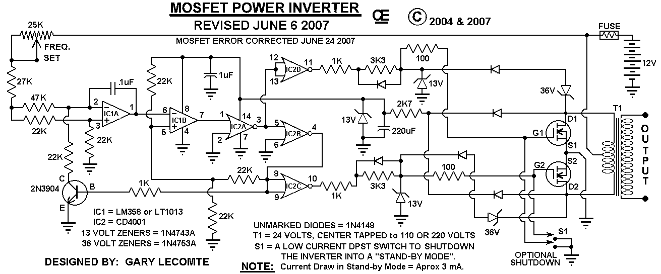

This One will give Considerable POWER.
chemelec thank you for your reply but dont you think that this is a bit complicated for my purpose ? As i said avobe, i just only want to charge some capacitors at 4-5kv.

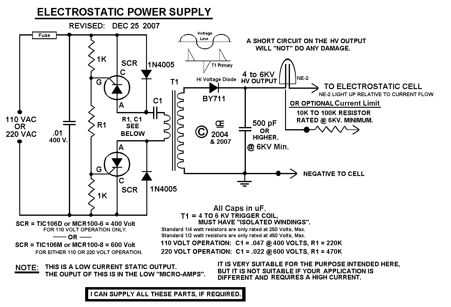

The capacitors are x4 1,3kv-5μF in series for total of 5,2kv-1,25μF. I am planning to charge them only up to 4kv for capacitors protection. I want to be charged from batteries, i am not going to play with my home 220v.
The 220 Might be Dangerous, But the 4KV Discharge from Those Capacitors Will be LETHAL.
Even though the circuit I Posted can operate from 220VAC, The HV Output is Totally ISOLATED From the Line.
To Get this HV From a battery, do a Google search for a Camera Flash Circuit.
These are usually a Double Step Up.
(So 6 or 12 volts to get 150 or 200 Volts, than this to step up again to the 4KV.)

I have another idea, What if i took a tv flyback transformer and wound the primary or adjust the voltage until i got about 4kv then just add a diode and charge the caps ? I have read that tv flyback transformers have a internal diode so maybe only just pulse AC half way would be better
If you do a Google Search on a "Camera Flash Circuit", You will see the schematics on how they step it up from 3 Volts to Several Thousand Volts in two stages.
SOME TV Flybacks have an Internal Diode, But Not all of them.
And most of them have Numerous Windings, Not just a Primary and Secondary.
Between that and trying to remove the Potting Material, It is Unlikely you could rewind them.
Aside from that, you can Make a Flyback from scratch.
Just need a Custom made Bobbin and some Ferrite Cores or a ferrite Rod.

If I got it right the system chem was talking about uses the trigger trans in a flash circuit, the circuit charges a cap up to about 300v, then a thyristor dumps this into a trigger trans primary, causing 4 - 6kv on the trigger trans sec.
Only a few milliwatts at most will be produced, but if your using this for thermionics or something that might be enough.
For a transformer, you could use an old car ignition coil.
I built a rig using one of those a few decades ago with a 2N3055 as a power switch and a multivibrator to control that; it could generate a large enough arc to run a small "Jacob's ladder" device.
I used a traditional metal can oil-filled coil, this style: **broken link removed**
The new encapsulated coil packs tend to arc internally and destroy their insulation if there is not a smallish spark gap as a load, so I'd not try them without a definite load to limit the voltage.
(If you try one of those I'd start at a very low drive voltage and/or with a current limiting resistor so you don't instantly destroy your rectifiers, until you can calibrate the needed drive for an appropriate output level).

I just bought x2 IR2153 IC and i am thinking to built an inverter based on this IC. I have an attachment photo of the circuit. I would like to drive it at about 50khz frequency, but i am not sure at what values i have to change for that purpose. I found an exe file that it looks that it calculates the frequency when you put the capacitor and resistor values. According to the program with 13k resistor and 1nf cap i have about 51khz frequency, is that correct ? Also i am going to use x2 IRF540N Fets
