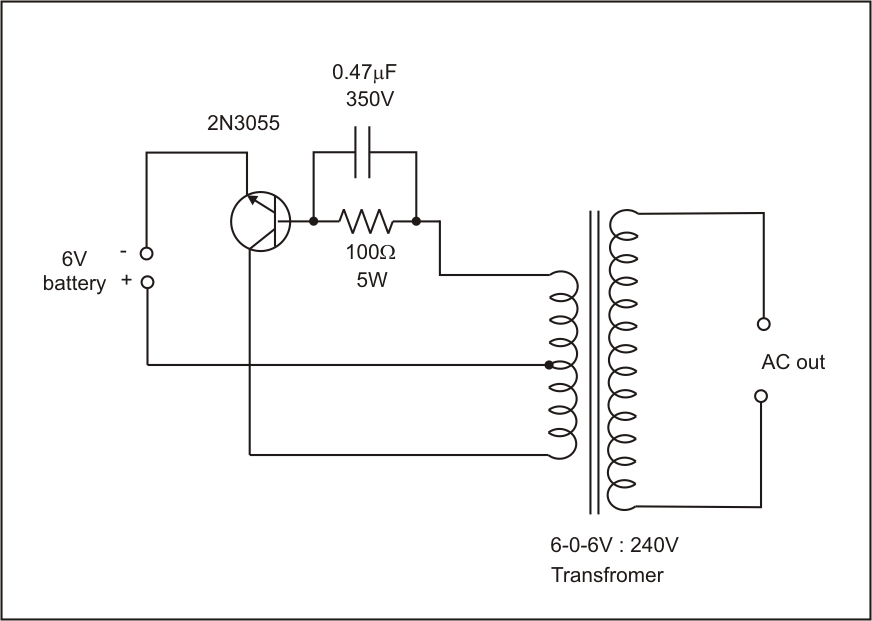

Here is a circuit for an inverter. I dont know where it came from, but this circuit has been with me for a long time.
Is there a way to set the frequency of that AC output? Like to around 60Hz?
The frequency can be changed probably by changing the RC values. This circuit can be actually used for lighting a small tube light with both pins shorted.
