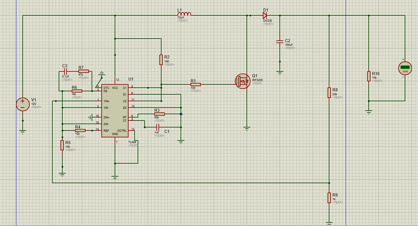

I am designing a dc boost converter as attached, 12V up to 60V.I want to make the simplest circuit but it still works fine. However, it does not work as expected, with no pulsating pulses in pins 8,11. The initial output voltage is 60V and then decreases without any stability. Someone please tell me where i'm wrong ??

I'd say theres something wrong in the feednack circuit, R6 is very high, and there is no resistor from R6 to the reference.
Also depending on the power your trying to provide the drive to the fet looks oversimple, some kind of active pulldown would make the fet run cooler.
I changed the R6 value (51k ohms and some other values) but the problem has not been improved yet.
i don't understand the other idea, i need a circuit to drive to the fet ???

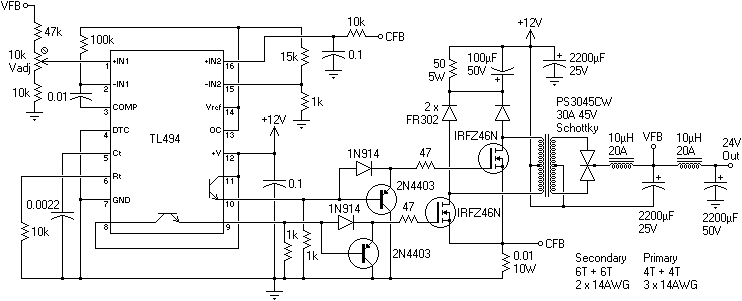

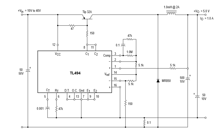

dr pepper is right. Look at the picture below. "5.1k" is missing. The TL494 is a very old and very strange PWM. Most people have not used it. R6 needs to have a high value. It sets the gain at DC.
Also please check your math on R8, R9. You want 60V. The resistors need to divide 60 down to 5V.
I already knew your schematic provided and tried doing so, but it didn't produce a good result.
I also used R8 and R9 to divide the voltage on pin 1 to 2.5 volts because the voltage on my pin 2 is 2.5 volts (not 5 volts as you said)
One potential problem with your circuit is that if the TL494's oscillator stops working the two internal output transistors remain 'off', so Q1 stays 'on' and hence the inductor and/or Q1 gets fried. The addition of a push-pull driver between the TL494 output and Q1 would provide phase inversion and keep Q1 'off' if there were an oscillator fault.
Ron, you see it a lot with the Tl494 where vref is divided to 2.5v, dont know why they do that.
The circuit is very minimal, so much so its unreliable.
As alec says the fet quiescent state is on, it would be better to wire the driver transistors in the '494 so that the o/p is high when the fet should be on, then use a pnp transistor to pull down the fet gate to low quickly so's not to have it operating in its linear region long.
But all of this would require a redisgn so I cant really help you further.

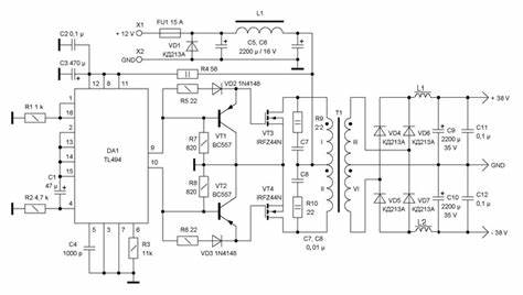

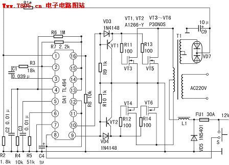

I see it now the logic on the output is backwards. alec_t & dr pepper are right. Here are some examples.
We really should be using a newer part. UC3843 is a good example. It was built to drive MOSFETs.
The bottom example above is what I was thinking about active turn off for the fets, they also cheated taking feedback before the last choke, making compensation easier.
Yep the chip is backwards.
