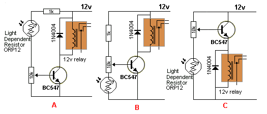

Turns out there is little need for all the complexity and components ! This given in Transistor amplifiers on Talking Electronics site is quite adequate-Don't understand why they want too show off their knowledge and waste your time making a simple thing complex .

The following circuits are NOT high-speed, but will activate a relay successfully.
Fig 74a.
..............Turns ON with light ....... Turns ON with dark
Circuit A activates the relay when light falls on the LDR. The level of illumination can be adjusted by the 10k pot.
Circuit B activates the relay when the illumination reduces. The level can be adjusted by the 10k pot. Circuit C is an emitter follower and although it works in a similar way to circuit B, the voltage on the collector is less than 12v by about 1v and this creates extra loss and added temperature-rise in the transistor.

Yes thanks Jim I have built and tested about 6 different circuits with variable complexities but the A circuit here with a BC 550 transistor of 50 volts seems to be going well at 24Volts. I have two of the Dark Detectors installed and working fine too . I needed the light detector circuit because one installation has a very dark interior and I didn't want the circuit out in the weather.
That is interesting because the circuit which you are using now is similar if not identical to the one which you started with and runs the risk of sitting in a half on - half off state with the transistor getting hot, as happened with your original build.
Just had a quick look at the BC550 datasheet, it has a much higher current gain that the 2N2222, which means that it is likely to go into saturation much quicker that the 2N2222 used in the original circuit.

Sorry that we are complicating your life. However, as with most advice and circuits you download off the internet, you get what you pay for...
IMHO, the talkingelectronics circuits are typical of the crap that is posted on the Internet!
As pointed out by Jim, the talkingelectronics circuits you posted have exactly the problem that brought you to this forum in the first place. Namely, as the sun goes up or down, the LDR resistance changes slowly, so the transistor turns on and off very slowly, and in the process, it goes through a region where it is dissipating a substantial amount of power, and is getting quite hot. That is exactly the problem that the (too complicated) Schmitt trigger circuits solve.
The only thing that keeps the transistor from burning itself up and self-destruction is that you happen to be using a fairly sensitive relay (if it is still the 12Vdc one with the 320Ω coil that you posted earlier). If you used a less sensitive relay, like the typical "automotive" 12V relay with the 85Ω coil, you would be replacing the transistor every day....
Let me use your nemesis, LTSpice, to show you the problem with the talkingelectronics circuits:
Here, I simulate the changing LDR resistance vs time. It is dark (200KΩ)at 0s and 200s. It is light (2K) at 100s. See the Green trace. I plot the actual LDR resistance divided by 10,000 to get it to scale onto the plot axis. I just picked a pot position (50%) that causes the transistor to go from fully-off to fully-on as the LDR goes from 200KΩ (20V on the plot) to 2KΩ (0.2V on the plot) and back again.
The red trace shows the voltage across the relay, which I guess is one similar to this one at DigiKey. Note if you download the data sheet, the relay coil properties are as shown on the schematic. Again, I assume that you want to run the circuit on 24V, but the relay is actually a 12V one, so I put the 330Ω resistor R2 in series with it.
The published pull-in voltage of said relay is 8.4V, so I use cursor1 on the plot to mark that voltage. Note that happens at 44s when the LDR resistance is about 110KΩ. This relay drops-out at 1.2V, so cursor2 marks that at 180s, where the LDR resistance is 160K.
The problem with this simplistic circuit is shown in the lower plot pane where I plot the power dissipation in Q1 (the light blue trace), where as the LDR resistance decreases from 200KΩ toward the relay pull-in value of 110KΩ, the transistor begins turning on and self-heats due to the power being dissipated in it long before the relay pulls-in. Note that the peak dissipation is ~0.24W, which is within the maximum rating of a TO92 plastic package, but will get hot enough to burn your fingers if you were to touch it. Note that the transistor gets hot again just before the relay drops out. Again, this is exactly the issue that the Schmitt Trigger version of the circuit solves... Note that if you used a relay with a lower coil resistance, like the typical Automotive relays, you would get the transistor so hot that it would self destruct.
I also plot the power in the relay (dark blue) and power in R2 (violet). Note that R2 should be a 1W power resistor.
