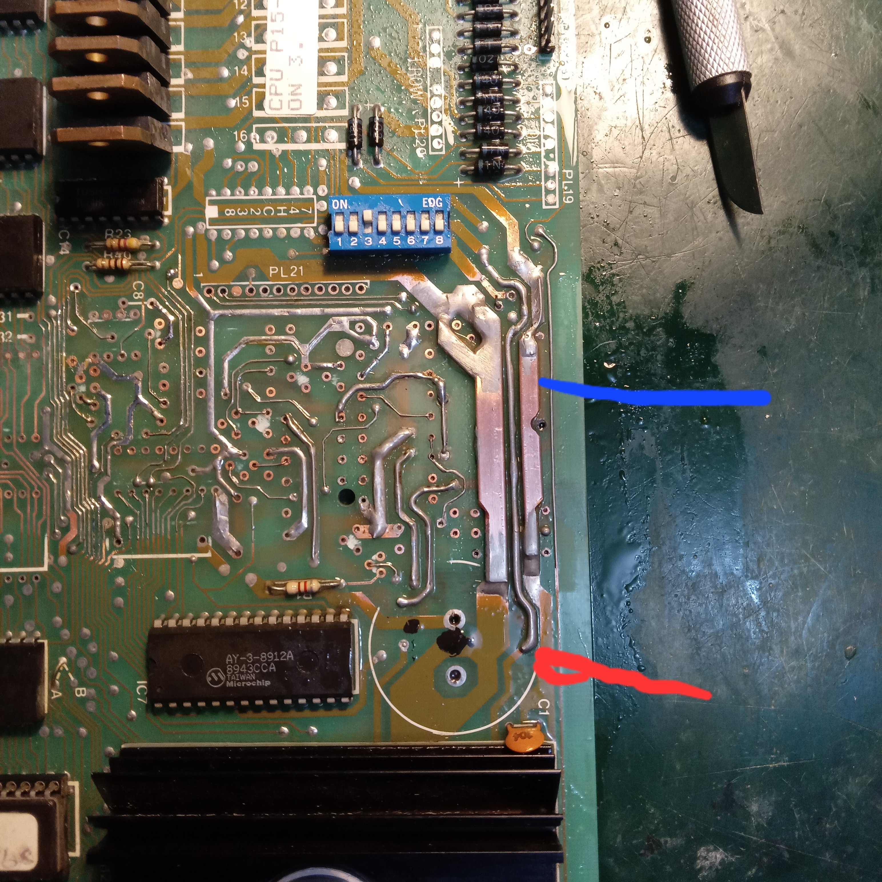

I'm working on repairing an old PCB where a CMOS battery has leaked. After repairs and cleaning up I'm measuring 71Kohms between the 53v and 12v rails (no continuity)
I do alot of battery damage repairs but because wanted to check people's thoughts on the leakage because it's between the power rails which is new.
Should I be concerned? Using ohms law it works out in the mA range (53v has a 10amp fuse?) It could be through components?
Any advice welcome

Yeah... the first pic Is the damage. The rails are close together at the top. It's very old and rare so worth working on.

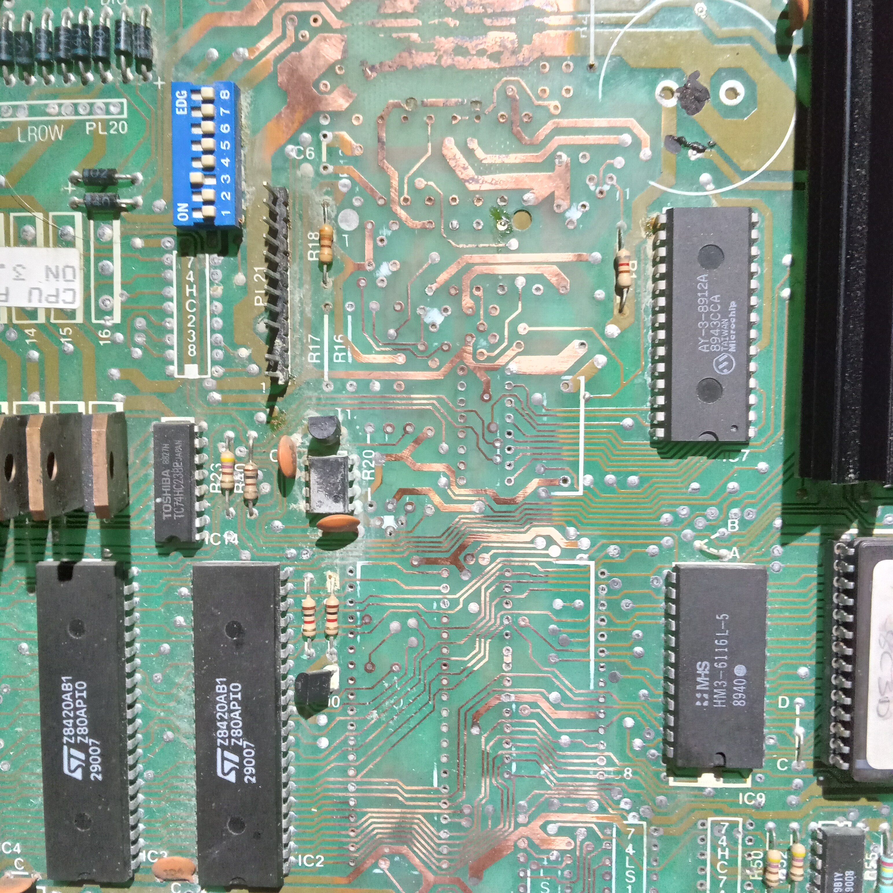

Pic 2 is the board about 50% cleaned up. The remnants of the rails I removed after this. The surface is scraped back too so there's no contaminated mask across the surface e

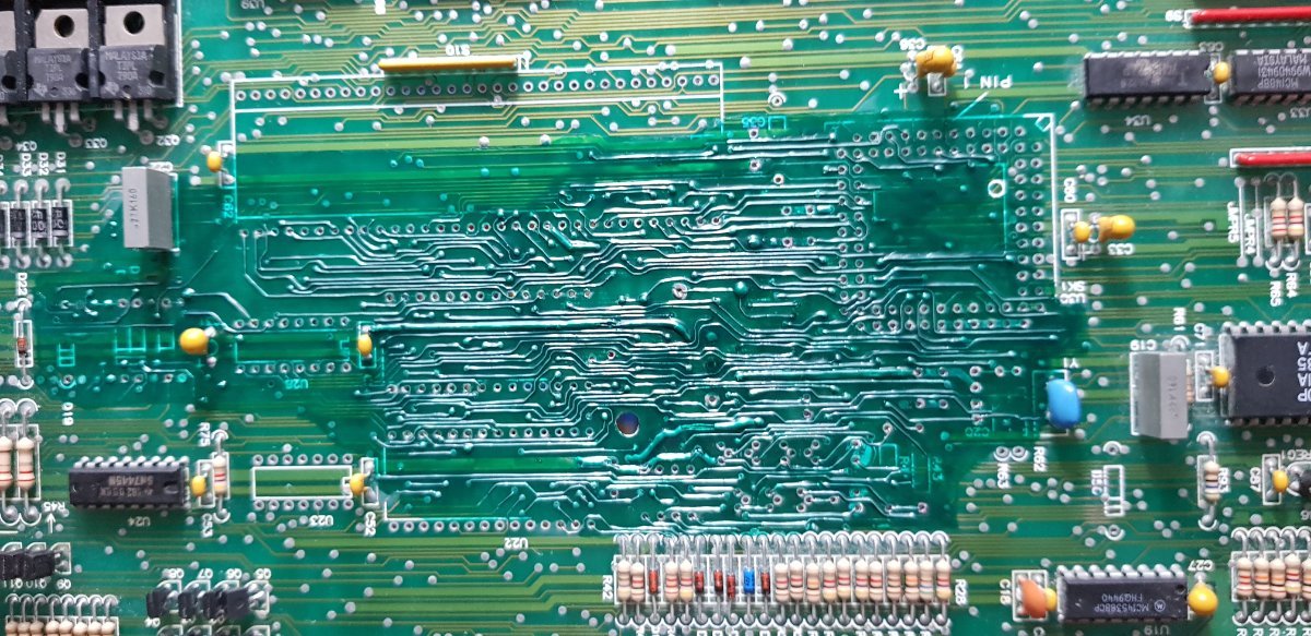

Pic 3 my repaired rails. I've fixed on new copper rails using epoxy. The board is wet from ipa in the pic. It's a work in progress still.

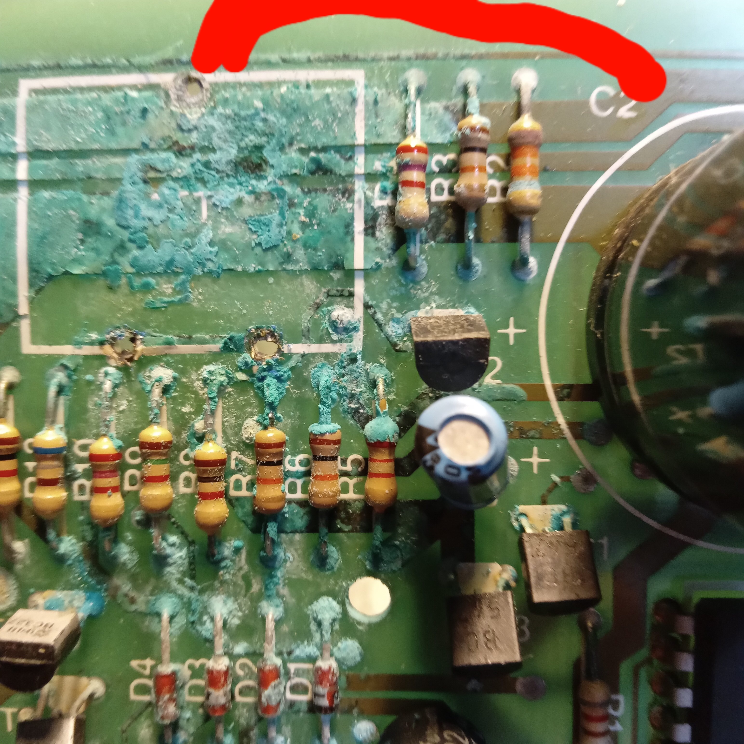

Pic 4 is a different board but shows how my repairs end up. Sealed in and insulated.
I know it's not ipc standards but I like doing it like this rather than a mass of wires on the back. It's just the 53v I'm worried about. All of these boards are BER but it's just for the challenge I work on them
