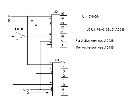

Yes you need to keep as much of the drive logic as possible.. You have to clock the states of the leds into the shift registers. When the row lines are strobed, the shift register bits will make the respective column leds light up. (I'm guessing '0': It lights up, '1': It's back-biased and it doesn't light up. It could be the opposite though.)
You'd probably need a 4049 to drive the shift register line clock. You only need one clock line (common for all shift registers),
but unless you do some kind of demultiplexing., you need a data line for each shift register.
That's not difficult to do.

Start testing the output of signals needed by connecting the pins to a power supply directly. The first thing you should decide is the number needed for activating 1 LED. It should be something in the form of "0bYYYYYYYYY.......". In hex "0x......".
