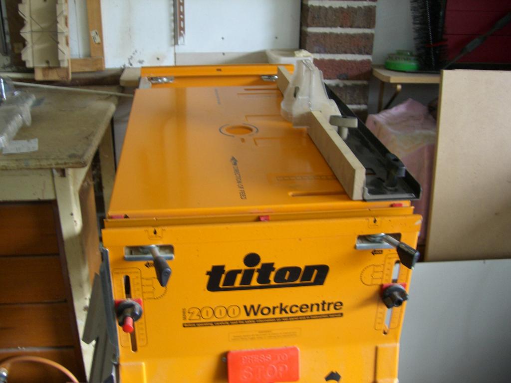

However, I have a Triton jig saw table that I can mount my jig saw (similar to the photo inserted by justDYI) and it has an adjustable guide so there will be no problem in making the cut straight. (I'll take a photo later and post it)
I have a mask to protect the lungs.

I took a photo of the Triton in the Jigsaw/Router mode but without the Jigsaw or router mounted.

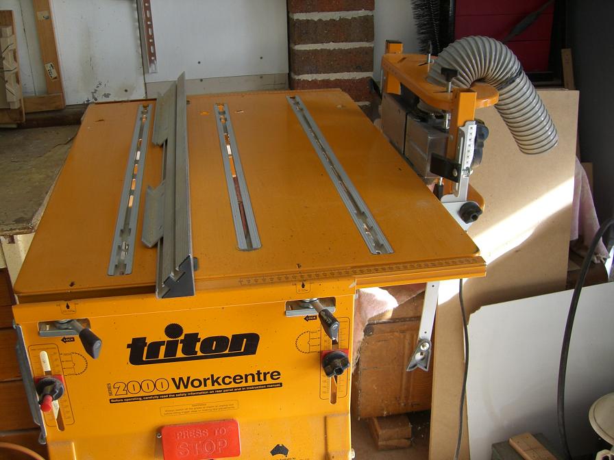

For anyone that is interested & has not seen a Triton, I also took photos of it in some of its other modes.
Photo 2 shows the bench saw mode.

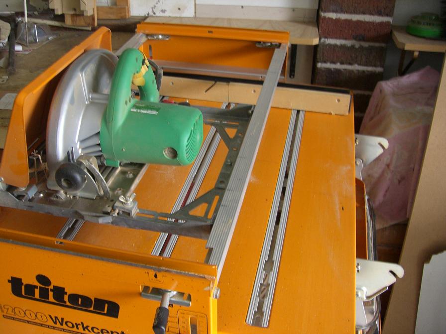

Photo 3 shows the cross cut saw mode, but I oriented the saw incorrectly. It should have been turned 180 degrees.

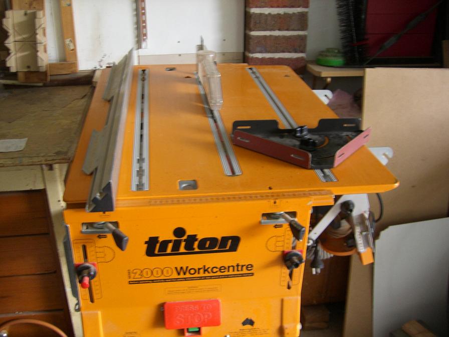

Photo 4 shows the planer mode.
It has adjustable mounting plates for a variety of comercially available power tools.

Here are the photos I tried to post before. See the descriptions above.
