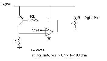

Voltage sink?? Not sure what you mean. Anyway, here's a fairly simple current sink for you. Not 100% accurate, due to opamp currents not flowing through "R", but should be good enough for your purposes.
So, if you have 2mA from your signal source, and set it so you have 1mA flowing into the sink, then arithmetically, you have 1mA flowing in your digital pot :p

Well.... Thats looks nice although I have NO idea of how thats works :(

It's a constant current source - it's quite easy to understand how it works from ohms law.
If you have a constant resistance (R), and you keep the voltage across it constant - by simple application of ohms law, the current has to be constant as well.
In this circuit the opamp is used as a comparator, comparing the voltage across R with a reference voltage - if the voltage across R is less than the reference the comparator switches the transistor ON, causing the voltage to increase. If the voltage across R is greater than the reference it will turn the transistor OFF, causing the voltage to decrease.
This action results in a constant voltage across R, which means it has a constant current through it - by changing the value of R, or by altering the reference voltage, you can adjust the constant current drawn by the circuit.
Obviously this requires that the voltage on the emitter of the transistor is always going to be greater than the reference voltage - once it falls below this, the current will no longer be constant. Obviously a low reference voltage would be a good idea.

Well, I tried that first diagram, and..... it didnt work :( There is 2.45ma in the signal wire and still 2.45ma on the wiper of my pot. Thats 1.45 too much. Yea, I followed the diagram EXACTLY, used a 741 for the amp, and a PNP transistor.

To explain phasor's diagram: The opamp doesn't really work like a comparator. The opamp provides feedback control to make sure the current in the resistor below the transistor and therefore the transistor itself is always 1m (set by the voltage on the - terminal). The way I like to think of op amps is they output whatever voltage is nesesary to make their two inputs the same (this rule only works for negative feedback configurations. The transistor works like a negative gain so this is negative feedback even though the feedback goes to the + terminal). So the op amp outputs the correct voltage/current into the transistor base to make the voltage it reads on its + terminal the same as its - terminal. The great thing about feedback is that you don't need to know what voltage and current the op amp is outputting you just need to know that it will output whatever it needs to. The voltage it reads on its + terminal depends on the current flowing into the resistor (no current will flow into the + or - terminals of the op amp - high input impedance). So you set the current the circuit wil draw by setting the voltage on the - terminal.

Probably, your signal isn't of large enough amplitude to provide a minimum operating voltage for the opamp. Maybe Russlk's idea will work better for you.

Phasor: maybe your right about the opamp, i have it hooked up exactly how the diagram is and it doesnt appear to do anything. arg.
