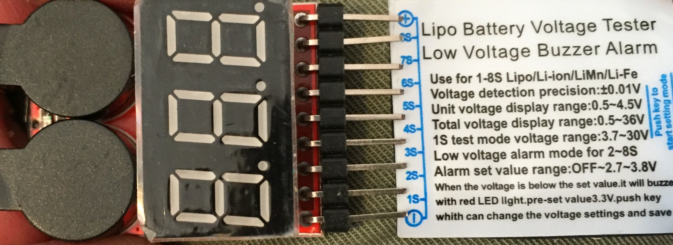

While waiting for components to arrive I have an other idea that may be bad or can work. Would be fun trying :)
I have a buzzer for lithium batteries. You connect the balance cable and set cut off voltage with a small button (between 2.7-3.8v). It makes a loud sound if any of the cells gets below your adjustment. It sends 3v to the horn that beeps.
If its possible, can I remove the horn and replace it with a relay that cuts off load when it "beeps"? A problem is that it beeps one time when you connect it to battery and that beep will trigger relay. I was thinking that maybe with a timer skip that first beep or something.
And that relay cuts off both load and buzzer itself. Buzzer consumes 9ma.
Is this something that can be done? :)
( This is not a replacements or anything I will choose instead of your circuits that I trust more. Just curious to know if it is working)
Buzzer looks like this:

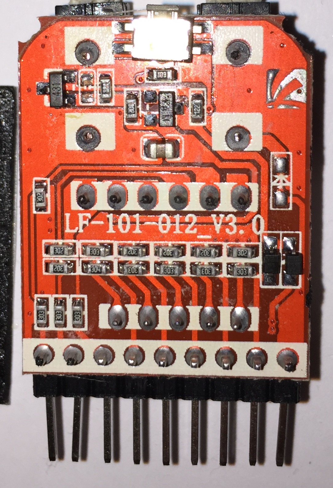

Hi Spec :)
Did not find any datasheet but here is a picture from the circuit.

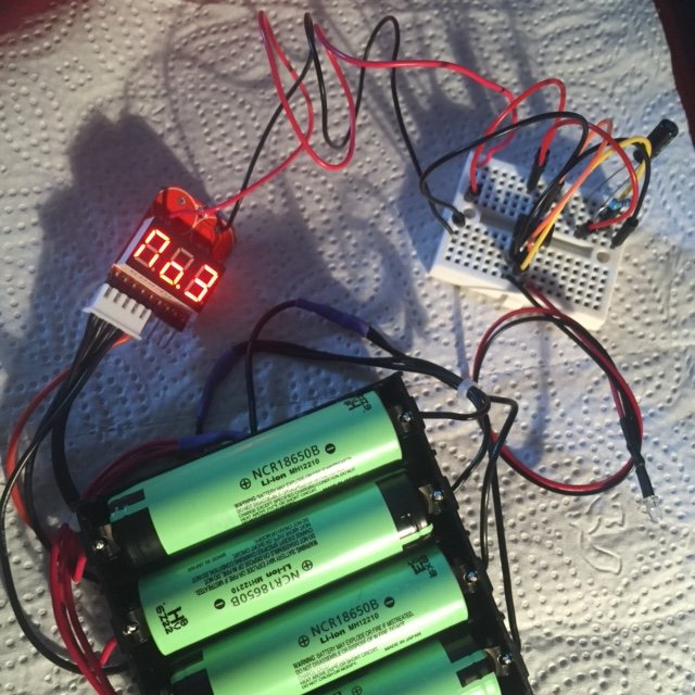

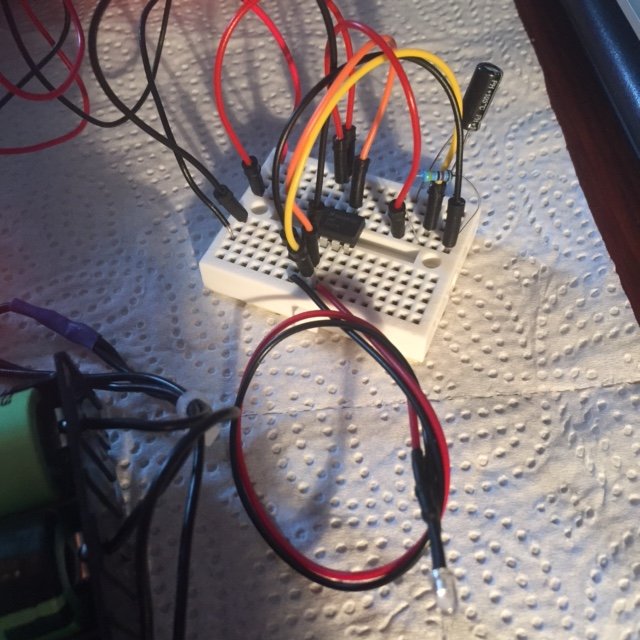

Today I tried to put together the 555 circuit and it seems to work. If I connect 3.3v from a power supply and have a LED on output on the 555 it waits until capacitor gets loaded and then lights constantly.
Problem is when i instead connect battery pack to buzzer and buzzer to 555 circuit . When battery voltage gets low it sends between 3.73-3.8v pulsating to horn. I unsoldered the little horn and connected the buzzer output to my 555 circuit and LED now is lighting very dim and flashes. I tried to put a capacitor (1000uf,25v) between buzzer output and 555 input but voltage doubles and LED is more bright but still flashes but with much shorter interval. (only putting a capacitor on buzzer output and measuring voltage not connected to 555 it looks stable 7.6v)
What can I do to stabilize the output voltage from buzzer to the 555 circuit?

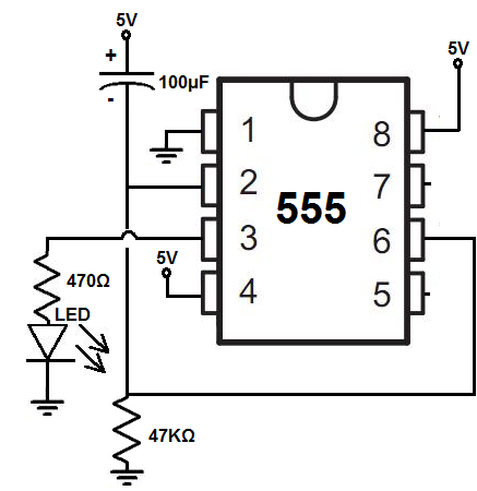

555 circuit contains:
LMC555
100uf, 25V
47K
I don´t want to give up on this before I continue to build rest of the circuits :)

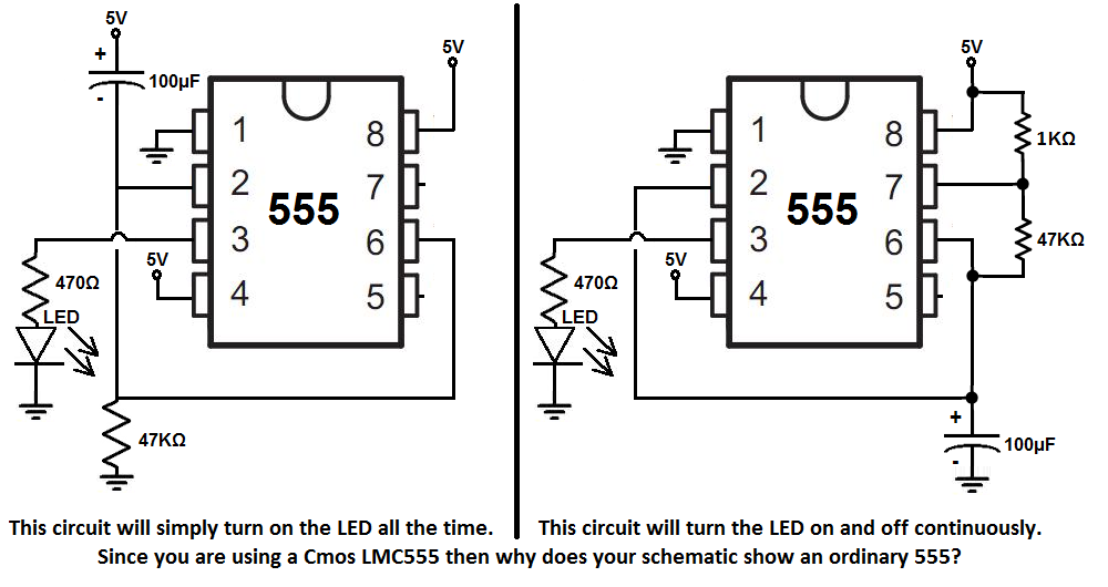

Your 555 circuit is wrong and will not do anything. You should look at the circuits in the datasheet of the LM555 and LMC555.
You show four Lithium battery cells powering an LMC555. The four cells will produce 16.8V when fully charged but the datasheet for the LMC555 shows an absolute maximum supply of only 15V so maybe your LMC555 is destroyed.

I show four lithium cells connected to a buzzer.
The buzzer alarms when any of the cells gets under adjusted lowest voltage. I removed the buzzer horn which is powered by ~3v from the buzzer. Im using the 555 circuit to avoid a first beep made by the buzzer on power on. It is not sending 16.8v to the circuit. Sorry if Iwas not clear enough. Problem is its not constant 3v . It is pulsating and if I connect a capacitor to the cables from the buzzer i get double voltage
Maybe the buzzer horn is not a DC buzzer, it might be an AC transducer (speaker) instead. Then maybe you measured the average 3VDC of an AC signal that drives the transducer. If the AC signal goes from 0V to about 7.6V peak to peak then a capacitor on it might filter the signal to produce 7.6VDC.
I see that your LMC555 circuit output goes low immediately when power is applied then goes high after a delay to prevent the power-up first beep.
You said that you connected the buzzer output to the 555 circuit but your schematic does not show what the buzzer output connects to on the 555 circuit.
