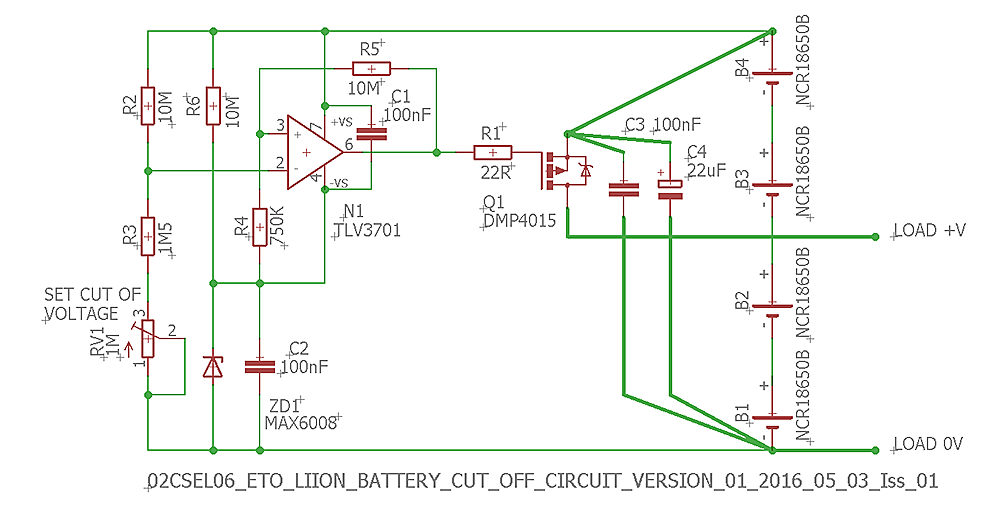

Make R8=42.2K (nearest 1% value). The trim pot makes it adjustable from ~12V to ~13V.
After it disconnects the load, the circuit draws ~170uA from the batteries. While the load is still connected, the battery current is the load current +~170uA.
Put the ON-OFF switch between the batteries and my circuit.

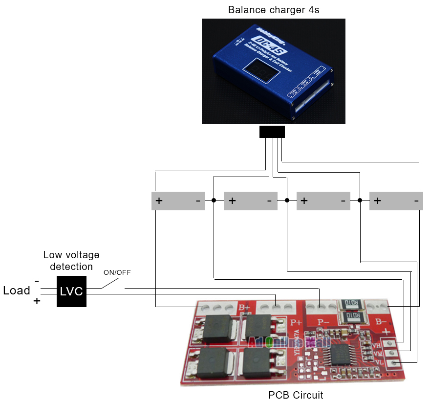

Does this look correct connecting batteries, pcb, charger, lvc and load? And a 5A fuse close to battery.
This is my PCB:

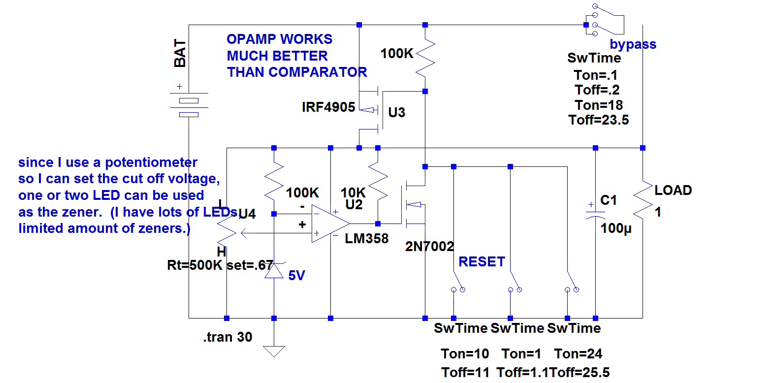

Here's one I used on my camper so I wouldn't run the battery too low to start the truck, it worked real good, except for the fact that I put the reset button in a very awkward place.
Because some batteries regenerate their voltage once the load is removed, I made this so it locks itself out until reset or bypassed, either one will reset it if the voltage is above cut off, bypass has to carry the full current of the load, reset button has minimal current.
I show several switches, but that is get different switching times for simulation, only one is needed for resetting the circuit once the battery is recharged.
Jeff

2016_05_08 Issue 03.00 Also see post #69
Here is the LiIon battery voltage cut off circuit that I mentioned previously:
ERRATA
(1) Delete C4
(2) Change C3 to 22uF 25V ceramic type (no leakage current)
(3) Change R4 from 750K to 82K
(4) Change R3 from 1M5 to 2M
(5) On parts list PMOSFET DMP4051 should read DMP4015 (the Mouser link is for the correct part though)
NOTES
(1) N1 is a low current (1uA) comparator with a CMOS push pull output
(2) ZD1 is a 2.5V low current (1uA) precision (+-0.2%) Zener diode
(3) R5/R4 provide 100mV hysteresis per battery (3.1V and 3.2V) to take care of battery rebound.
(4) RV1 sets the cut off voltage to 3.1V per cell and can be adjusted to give +-400mV variation in cut off voltage
(5) The circuit layout and routing of lines is important and should be as shown on the schematic to maintain accuracy and reduce the likelihood of frequency instability.
(6) The capacitors are for decoupling to assist frequency stability and have no function in regard to the basic circuit operation. They should be physically as shown on the schematic.
(7) R1 is a gate stopper to prevent the PMOSFET from oscillating at a high frequency (not peculiar to this circuit) and should be mounted on the PMOSFET gate pin. R1 plays no part in the basic circuit function.
(8) The total current drain of the circuit is, 3uA while cut on and 4uA while cut off
A problem with the Chinese board are that they cannot explain in English if it is a charger or if it is a protection circuit because they say both.
Other problems are that its overvoltage limit is too high, its undervoltage limit is too low and its current is way too high. Therefore it will provide NO protection for your little battery.
Jeff
Thank you! I will spend some time try understanding this as well.
The way I see it and what I read on other sellers descriptions it´s not a charger, just a PCB that checks each cells voltage. My balance charger will not charge more than 4.2v and will stop after that.
Whats the difference between "lift voltage" and "detection voltage"? I agree 4.25v overcharge and 2.5v over discharge is bad but is better than nothing. If it´s stops at 4.15v and 3v it´s more ok.
I don´t agree it will provide NO protection compared to no protection at all.
I thought current specification was that it can handle more current without cut off? For example if batteries can provide 5A and PCB only can handle 2A, it blocks for what I need
If you know a PCB with better specification for my purpose I would be very happy to buy it?
I'm confused about what they write:
what is "lift" and what is "detection"?
overcharge detection voltage :4.25±0.025V
overcharge Lift the voltage:4.15±0.05V
over discharge detection voltage :2.50±0.08V
over discharge Lift the voltage:3.00±0.1V
overcurrent current:20-30A
working current:15A(Natural cooling 10.A, add heat sink 15A, the maximum instantaneous current 30A)
