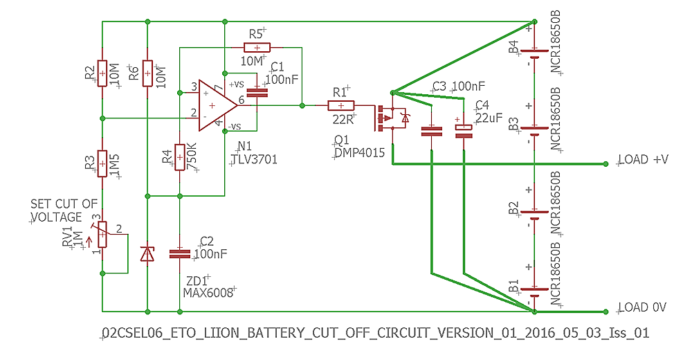

Here is the LiIon battery voltage cut off circuit that I mentioned previously:
ERRATA
(1) Delete C4
(2) Change C3 to 22uF 25V ceramic type (no leakage current)
(3) Change R4 from 750K to 82K
(4) Change R3 from 1M5 to 2M
NOTES
(1) N1 is a low current (1uA) comparator with a CMOS push pull output
(2) ZD1 is a 2.5V low current (1uA) precision (+-0.2%) Zener diode
(3) R5/R4 provide 100mV hysteresis per battery (3.1V and 3.2V) to take care of battery rebound.
(4) RV1 sets the cut off voltage to 3.1V per cell and can be adjusted to give +-400mV variation in cut off voltage
(5) The circuit layout and routing of lines is important and should be as shown on the schematic to maintain accuracy and reduce the likelihood of frequency instability.
(6) The capacitors are for decoupling to assist frequency stability and have no function in regard to the basic circuit operation. They should be physically as shown on the schematic.
(7) R1 is a gate stopper to prevent the PMOSFET from oscillating at a high frequency (not peculiar to this circuit) and should be mounted on the PMOSFET gate pin. R1 plays no part in the basic circuit function.
(8) The total current drain of the circuit is, 3uA while cut on and 4uA while cut off

Hy Rorrut,
Just open the attached pdf file under 'Parts List' in post #38 and click on the links for each component. The links take you to the product listing on the Mouser web site. The trouble is that the manufacturer's have gone mad with their part numbers: endless strings on letters and numbers, with no structure. MOSFETs are some of the worst in this respect and for micrcontrollers you need to write a book to get the right part.:eek:
Here is a link for the LM431: https://www2.mouser.com/ProductDeta...LM431ACZ/?qs=sGAEpiMZZMvAvBNgSS9Lqn4E3LoDYvrk
The LM431 comes in three precisions: +-0.2%, +-0.5%, and +-1%.
Always get the +-0.2% version- they are around the same price as the others, besides which all LM431s are dirt cheap and are widely used. The LM431 also comes in various packs- I have linked to the TO92 thru hole version which will be easier to handle.
If you have any further problems just post.:)

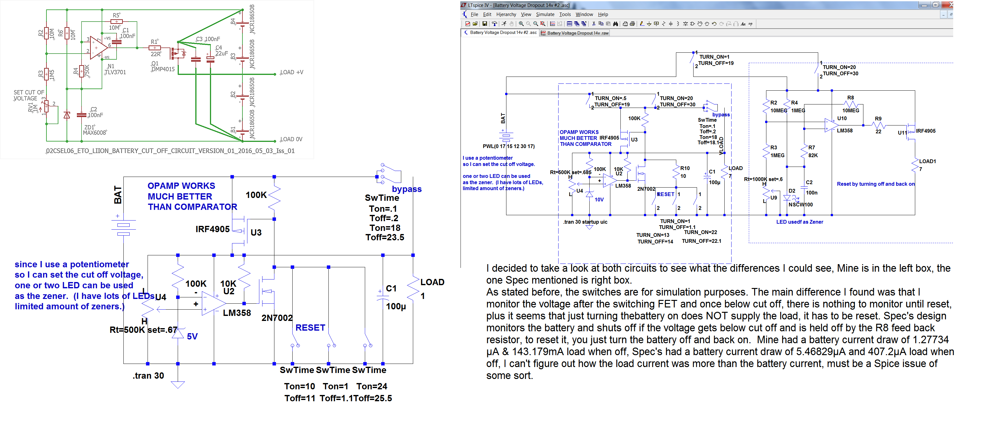

I decided to take a look at both circuits to see what the differences I could see, Mine is in the left box, the one Spec mentioned is right box.
As stated before, the switches are for simulation purposes. The main difference I found was that I monitor the voltage after the switching FET and once below cut off, there is nothing to monitor until reset, plus it seems that just turning the battery on does NOT supply the load, it has to be reset. Spec's design monitors the battery and shuts off if the voltage gets below cut off and is held off by the R8 feed back resistor, to reset it, you just turn the battery off and back on. Mine had a battery current draw of 1.27734µA & 143.179mA load when off, Spec's had a battery current draw of 5.46829µA and 407.2µA load when off, I can't figure out how the load current was more than the battery current, must be a Spice issue of some sort.

Hy kinarfi,
There seems to be something amiss with the spice simulation- not unusual. You do know that the comparator is rail to rail output and over and under the rails input.
The principle of the circuit in post #38 is that the cut off circuit (COC) is connected to the battery pack all times. When the voltage drops to 12.4V (3.1V per cell) the Schmidt trigger flips and its output goes to the positive supply line. This turns the PMOSFET off so that the load no longer drains any more current from the batteries. This action sets the turn on threshold of the Schmidt trigger to 12.8V (3.2V per cell) to account for any battery rebound (voltage recovery off load) and prevent chattering.
When the battery bank is charged and the the voltage reaches 12.8V the Schmidt trigger flips again and turns the PMOSFET on. There is no need for a manual reset.
As I said before, the current consumption is 3uA on and 4uA off.
Hy kinarfi,

One important difference between our designs is the battery we are protecting, you are protecting four Panasonic NCR3400 batteries, I am protecting a truck battery with 850 Cold Cranking Amps, so I'm not so concerned with current draw.
I do like the Schmidt trigger approach and will use it on my next battery protection project, the last one was removed when I sold the camper because I didn't think the new owner wanted to have to open the hood and push a tiny tactile button to listen to the radio (on occasion).
Sorry that the Spice file didn't work, I do have a tendency to modify .asy and .sub files to suit my needs, hope you were able insert items to make the .asc file work. If you would like, I would be glad to make sure my Battery Voltage Dropout 14v #2 .asc file has 'universal' components and re post it.

Hy Jeff,
Yes, we have designed for two different requirements. Now that you have explained your design objectives I can better understand your circuit. Afraid I rarely use simulations except for logic arrays and RF work where the component models are more accurate. I must down load LTSPICE some time and learn how to use it. By the way, Mike's TL431 circuit also has hysteresis and is much simpler if you are not too worried about extremly low current drain.
The OP is planning on building both circuits so it will be interesting to see how they turn out.
Thanks for your info too- as i have said many times before, I always learn something new from other designers. :)
