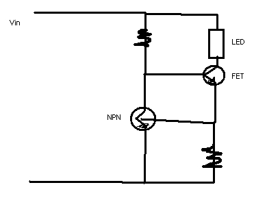

Hi everyone, I am a mechanical engineer who is in need of help! I am designing an underwater flashlight which will be using Luxeon high power leds. I have found a driver circuit which uses FET and NPN transistors and i was hoping someone can help me disect it a bit.
I have done a bit of research so i have a basic understanding of how NPN and FET transistors work, but i was hoping someone can just clarify a few things. I have attached the circuit drawing.
Basically at the end of the day, i want to limit the current going through the LEDs to 1A. My understanding of how this circuit is supposed to work is this:
- The bottom right resistor is chosen so that when maximum wanted current is going through it, the voltage drop is equal to the "turning on" voltage of the NPN (ie. ~.5V) . So I need a I=V/R => 1 = 0.5/R = > R = 0.5 Ohm
- When the circuit draws too much current, the NPN transistor opens up and the current goes mainly through the NPN transistor instead of the FET and it limits the current? THe reason i have trouble understanding this is because i read that FET transistors are voltage regulated, and in order to minimize the curretn going through the FET a -ve voltage is needed?
- How do you calculate the voltage drop going through a transistor? Is there any voltage drop?
- How do you select the resistance of the Top Left resistor?
- When the NPN transitor opens up, wont all the current go though it instead of the FET and completely shut off current going through the Load? How would this work as a self-adjusting circuit?
Hopefully someone can describe in detail what is going on with this type of circuit, i apologize for my lack of knowledge. I have been searching and reading the forums to piece together knowledge to find out how this is supposed to work.

The FET and resistor R2 to 0V, together with the voltage on the gate of the FET form a Constant Current source.
The value of the current flowing thru the FETand LED is determined by the value of the resistor R2 and the voltage on the gate of the FET, which is determined by the collector voltage on the transistor.
So when the current flowing thru R2 causes a voltage drop across R2 equal to the +0.7v required to switch on the transistor, it conducts and the voltage on the gate of the FET falls, this reduces the current in the FET and the LED.
So the current flowing in the FET/LED is limited.
What type of FET are you using.
The voltage on the FET gate is controlled by the value of R1 and the gate operating voltage of the FET. Refer to the FET's datasheet.
Does this help.?

So far for the calculations i have this:
R2 needed: V=IR -> 0.5 = 1A*R2 -> R2=.5 ohm
Vdrop FET (using 6V power supply, 1 LED which draws 3.7V @ 1A) :
Vfet = 6 - 3.7 - .5 (NPN activation) = 1.8V
Now i am kinda stuck on how to get the base voltage of FET or the R1 i need...

Because the NPN will NOT turn ON until the current flowing in the R2/FET/LED reaches a value that creates a voltage drop across R1 equal to +0.7V,
When the NPN is turned on, can you not consider the collector-emmiter line to be like a straight wire with no resistance?
NO, It has a an 'apparent' resistance

If you want a FET/LED current of about 1amp, then the R2 value would be 0.7ohms.. [ Volts= amps * resistance] V= 1 * 0.7R = 0.7V, which turns on the transistor.
That way i would be able to go through the design process and how you are supposed to calculate these. My problem is that i am not sure what depends on what. Like the FET will give a certain current based on base voltage regardless of the emmiter-collectro voltage drop? Im also confused on how if the e-c voltage drop is less than 2 (or close to the base voltage) then the current is controled by the voltage of the e-c, and if the e-c voltage is more than the gate voltage controls it?
The FET is a gate voltage controlled device, within the limits of the FET design, for the FET shown in your drawing, the higher the gate voltage the more current it passes. Until the R2 voltage drop switches on the NPN and the gate voltage is pulled down by the NPN thus reducing the FET current.
If you want to check out a circuit without blowing an LED, then in place of the LED connect a current meter able to indicate say 3 amps and the adjust the value of R2 until 1Amp flows in the meter.
The value of R1 would be around 10K
Is this clear.?

The current will settle at a value of about 0.7V across R2 since that is the voltage needed to turn on the NPN transistor. Thus the current is ~0.7V/R2. If the current varies from this the NPN will either conduct more or less which adjusts the current through the FET to bring everything back into balance. It's the miracle of negative feedback.

Pleased that you follow the voltage control of the FET gate.
The purpose of R1 is to control the voltage on the FET gate.
Consider that the NPN is NOT conducting, then the full supply voltage would be applied to the FET gate via the R1 resistor.
This would make the FET conduct as its a positive voltage, as the FET conducts the voltage drop across R2 will rise to about +0.7V which will turn ON the NPN transistor, so current will flow in R1 and the voltage at the NPN collector/FET gate will fall. This fall will reduce the current in the FET.
At some point a balance will be reached between the voltage drop in R2 and the conduction of the NPN. [ in other words the gate voltage on the FET].
At balance, due to negative feedback the current in the FET will be constant.
R1 is not there to limit the current into the FET gate, the FET gate draws almost zero current. Its a Field Effect Transistor, the gate voltage creates an electric field inside the FET, which controls the amount of current flowing from Source to Drain in the FET.
The value of R1 is chosen to suit the gain required by the NPN, I have chosen 10K as a starting point.
Whats the battery voltage going to be.??
Does this help.:)
Redrawn the circuit, added some values.
Is this clearer.?:rolleyes:

If the NPN is not conducting, how would the full supply voltage be applied to the FET gate? If there is almost no current going through the FET through the base, how would you do a voltage drop loop in this circuit?
When the NPN is NOT conducting its open circuit, so no current flows thru collector resistor, therfore there is NO voltage drop across the R1 resistor, so the full battery voltage is applied to the FET gate. The FET switches very quickly and it starts tp pass current in the LED circuit and R2. The voltage drop across R2 [0.6V] starts the NPN conducting and that causes current to flow in the collector resistor pulling the gate voltage down.
Remember the FET gate draws NO current.

I have chosen a NPN current of 1mA, which according to the datasheet gives a gain of about 50.

Its not the base current I have set at 1mA, its the collector current

There never could be 50mA flowing thru R1, use ohms law.
Also, one other thing that just popped in my head. I looked at the specs for the MOSFET, and if a 6+ volt is applied , the emmiter-collector current is 100 A?! If i had 3 leds and i need about 12V to supply them, and i need 1A (needs a 2V gate), where would the leftover 10V go??
The FET current can never get higher than 1Amp with the values shown.
Lookup negative feedback, from the NPN, the current in the FET is a Constant Current of 1Amp.
The voltage difference between the supply and the voltage drop across the LEDs [in SERIES] would be across the FET.
In a case like that the 10V at 1amp [considering just one LED] would generate a heating effect of 10Watts, you would need a heat sink on the FET.
You must NOT connect the LED's in parallel.

Yes that makes sense, without the NPN negative feedback there the current would go to 100A, but as soon as it rises to 1A, the NPN turns on and brings the current to stabilize...
And to select R1. I look at the specs of the MOSFET such as the FQP50N06L. To get 1A drain current, the gate voltage must be ~2.4V . Knowing this, we want to select R1 to give that voltage to the FET. Using a power supply of 6V, we need a 6-2.4V = 3.6V drop. So R= V/I = 3.6/10mA = 360 ohm?
Am i getting it haha? I think im starting to understand it better lol.

In your calculation for R1 you used 10mA, it should be 1mA. Also the 2.4V gate voltage is actually gate-to-source voltage. Thus you need to add the 0.7V source voltage (across R2) to the 2.4V gate-source voltage to give 3.1V required at the gate (to common). Thus R1 = (6V-3.1V) / 1mA = 2.9k ohm.
