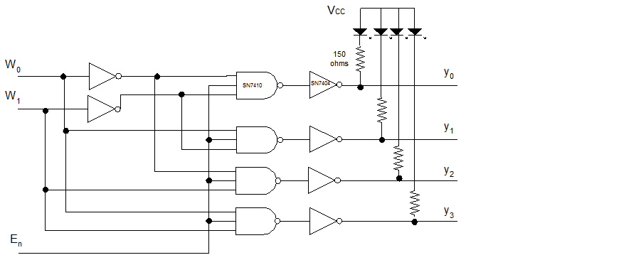

To confuse matters, it turns out I need to have active high outputs.
I only have available a 7410 Nand (I need 3 inputs) I was going to place a 7404 inverter (all I have available) on the output to get active high output.
I would like the LED to light up when output is High. Circuits are a 2 to 4 and 3 to 8 decoder.
How will the inverter change anything in terms of driving the led's?
You can drive the LEDs as well as the 7404 inverter from the Nand output. Standard TTL outputs will sink a maximum of 16mA. The 7404 input will require 1.6mA, thus leaving about 14mA to drive the LEDs. Will that be bright enough for your requirement?
So will I put the diode/resistor branch on the output of the inverter to Vcc? I want to LED to light when the output is high.
Also I only have 150 or 200 ohm resistors available, which side should I error on?
I think I was able to attach an image of the circuit?
No. If you connect the LEDs to the inverter outputs as you show, then they will light when the inverter's output is low. When the output is high there's no voltage across the diodes and thus no current flows.
If you want the diodes to light when the inverter output is high, then you need to connect them to the Nand output (inverter input). That way when the Nand gate is low (inverter output high) there will be voltage across the diode and it's resistor, and the diode will light.
If you have only those two resistor values available, use the 200 ohm. It will give about 13-14mA though the LED when on.
