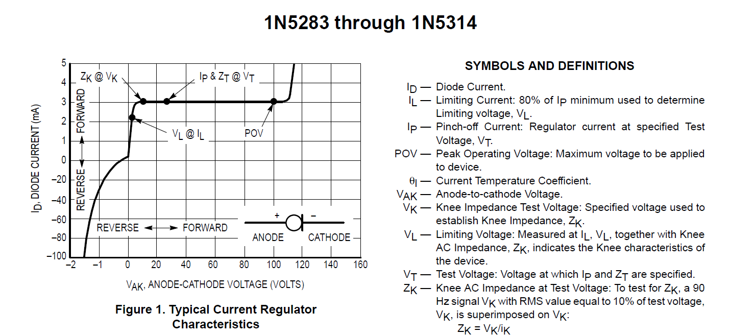

Plumber, the diode stripe (cathode) has to be more negative than the anode. Whether it "points to the power supply" or not depends on where the load (in your case, the electrolysis cell) is in the series circuit. The load can actually be connected to the anode or the cathode, as long as you get the polarities of the power supply, the CLD, and the electrolysis cell correct.
And why would a seemingly reputable source emphatically state that the diode stripe should face the power supply? Misdirection perhaps?
You should always check the datasheet for the device you will be using. People do make mistakes. Sometimes different manufacturers do things differently too.
Here is a excerpt from a Motorola **broken link removed**. In their documentation, the current is regulated in the forward direction. ie: the band away from the + of the power supply. There is no current limiting in the reverse direction and destructive currents can flow:

Do you mean a current limiting diode, in series with the pot, the power supply, and the electrolysis cell? If it is a CLD, rated at less than 3mA, then it is either damaged or wired incorrectly.

Yes, I would expect a 10kOhm pot to allow twice as much current as your "ideal current controlled" 1.5 mA target, per Ohm's law (E=IxR), that is being that the device is obviously shorted and not working. If the device wasn't there, a 10 kOhm load will draw 3.5 mA, which is what you saw. So, your CLD is most positvely nothing more than a conductor at this point and should be replaced.
Get your new CLD and a 25 kOhm pot, when you revieve it go ahead and wire up this same test rig, with the diode forward biased as you understand now, and verify under controlled conditions how the CLD works, for your own peace of mind. Then, set up your test and plug away at your experiments. Good luck.
