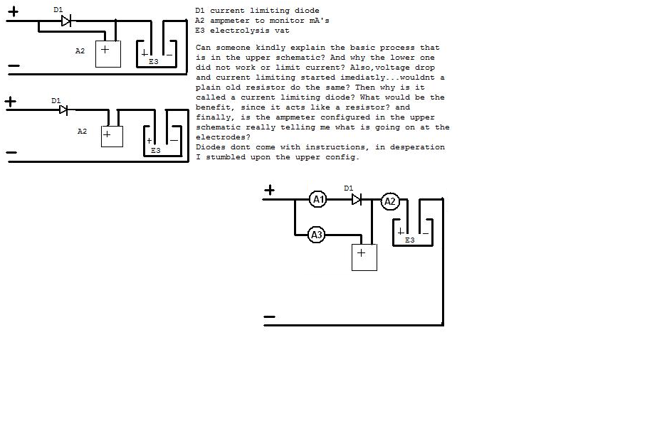

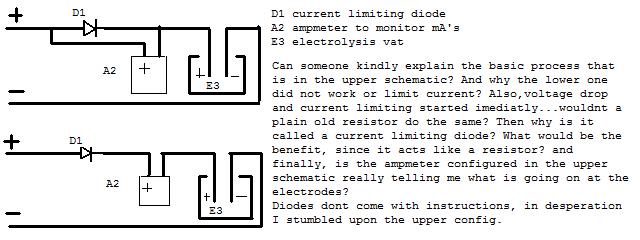

can someone kindly explain what I have done and why it works? I am trying to learn. current control.jpg
this diodes may be for polarity protection, not for curent limiting, since diods never used for current limiting in forword biase. it just will show a forword drop only.
also connecting ammeter as in fig 1 is totaly wrong, normally it has to be connected in series with the equipment. also across a diode???? simply you are by passing the diode by connecting so.
What is the part number of the diode you are using?
What is the current rating of the diode?
What is the range of the meter?
What current do you require?
The diodes I have seen have a current limit of only a few mA, I suspect that you may need a bit more for electroysis.
The current meter in parallel with the diode is completely wrong, the second circuit where things are in series makes more sense.
But what current are you expecting? and yes a resistor would probably be easier to use.

what i beleive is your ammeter by passes the diode and its showing the current through the electrolysis, whats the type of your electrolysis? just remove the diode and connect it, if you will get the same reading then diode is nothing doing with it. i
n your second schematic diode may not getting enough forword voltage to conduct thus no reading on the meter. just varify it.
Thank you mbarazeen. If I read you correctly, you described what it is supposed to do. This is wonderful news if I am understanding you correctly. I am in fact monitoring the current across the electrodes. It is the configuration or wiring I dont understand. And why The diode works in this configuration. I wired it this way trying to figure out why the diode wouldnt limit current...while I monitered the effects on the current across the electrodes. No one else seems to think it possible, or they cannot explain why it is in fact limiting the current wired this way. The lower schematic config simply didnt work. But I dont know why the other config does work.
you are working on very low current, 1. mA even less at the begining. if you select a propper diode for your second schematic it may work, current limiting by a transistor circuit is very easy to assemble, if out of home until saturday and i can help you after that, or any one can post to you the dagram, the basic of a transistor is to set a certain current (limit it) proposanal to base current, you can have a variable control upto 1mA as you needed.

The simplest explanation that comes to mind is that you are using a multimeter in voltmeter mode instead of ammeter mode. That would explain why the top circuit works and the bottom one doesn't.

You have drawn us a picture of two circuits, where you claim the first one is working and the second one is not. The first one had the meter parallel to the diode and the second one in series with it.
Both configurations will read current as long as there is no failed or improperly biased component creating infinite resistance, as long as the meter is on the proper range, the fuse is not blown, all function switches on the meter are properly set, and the leads are connected to appropriate terminals.
However, the parallel configuration, which you say is working, will bypass the diode. There will be no current limiting. You might as well remove the diode from the circuit and make it a Christmas ornament.
The SECOND configuration, as long as YOU are doing everything correctly with your meter and components, all setting correct and components properly biased, assuming the components are suitable and properly functioning, and furthermore assuming this circuit is a proven design, SHOULD WORK.
If it isn't working as you expect, those of us on this end HAVE to assume either you are doing something wrong, your equipment is faulty, or the design is bogus. Exploring any of these possibilities is not an insult.
After all, you came to this site asking questions and as far as I can see some knowledgeable people have done their best to help you. My suggestion is that you take a deep breath and explore the possibility that you are doing something wrong per our suggestions.
After all, if you are claiming the first drawing is "working" but do not realize that it CAN'T be working per the design of the circuit (ie no current limiting from a bypassed diode), then we MUST explore any and all possibilities.

First, conceding that I am no expert with electrolysis, it MUST be concluded that the conductivity of the electrolyte solution along with your battery voltage and the resistance of your conductor are the ONLY FACTORS limiting the current in your experiment (in the parallel meter configuration) according to Ohm's law. This is pure Physics 101 and unless you are the discoverer of a new Earth shattering phenomen this conclusion is all that is left.
What you have is two parallel conductors. IF ANYTHING is certain, your actual current is MORE than your measured current, because the forward biased diode (probably) offers only a little more resistance than the meter and leads, and the overall current will be the sum of the two branches according to Kirchoff's current law. It is entirely conceivable that you have as much as 2 mA of current passing through the circuit but will never know it because to detect it would require two ammeters.
This doesn't seem likely, however, because you say the series configuration isn't working. I would be interested to know how you define not working. In other words, is there NO measured current, or is the current more simply LESS than you expected it to be? If there is no measured current, the only reasonable conclusion is that the battery voltage along with the conductivity of the electrolyte is not enough to properly forward bias the diode and get it to conduct. If there is a current but not what you expect, the only reasonable conclusion is that the overall conductivity of your circuit and the voltage supply is not permitting the current you desire, in part because of the current limiting of the diode.
Are you an actual plumber? OK then you should be familiar with pressure regulators. Think of them for a moment. A 10 lb pressure regulator cannot regulate 5 lbs of water pressure. The supply pressure has to be more than the desired output. You need headroom. This may be the case, in terms of current, with your experiment. By pure coincidence, the electrolyte solution may offer just enough conductivity to permit 1 mA of current with no diode in place (bypassed), but with the diode in place, you simply do not have enough current for it to perform as you desire.
At any rate, without knowing the EXACT performance specifications and conditions of every component in the circuit, there is no way to give you the exact answer you are looking for, only guesses and speculation. But one thing is for certain, your "working" set-up is not working.
can someone kindly explain what I have done and why it works? I am trying to learn.View attachment 35046
Your diode, a CLD or CRD as I learned them many years ago, will pass 1 ma regardless of applied voltage. Look at my drawing and A1 will be 1ma, A2 will be your electrolysis current, and A3 will be the same as A2 minus 1 ma. In your lower drawing, your current is limited to 1 ma by the diode. It may be the diode keeps the emulsion ready to work when the voltage is raised, don't know why it's there, but that's how the diode works. I think CLDs are so cool, if in series with a capacitor, the voltage will rise in a straight line instead of the usual 5 TC curve.
