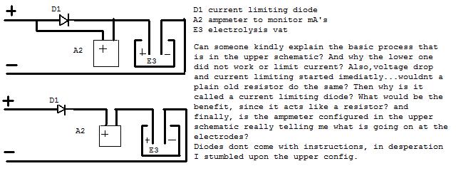

Your diode, a CLD or CRD as I learned them many years ago, will pass 1 ma regardless of applied voltage. Look at my drawing and A1 will be 1ma, A2 will be your electrolysis current, and A3 will be the same as A2 minus 1 ma.
Not true. Current limiting diodes will pass zero current when they have zero volts across them, such as when they are shorted out by an ammeter. To do otherwise would require an internal power source. Also, see Fig. 2 in this document.

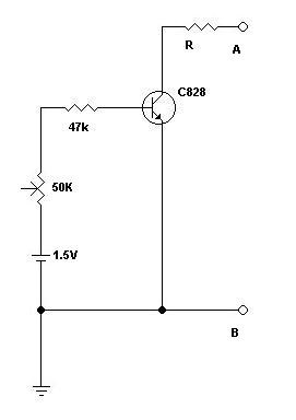

I have attached a simple circuit for current limiting, just use a transistor a 1.5 voltage cell and few resistors, connect the terminals A & B on the attached diagram instead of the diode and connect your meter in series.
you have to decide the value of R as per your voltage of application, i hope a 1- 10K may be ok, then connect your source only in series with meter and adjust teh value of preset until you get 1mA. then conect your system in series.
you can observe the current will increase as you said then wil not go beyound 1mA as the base current is set only by preset and the cell.
you may need some improvement or change in value of resistors if you use different transsistor etc.

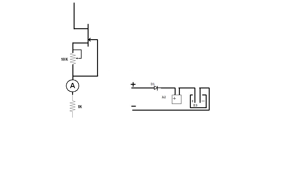

Try building this and then apply power and adjust to get the 1.5 ma current. Then to test it, short out the 1K resistor, the current should stay the same.

can someone kindly explain what I have done and why it works? I am trying to learn.View attachment 35046

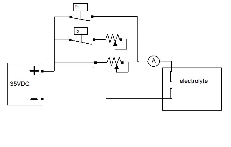

OK, here is a quick draw-up, hope it is easy to follow.
I actually added a second mechanical timer (cheap, can be picked up at hardware store or Walmart possibly for around $10 or so.)
T1 would be the time you want your circuit to have no resistance, the build up time to 1 to 1.5 mA
T2 would be an intermediate timed switch, longer than T1 but shorter than the time of the final process...and includes a series resistance (fixed or a potentiometer). At this point in the sequence, the T2 branch of the circuit will be parallel to the other potentiometer (or fixed resistance). The total resistance will be less than the least of the two. If they are both the same value, say 20kOhm, then the resistance at this point will be 10kOhm.
After T2 opens, you are left with your last potentiometer, in our example we said it was 20k, so we'll go with that.
So you go this sequence...Short, T1 opens (10kOhm circuit), T2 opens (20kOhm circuit)...and 20kOhm for the final duration.
The potentiometer values will be determined to suit your time needs, as will the duration that T1 and T2 are set for.
The three branch idea permits three steps of controlled circuit resistance, and the final resistance will not permit the test to exceed your upper limit. Most likely the final resistance will be near 24kOhm to comply with Ohm's law.
This circuit is "semi-automatic", meaning it isn't a "smart" circuit, as the time and resistance values will take a few tries to get right. It won't be on complete autopilot, but once you have the volume of electrolyte, the battery voltage, and starting electrolyte condition figured out, the process should be repeatable so that you don't neccessarily NEED precise feedback type control.

Well here is what you need to understand.
After the electrolyte gets to 1.5 mA, there HAS to be circuit resistance in order for the process to hold. This is what ANY current limiting device will be doing, it will be creating a resistance to compensate for the increased conductivity. (EDIT: I'm not sure about a CLD, but most feedback type of current limiting will be feedback oriented, meaning as the conductivity goes up, so will the circuit resistance to compensate, in an analog fashion. So, even with your ideal circuit, time will be a factor as the resistance in the circuit builds.)
My offering will permit you to get to your goal in stages. The initial, resistanceLESS circuit, due to T1 being a short circuit, will allow a QUICK surge to 1 mA (or 1.5 if it pleases you). Then, a step change will occur and add a series resistance. It will bump your current back down, but it doesn't have to be much. It will climb once again, and T2 will cause the resistance to increase a second time, eventually settling on the exact resistance required for 1 mA (or 1.5 if that is acceptable). This ultimate resistance is around 24kOhm, and no matter what kind of circuit you settle on building, that resistance will be there. Current limiting is done with resistance, or shunting, or a combination of both.
Doing it in three stages permits you to control how long it takes. It sounds like your goal is to avoid the drawn out process of having a fixed resistance for the duration, which I understand would cause it to take a very long time. With the first stage, up to that 1 mA goal, being a short, the resistance problem will not be an issue.
Think of this as like a 3 speed transmission, first gear gets you to speed A very quickly. You shift gears, 2nd gear gets you to the next level, shift again and settle out at your cruising speed.
See?

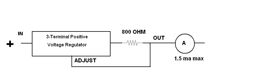

Here's another current regulator that works very well
