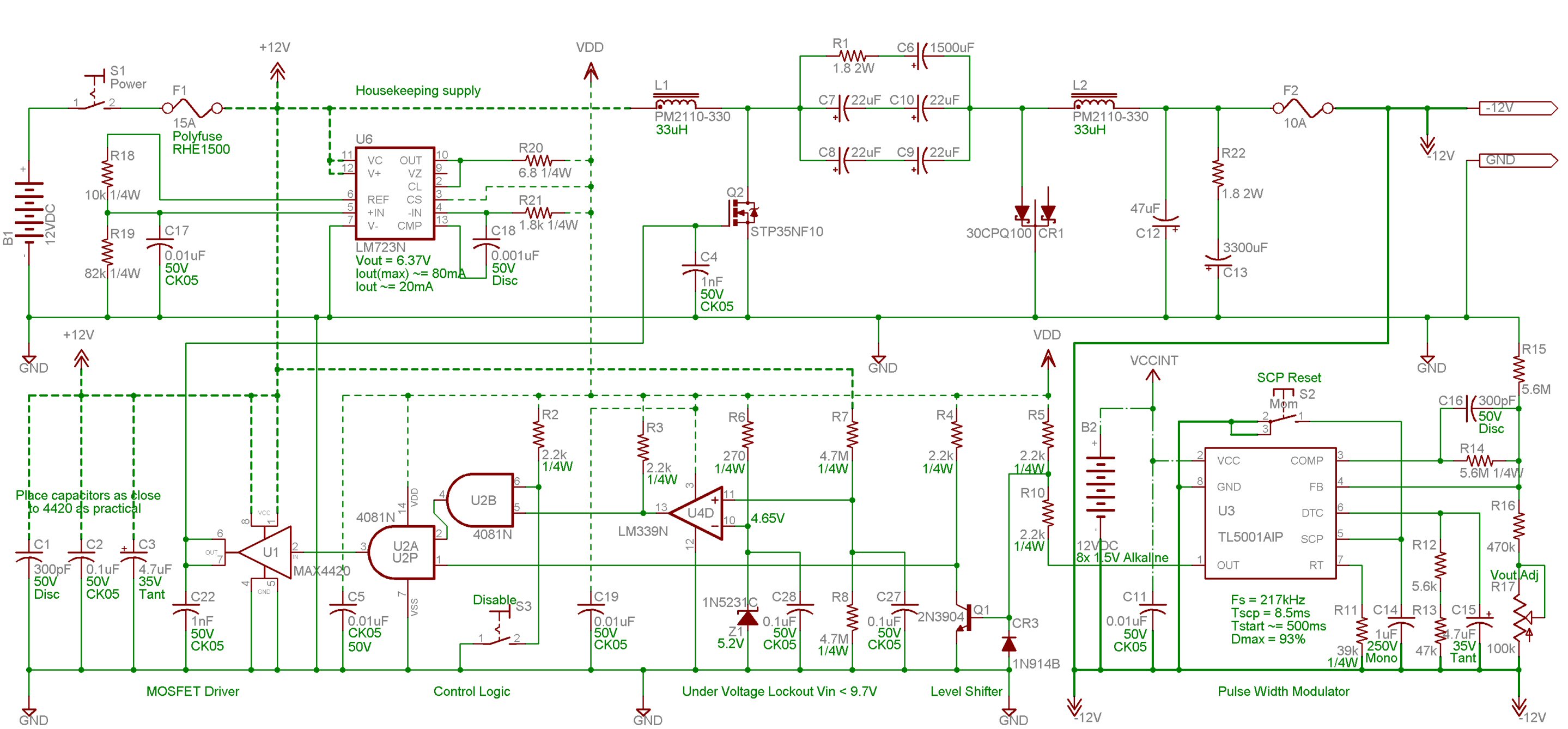

Very interesting project ya got going there. I've been trying to build power supplies myself (some work... and some don't) and find this project rather interesting for its unique requirements.
Correct me if i'm wrong but this what i believe you want:
1. low noise/ripple
2. small size/weight
3. high reliability
4. high efficiency
5. wide input range (3v-14v)
6. excellent load regulation
... good thing you didn't add CHEAP or you'd have defined the impossible. :)

Well, I ain't lookin to lug a 5kg box around- but keep in mind that I use car batteries. If it weighs less than that by a fair bit, I'm happy. Certainly, it will be smaller and more portable than a generator.
Glyph said:
3. high reliability
That's more a matter of the design than anything that costs a lot. Just taking the time to put the right kind of controller and good safety options, and make sure I understand how they work. More on that in a bit.
Glyph said:
4. high efficiency
This is probably the most important requirement, other than being quiet.
No, nowhere near. More like 8-14V, and I'm actually settling for 9.7V minimum. I intend to set the trip point at 11.2V, because below that you are damaging the battery; I'll have an override for it for those situations where it's important.
Well, now, I'm interested in being able to plug 15A into it and have it not sag below 12V. The initial output is looking like about 13.9V, and I'm at 12.51V at 4.9A. That's about as high as I can take the current right now; I'm working out an efficiency problem I'll get into later.
What's cheap mean? How's $100US grab you? It's running (though as I say, I'm working bugs out of it), and I haven't spent that yet (at least not on parts for the supply- I had a couple other projects hanging around).

Where things are at:
I have built the supply, and I went with the boostbuck rather than the Cuk. The main motivation was the feedback network; the design is easier with a positive rail rather than a negative one. Thinking back, that might have been a mistake; I might be able to see now how to get at it. But in any case, that's what I did. Luckily, I can undo it if I have to.
I ran into a problem: the tantalum cap I used for my energy transfer cap's leads started heating up! Surprised heck out of me, I jumped back after hitting the panic button expecting the usual red flames of a burning cap. After it had cooled off, I pulled it, and all of the problem was at the bottom- not up top, like it is if the cap itself starts to fail. I thought about it, and realized that it had been exposed to too much current- not exactly what you expect with a cap. I thought it over, and wound up with two series pairs in parallel- it's the same value, but twice the current handling capability. I'll address it more if it becomes a problem, but for now it looks like this solution was successful.
During the breadboarding, I realized that when the controller shut down due to current limit, it turned the switch in the boost converter off- but because I am using a ground-referenced drive and a P-channel MOSFET, it left the switch in the buck converter turned on, and this provided a direct low-resistance path to the load. Obviously, this is unacceptable from a safety standpoint, and in the event of a real short, the buck switch would be destroyed. I therefore added a second driver, so that I could detect current limit (luckily the current limit builds a voltage across an external cap, so I can detect that with a comparator and use the signal to control things) and now the system shuts down both switches, so the load sees zero current and zero voltage.
While I was at it, I added a reset switch (if you drain the limit voltage from the cap, it restarts), and a disable switch (just an AND gate that either permits or does not permit the signal from the controller output to reach the switches). I also added a comparator to watch the input voltage, and a housekeeping supply for all of the logic and the controller (it's a 723, so it browns out about 3V above the needed voltage- thus, the comparator shuts the system down when the input voltage gets to 3V above the brownout voltage- which is 9.7V). I initially had bad load regulation, but when I added the 723, it improved miraculously. I think the TL5001 likes a nice steady working environment.
The ripple is extremely low. I am running at 216kHz with a (now four) 22uF tantalum as the energy transfer cap, and I started with a 47uF tantalum as the filter- but went with a 100uF redcap instead. It improved the ripple spec and cut some of the switching noise out. The supply puts out 4.9A at 12.51V, so far with no problem except this:
Efficiency. I expected better than 85% in my initial design, and I'm only getting about 60%. That means that I'm drawing 100W, but only getting 60- the other 40 get dissipated in the supply, and that's kind of limiting me just at the moment. I'm looking the transistors over, because they seem to be the main culprits, according to my fingers (Ow! Yep, that one's hot). Not only is it creating problems that are limiting the load, but it's a waste of battery power.
The only other complaint I have is a certain amount of transient noise from the switches. I'm looking into some beeper caps for it now. We'll see what comes out the other end.

OK, as it turns out the efficiency of the boostbuck converter is limited by the presence of the P-channel MOSFET in the power rail. The problem is that the design formula I am using yields a higher voltage in the boost section than in the buck section; this voltage must perforce be dropped across that MOSFET, and it therefore dissipates power in relation to the current drawn. The tradeoffs for lowering this voltage are more noise and less load regulation, which are also unacceptable. So the boostbuck design does not meet my criteria.
At low current levels, very little power is lost, so the efficiency at 1.2A is about 85%; I suspect it could be driven even higher with careful design, and lower current requirements. But at 5A (actually 4.8A), about 100W is drawn from the source, but only about 60W makes it to the load, for efficiency of only 60%. Almost all of the 40W dissipated is lost in the P-channel MOSFET. It's not a problem for the MOSFET (if it is properly heatsinked), but it is a major problem from an efficiency standpoint.
This is unacceptable in my application.
It also makes the use of this design for an offline converter questionable, since it is not more efficient at high amperage than a linear supply. It does, however, remain quieter, so that might be an advantage.
However, this problem should not exist in the true Cuk converter. The Cuk converter has both coils and the energy transfer cap in the high rail, and the diode and MOSFET go to the low rail. So the current should not be directly dissipated by the transistor (or the diode, for that matter). What is not clear is what the average voltage across the energy transfer caps will be, nor whether that voltage will vary with the current drawn. If the voltage is not high, then the caps will not have to dissipate much heat; but if it is too high, I may wind up with that SEPIC design after all.
I have a pretty good idea of the regulator and driver components, and of the correct values for the Cuk converter design; I'll post the schematic for comment now. I'm breadboarding it over the next few days to see what it does.
Two caveats: I have seen trouble that might be due to an oscillation path introduced by the undervoltage lockout comparator's input coming from the input voltage (and therefore perhaps being amplified by the MOSFET, forming a feedback loop that destroys the MOSFET and potentially the driver chip). I am not sure, and I have not yet hooked it back up to see, since I really don't want to destabilize my breadboarding. You will note the decoupling caps on both inputs to the comparator; they're "just in case," and I have no proof that they will work. So watch out if you breadboard this. Second, I have not completed breadboarding and test, so this is not a confirmed design yet, nor is it fully back-annotated. If you build it, you do so at your own risk.
One last note for any newbies out there who might be thinking about messing with switchers: watch out. Switching power supply breadboards have a nasty habit of blowing up various creative ways, and I have had one tantalum cap burn and one aluminum electrolytic canister blow (and I do mean blow, it was pretty impressive) just during the breadboard phase on this project. These are not toys; they are serious stuff, and there are high voltages and large amperages floating around in them. If you aren't fairly well trained, you are taking your health or your life in your hands messing with them. Always, always, safety first. Personally, I wear shooting goggles and a heavy sweatshirt when I mess with them, and I protect my hands when I first power up a new breadboard. I also keep an extinguisher handy. Should I screw up and have something blow or burn, I don't wanna get hurt, and you should take precautions to make sure you don't either.
Here is the schematic.
