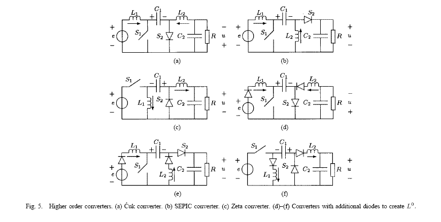

You need a sepic design. This is similar to a cap coupled cuk. You don't say how much current. Linear has some chips that will do this.
Too noisy. I need quiet power, as I said, so that it doesn't interfere with my CCD imaging equipment, and I don't want to be permuting the design putting huge, expensive caps into it to try to quiet it down. After that, not only would it be huge and heavy, but it also would be much more expensive than the already essentially built Cuk converter. As I said, it's all hooked up; all I need is a PWM controller appropriate for its control function.

Sorry, missed the 10A. Linear's chips dont go that high. The UC3842 should do. Has a driver and cutoff if Vs <10V or>16V.
The UC3843 might be a bit more appropriate; my input will be a lead-acid 13.6V battery, and my desired output 12VDC, so the >16V lockout would be a problem. I will of course have to jimmy it to get voltage-mode control rather than current-mode; current-mode control is undesirable (and unnecessary) in a Cuk converter.
Thank you!
Quick question, did you show that picture because all six converters have the same control function? Or if not, can you tell me how the control functions are related to one another?
TIA!
