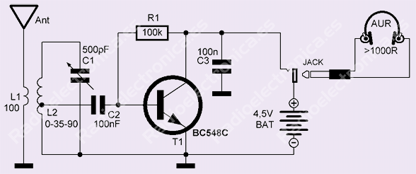

Biasing is simple. Before I used a 2N3904 that has a fairly low hFE so it was close to cutoff. Now I am using a BC547C that has a high hFE and it is close to saturation.
You want the collector voltage to be about half the supply voltage so it can swing the most up and down, then with the 4.5V battery the collector is 2.25V and the collector current is 2.25V/1k ohms= 2.25mA.
The datasheet of the BC548C shows that its hFE is typically 520 at 2mA so the base current will be 2.25mA/520= 4.3uA. The base voltage is shown on a graph as 0.65V so the base current is (2.25V- 0.65V)/100k= 16uA which is too high. The transistor is biased almost at saturation.
Confirming too much bias we assume that the collector voltage is 1.3V. Then the collector current is 3.2mA. The base current is (1.3V - 0.67V)/100k= 6.3uA, and it will cause a collector current of 6.3uA x 520= 3.2mA.
Then since the transistor is biased near saturation it rectifies the RF like an amplified diode. The hFE of a BC548C has a wide range from 420 to 800 at about 2mA of collector current. Ones with an hFE of 800 will be even closer to saturation.
If the supply voltage is reduced as the battery voltage runs down, then the transistor will become linear and not rectify the RF so there will be no audio. Then when the supply voltage drops to near 1.5V the transistor will become cutoff and again it will rectify the RF. Here is a BC547C in this circuit showing saturation with a 4.5V battery:
Would it be better to work near saturation or cut-off?
With JFET I bias near cut-off, and it works fine.
I think that was the case with most valve radios which didn't use demodulator diode (except those using grid-leak approach, which are near saturation, that is not possible with transistors, unless adding a diode gate to ground).

"the diode passes current for 1/2 of the cycle of the RF carrier wave, and if there's a low impedance like a capacitor to filter out the RF) on the other side of it does indeed load down the circuit."
The RF (the 1MHz) signal never gets to the diode.
The high frequency is passed to the tuned circuit where just one frequency is constantly increasing in amplitude and it adds a microscopic increase across the tuned circuit each time it arrives. Over a period of time the voltage on the top of the tuned circuit is 350mV and when it gets to 351 mV, the diode passes this 1mV to the load. The voltage keeps increasing and the voltage above 350mV is the voltage that will appear across the headphone (earpiece). Once it reaches a maximum, it starts to gradually decrease. The waveform it produces is the audio being transmitted by the radio station.
The diode does not have to be high-speed but it must be able to following a waveform that may be as high a 10kHz. This is about the highest frequency you will hear on an AM radio.
The diode is merely passing the voltage on the top of the tuned circuit and the only time when "speed" comes into it, is when the signal is changing from a HIGH to a LOW. The diode must be able to turn off quickly enough so the decreasing signal does not taken any current from the load side of the diode. You do not need a capacitor across the load but if one is present (such as a crystal earpiece - 22n) you need a resistor across the capacitor to discharge it.
Now, when it comes to the argument that the antenna poses a load on the tuned circuit, we find the antenna is the "delivery vehicle" and it never poses a load.
When the signal from the antenna increases the voltage on the tuned circuit it produces EXPANDING FLUX and when the 1MHz signal goes from a HIGH to a LOW, the flux collapses slightly but the value of inductance of the coil and the value of the 415pF capacitor contain so much energy that the drop in voltage is microscopically small before the next cycle of the 1MHz signal appears. That is why each cycle of the incoming signal increases the voltage on the tuned circuit to a point where it is sufficient to drive a headphone.
Thus it is not important where the antenna is connected, although many crystal sets have antenna tapping points. A change in antenna connection will alter the overall value of the tuned circuit but not actually put a load on it.
