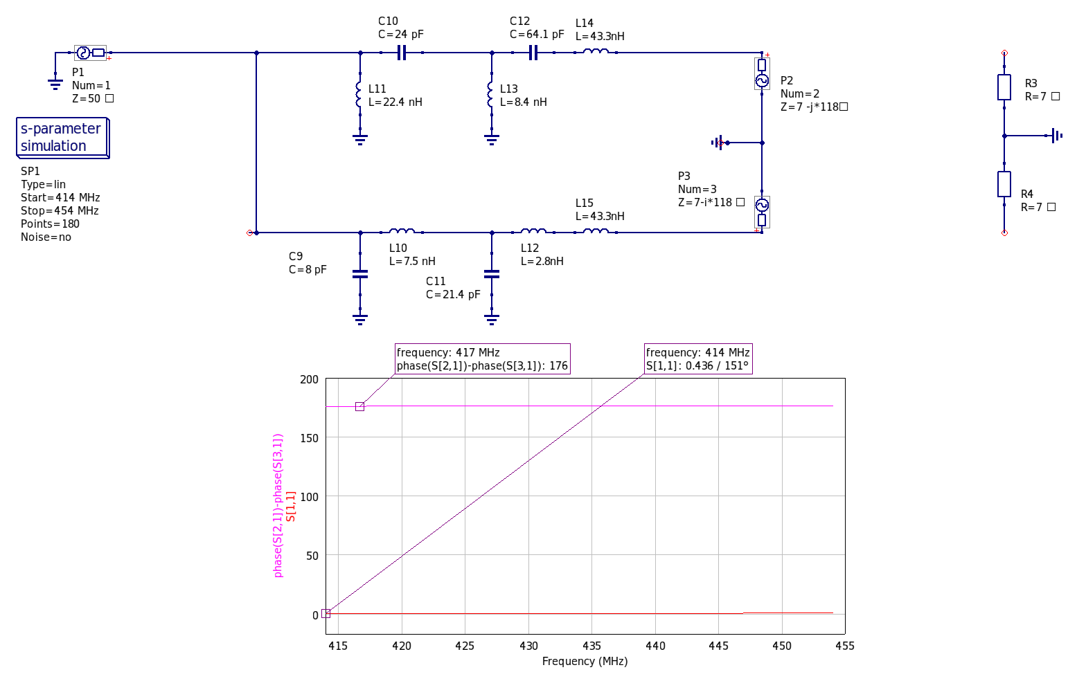

This is the technique applied so as to obtain a wideband matching + balun for a bowtie antenna.
I have run a simulation:
The two 43.3 nH inductors are there to cancel each -j*118 antenna arm reactance. Does it make sense ?
I have remeasured the antenna + caps / inductors populated with my nanoVNA and have found R - j*20 ohm. R was in the 10 - 20 ohm range, can't remember, anyway, less than 50. i have made approximations for all of the matching network's elements, i.e. precise values were used for only 8 pF, 24 pF and 7.5 nH. What should I do next to at least get that reactance closer to zero ? The antenna is very deaf currently.
Thank you

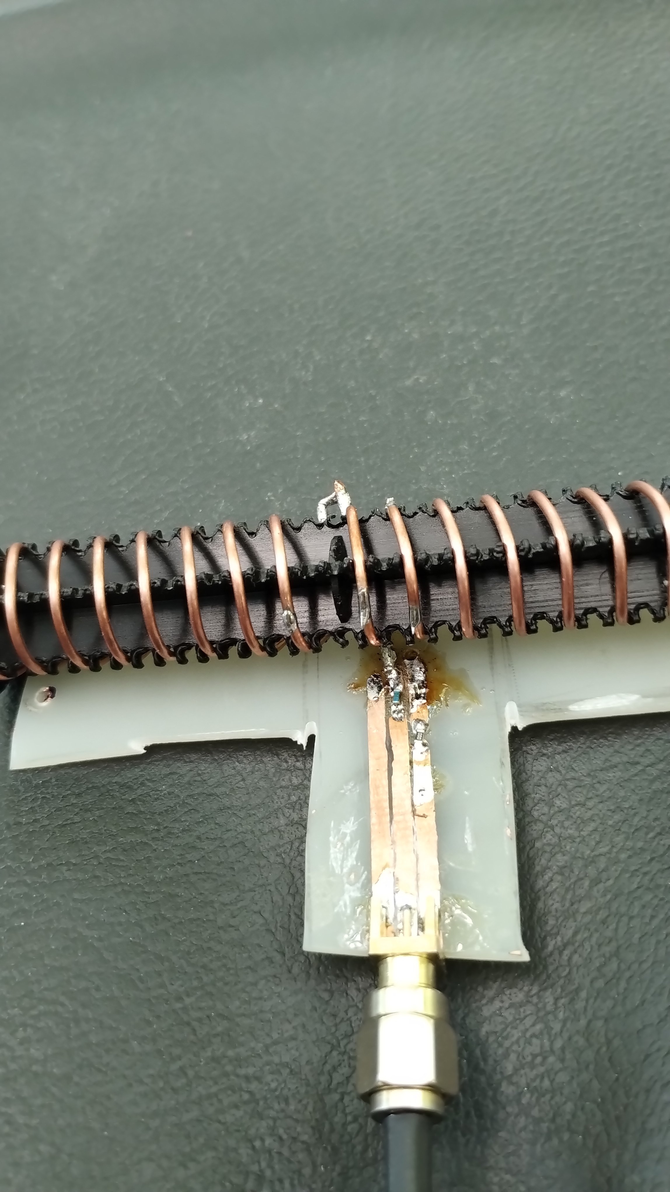

You would not happen to know how to do something similar for the NMHA, would you?
Trying to do the displaced feed - fig 4.1.b at page 19 from https://cdn.intechopen.com/pdfs/144..._antenna_for_metal_proximity_applications.pdf
I have put the sleeve balun over my coax, but what to do with the coax shield near the feedpoint - leave it unconnected, or ?

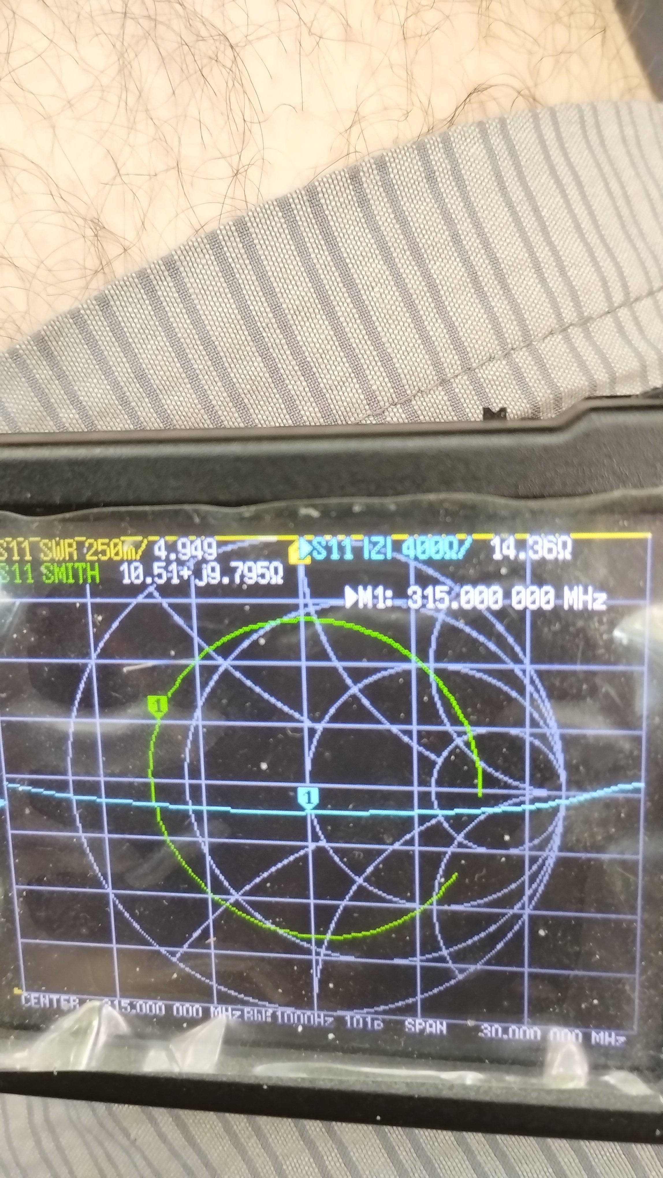

Tried it on a NMHA, at first I thought I was going somewhere and then...
The NMHA resonates with around 7 ohm of resistance, fed as a dipole.

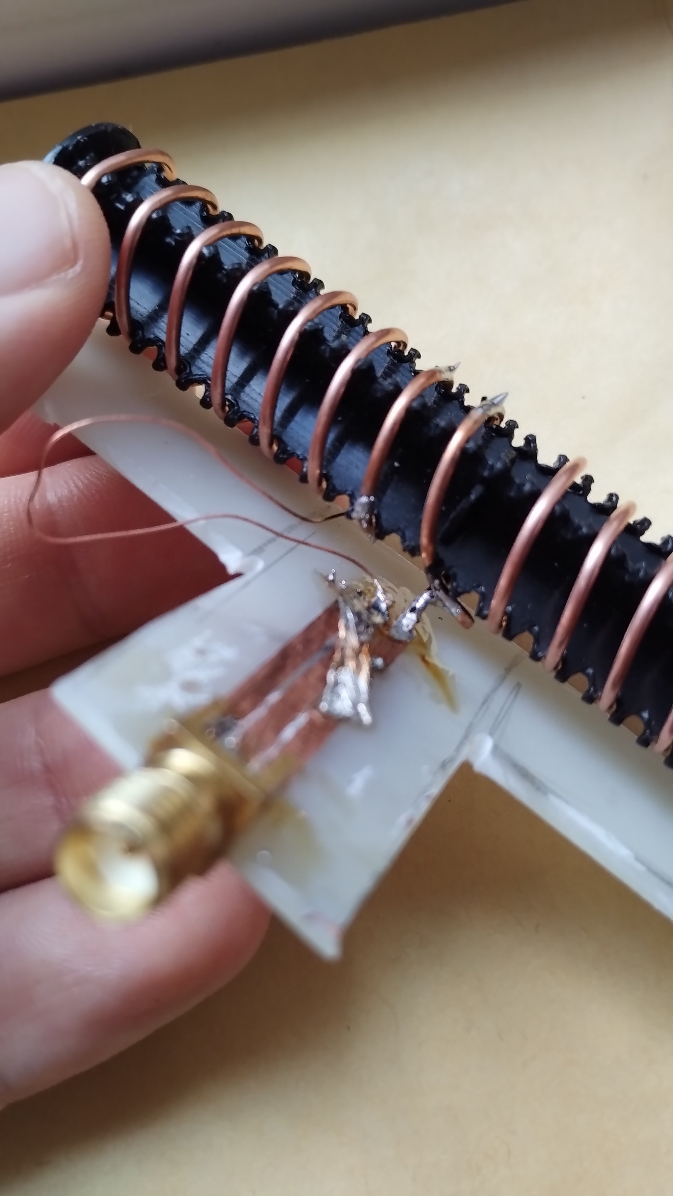

Then took out the leg connected to CPW's center line and soldered it onto the other leg, and both soldered to GND of the CPW. And then off to gamma matching:
I first tapped into a point of 700-800 ohm, then went towards the center and found a point of 17 ohm, then went further away and found 25 and then 31, then a tiny bit more further away from the center - 400 ohm!.
There is a lot of jitter at these impedances too, 100s of ohms to both resistance and reactance. That is partly due to my cheap nanoVNA but partly, I assume, due to the gamma loop. When going a few MHz higher - in the 10s of ohms realm - the jitter is also less, not 100s but 10s of ohms.
I guess this method is not suited for trial and error, or... ?
The braid is the same in every picture; its purpose being of equalizing potentials on the two CPW GND strips where two SMD parts would go - part of a lattice matching network that is not currently deployed. There is no GND plane / strip on the bottom side of PCB.
There are two 0603 zero ohm resistors: one of the GND strips has one, the other being on the central strip.
The nanoVNA got calibrated just before the SMA connector from the pictures and then used port extensions to bring Open Circuit at the two dipole feedpoint holes in the range of 5-10 kohm (both R and X)

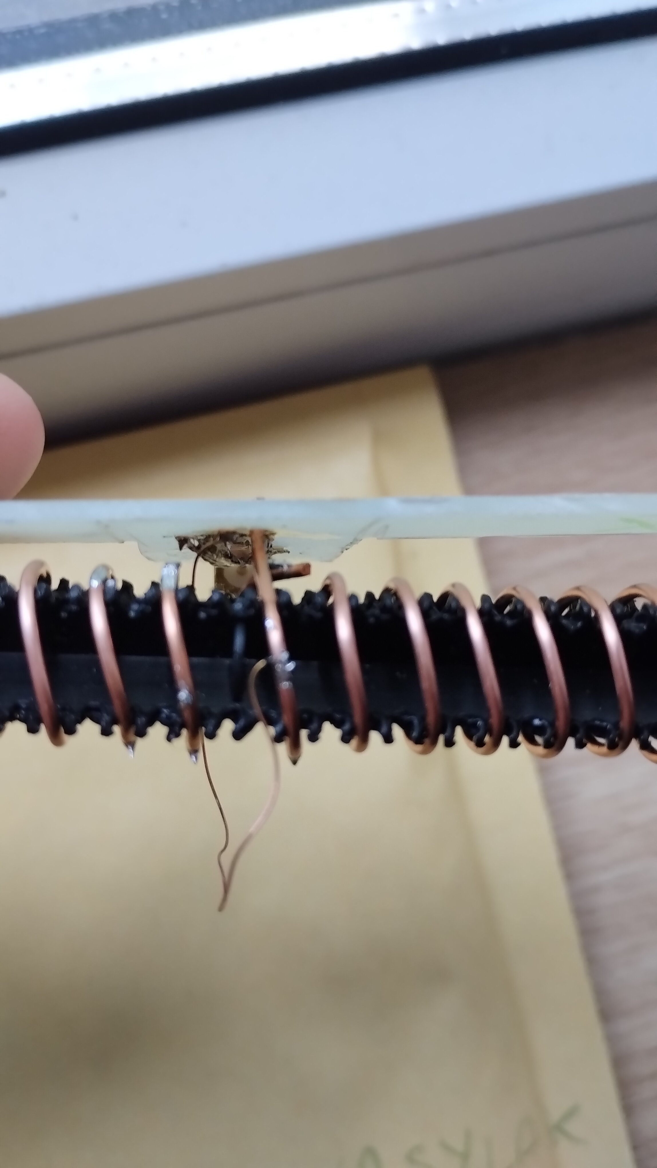

Update:

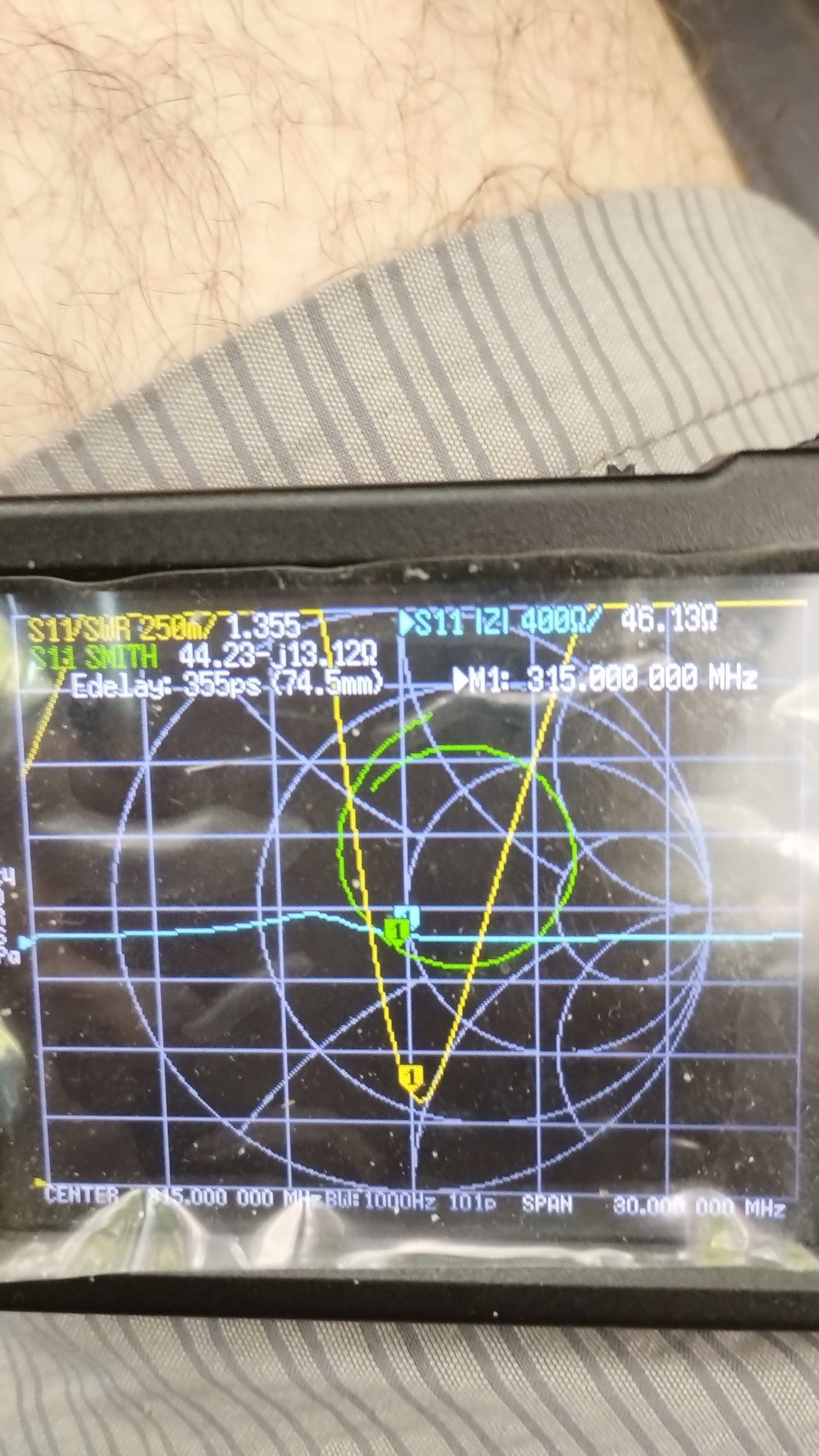

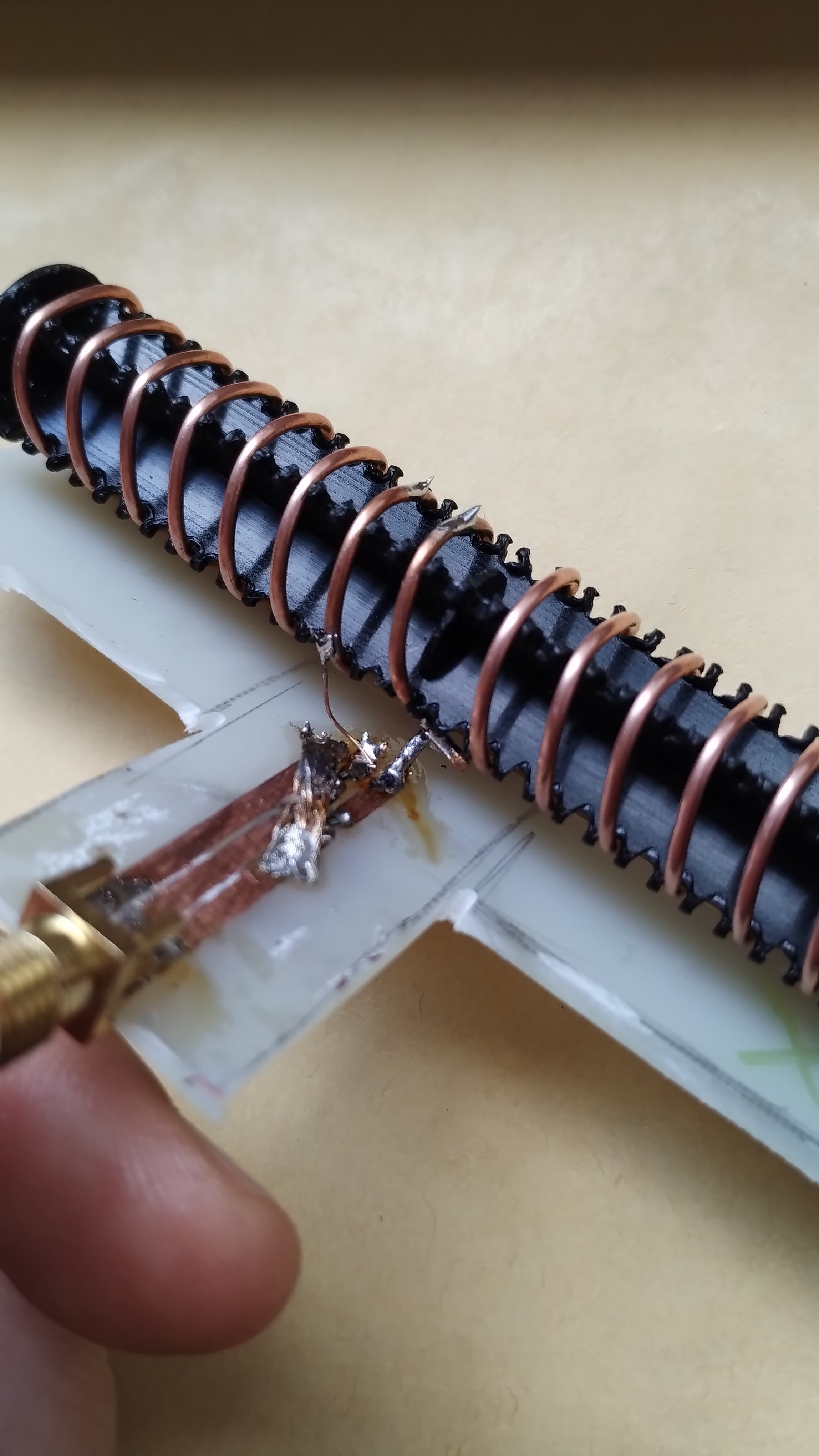

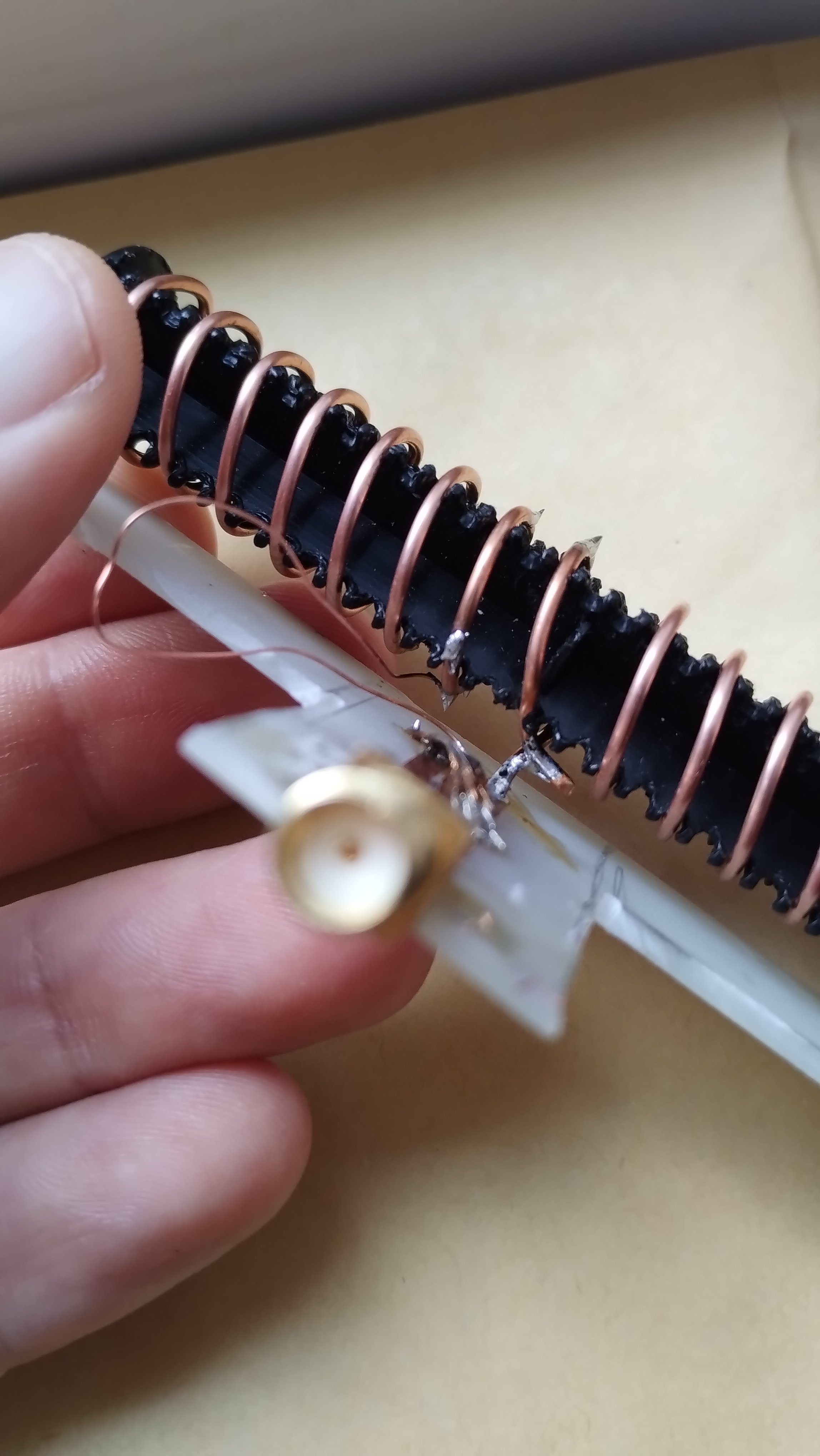

Ditched the gamma matching and opted for a displaced feedpoint matching, switched over to 315 MHz (where the helix happened to resonate) took away the braid (less than 5% impedance readings difference observed), replaced one zero ohm resistor with a 91 nH inductor:
I thought I had made a lucky hit, beautiful VSWR:
And then for the real test, I have replaced the VNA with my receiver device, kept all cables and antennae placements the same; my antenna is actually a bit worse than a cheap commercial 433 MHz antenna (used at 315 MHz for this test) which has this VSWR:
For the test I have used the same transmitter running the same software and gradually departed from the receiver until it was unable to retrieve a valid signal.
The nanoVNA may be cheap, but can it be that bad ? I think not. There must be something about my method / setup...
