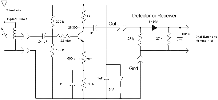

I also played a little bit. I built this simple rf amplifier
The sensibility has been improved a lot, but also the selectivity.
Anyway, I don't get the "regenerative" effect that its author claims.
AFAIK a regenerative receiver should boost selectivity big deal.
If I set the pot to low value, I get a lot more gain, but the selectivity degrades a little bit, not improve. Even if I get to the point where the noise gets annoying, and it seems that I approach oscillations. (it makes sense, as lowering the pot lowers the input impedance, doesn't it?)
If I set the pot to > 500 ohm, then the signal is nice and clear, but the volume drops a lot, to be just a little bit over the diode on itself.
The best selectivity improvement I got by tapping the amplifier to a low impedance coil tap.
