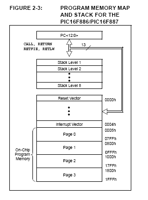

I'm doing table patterns in my LED matrix. I placed delay routines bottom of my code.When my program gets bigger above 2K limit the code gets stuck.
MPLAB also generates a warning message "Crossing Page Boundary". For the entire program I'm calling Delay routine over 200 times. I noticed when my delay routine address goes above 2K limit this happens.
Is there anyway to call delay without problem?
You can use a vector table at the beginning of your code.
So for your delay in bank 2 do the following in bank 0.
delay
         movlw  high(delay1)
         movwf  PCLATH
         movlw  low(delay1)
         movwf  PCL
and rename your delay code to delay1.
If you move a few larger routines into bank 1 then you will free up bank 0 memory.
Long time since I did this so let me know if there are any problems.
Edit, you also need to add clrf PCLATH before the return in delay1.

Be careful calling subroutines from subroutines. When you are in bank 1 and you call a routine in bank 0 then it will stay in bank 1 and crash.
For simplicity, move routines that don't call other routines.
OR, move groups of routines. For example, LCD routines can all be moved into bank 1 and only the init and write char have to be called from bank 0.

If you are adding more patterns, you could put them all in upper memory and keep your Delay routine on bank 0.
Hi all
I just checked my ISR routine, It is too big (exceeding 1st page boundary 0FFh) so I cannot put those vectors in the first page 0h-FFh.My main loop starts from page 2 that is between 0x100 - 0x200 location. I tried all the methods but only below code works. My patterns are not subroutines, just flow code. Subroutines are Delay_1S & Col_Rotate_CW.So many are there.
The problem is for previous & future patterns one by one I have to add [bsf PCLATH,3] & [clear] it. Is there any shorter way of doing that?

I think its better to move ISR routine to the last page of PIC16F886 that is closer to the address of 7k-8K...!!!! & place subroutine vectors in the first page block ?
Oops sorry I don't have larger tables. I only have soo many patterns that they cannot show by a table . When my program gets bigger the subroutines are going beyond 2K limit. Thats my problem.
I cannot place on top part of program memory because I have a larger ISR as well.
It's really best to keep ISR's as short as possible, and you use long calls (either manually, or use the macro) to access subroutines in higher memory.
Seems as your code develops you are going to run into more and more page boundary and ram bank problems.
Without having a full overview of your project i/o needs, would suggest you use a Pic18F2520 , or 4520 / 2620 /4620 and similar chips, all normally easy and lo cost to buy.
That has 32kb of Program memory, without any page boundaries, just one contiguous array.
The Ram banks are similarly very easy to handle as each bank is 256 bytes, and with one bank select at the beginning of your code allows you to have 384 bytes available without changing banks, eg bank 0 access 128 + bank 1 256 = 384 bytes.
So much easier to code, plus it has extra helpful assembler instructions , and normally its very easy to recompile you 16F code.
Have to agree with the Nigel, if you have so much code in the ISR your program flow needs improving, eg , if you are testing interrupt conditions then rather than executing the resultant action set in the ISR, set a Flag for the main code to pick up.

Here how I'm going to do.
GOing to place all of my subroutines above 2K limit & call them by writing to PCLATH. Any comments.
