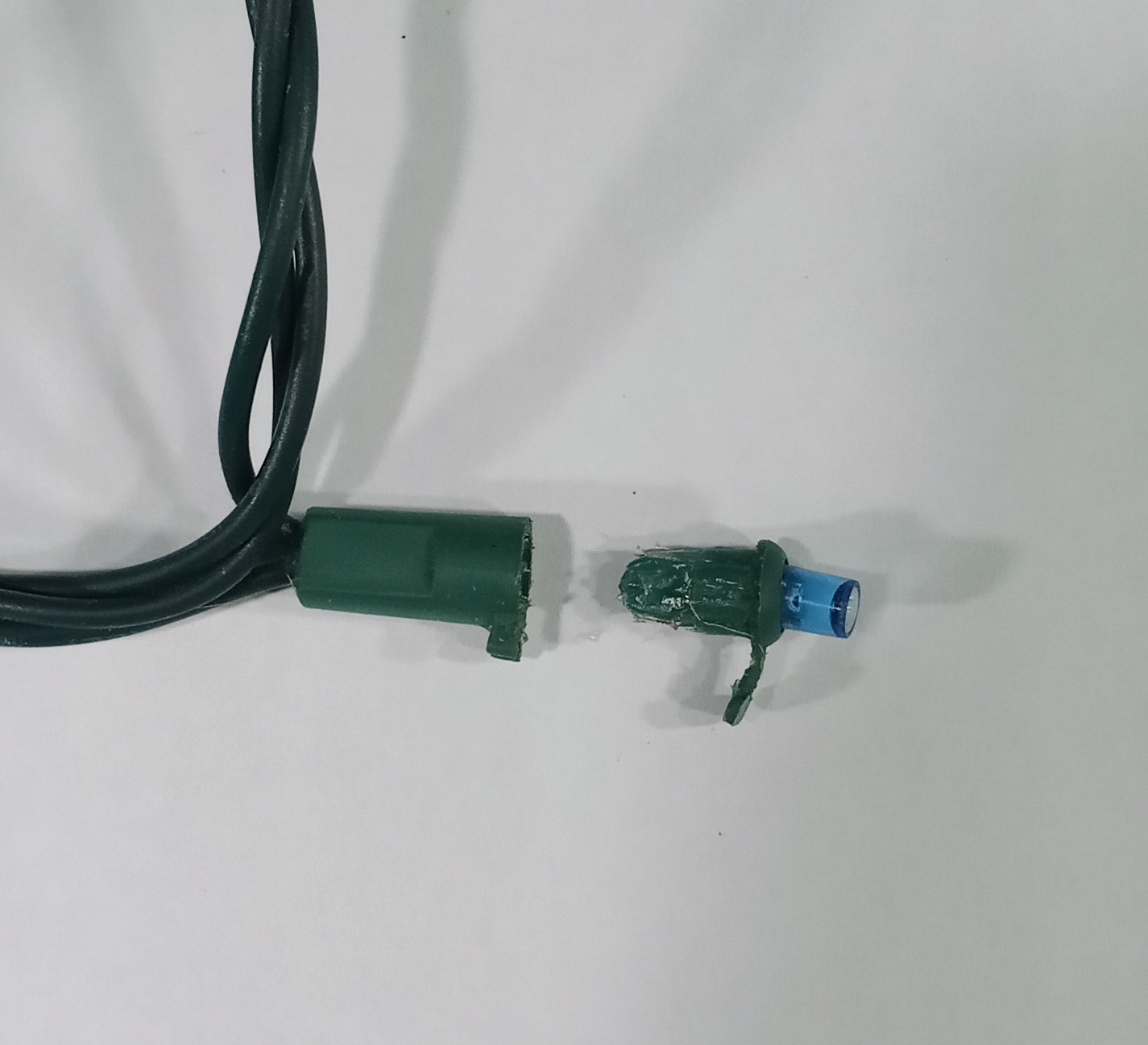

As in previous threads, my outdoor LED light strings mostly fail during the winter season. Only about 1/3 remain lit after about 4 months. Last year, I filled each socket with silicone paste to no avail.
I chose the socketed ones so that I can make them multi-colored.
I see no other option but to cut them apart and rewire each LED in parallel and use a low voltage DC power supply. Strings of 50 lites would be ideal for me.

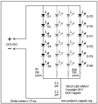

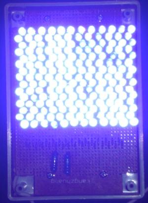

When I have made large arrays of LED (50 to 250) I first figured out what I can use as a power supply. Taking that into account (mainly voltage) I made several strings of series connected LEDs, with each string having a resitor. I left enough voltage across the resistor to make sure that variations in individual LED voltage drops had a small effect on the voltage across the resistor.

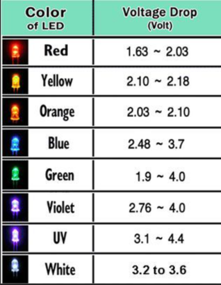

In addition to the color of an LED that sets its forward voltage is the range of the voltage with each color because the voltage cannot be made accurately.
Then you must have enough voltage across the current-limiting resistor so that the range of an LED's forward voltage does not cause the current in some of them to be too high and burn out the LED or cause the current to be too low and make dim light.
Here is one of hundreds of voltage graphs on the internet:
You can put LEDs in parallel if you buy hundreds of them then test and group them into groups with a similar forward voltage.
If you buy a few blue ones like in the voltage list I posted and one has a voltage of 2.48V and another has a forward voltage of 3.7V, then in parallel the 3.7V one will produce no light because the lower voltage LED prevents it from getting its needed voltage. Then the lower voltage LED will have the current of two or more LEDs and will quickly burn out.
