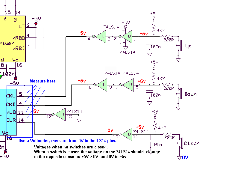

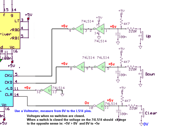

Look at this image of the switches and check with a voltmeter, lets know what you measure.

Did you take those voltages measurements I posted.?? and what did you measure.?

mate i already measure the volts in the up button it start to 5 and when i push the button it goes down to zero .. but still it doesn't count .. what should i do next ??
Tell me what all the voltages are that I marked on the drawing I posted, when the switches are NOT pushed.
Also say what they are when each switch is pushed [ one at a time].
the up button is the only button i put in the breadboard to test the circuit , i didn't put for the mean time the down and clear button should i put that already ?? .. i measure 2 volts and when i push the up button it goes down to zero ..
For the counter to work all the components shown on that drawing post # 46, must be connected.
Look at this drawing and measure the voltages marked in blue, inside the blue box, tell me what on each of the 4 pins.
