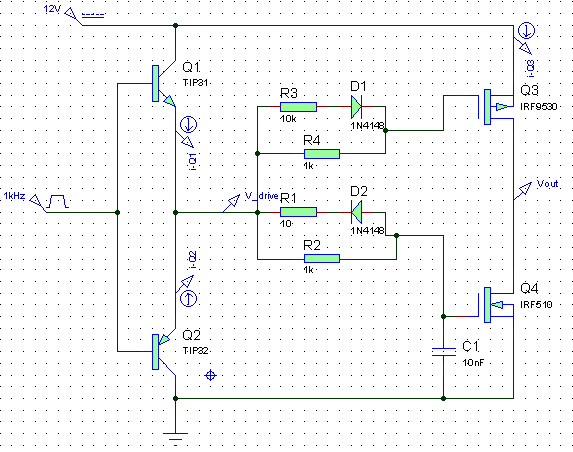

Lets go back to your topology:
I appreciate that you have only One PIC PIN (the PWM pin) BUT in your figure you have 2 signals comming from the PIC.
PWM
You have a "PWM Pulse" and a "PIC Input" I take it by "PIC input" it is actually an output from the PIC?
So you do have at lest 2 pins available?
Right Now you are saying you are using "PIC Input" as some form of H-Bridge direction signal? and the "PWM Pulse" as your driving pulse?
PIC Input LOW
With "PIC Input" LOW The no matter what the "PWM Pulse" signal does no current will flow
PIC Input HIGH
With "PIC Input" HIGH there is a problem. With PWM Pulse LOW: There is no path for current to flow around the supply - ok BUT you have both top FET's ON!!! Zero-loop across the motor, that ok.
BUT you are also supplying gate voltage to the bottom FET's They are now ON!!!! the only saving grase is there is no close-path for the supply current to flow
However, When PWM Pulse is fired and thus turning on the lower FET you now are A 5 FET's on and effectivley a short across the supply
I fail to see how this is ever expected to work, upless I am missing soming
The only way this would work is IF each side "PIC Input" was their own signal, complement of each other which from what you are saying they dont.
Please If I am mis-understanding how you are driving this please correct me, it is my week off and I am just spending the week getting drunk watch DVD's. But I have seen no H-bridge topology where it is driven like that. You always need the complement PWM
Thus what I am saying is scrap the bottom FET, this now gives you TWO PIC output pins. feed one of these signals to the left input and the other to the right. The difference between the two signals is that they are the complement of each other.
50% duty => Net current = 0
>50% duty => Net current >0
<50% duty => Net current <0
Scrap your bottom FET and your circuit should work. Use mine and you have the benefit of dedicated gate-drive and tuneable shoot-though protection.

Keep the Bottom FET and use it as a power-on disconnect rather than a PWM This will ensure that the drive is only active once you want it to be. Otherise you are running straight away

Not bad. All I did was scale down one of my 20kW H-Bridges so might have missed that sneaky method. BUT present topology still has the gate-drive problem. That is why I would prefer my method - ensuring FET's are hard-driven

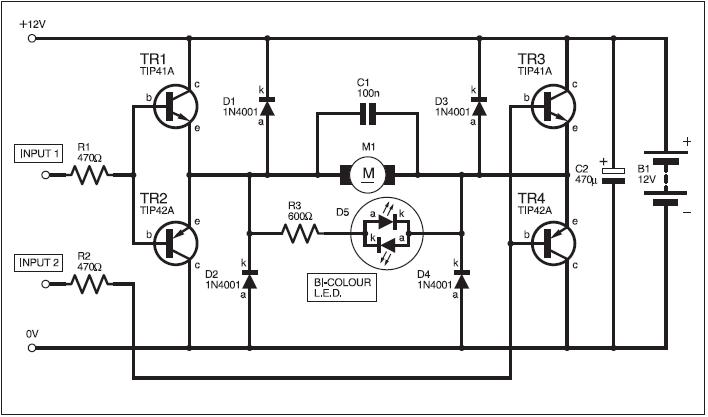

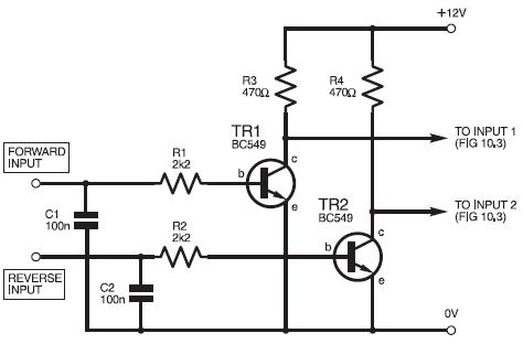

i dont want to interrupt the ongoing discussion here but ive found a H-bridge circuit and its driver in the August 2004 issue of EPE. what are your comments about it
It's a crude little circuit, but fine for what it was intended. My biggest problem with it is driving the motor from the emitters, you lose so much battery voltage by doing that, and the transistors run hotter because you can't get enough base current into them.

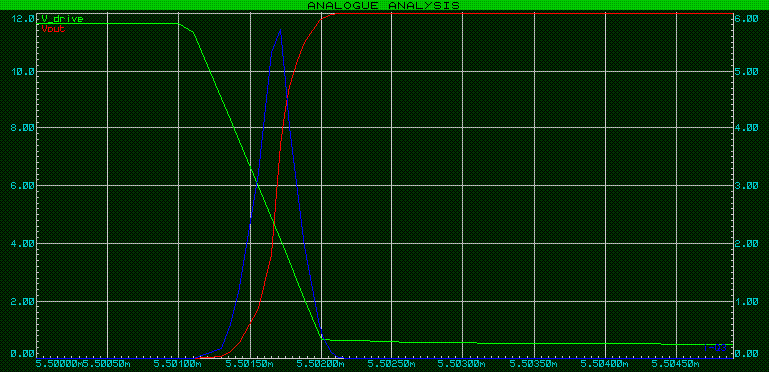

actually we did a simulation in our lab in which we had to build a H-bridge circuit and drive a motor with it and measure the voltages and the currents. the circuit that our teacher gave us was simillar to this one. the motor was being driven by the emitters. uptil that day i had only seen H-bridges in which the upper transistors were PNPs (or P channel MOSFETs) and the lower ones NPNs (or N channel MOSFETs) so the motor was driven by the collectors. i told the teacher that the configuration that you have given us is wrong and it should be the other way round. he said that it doesnt matter, you just have to make a path for the current to flow. could you you explain how the base current is low and the voltage drop is higher
The selected C on the gates (the value of about 10nF was needed) of the N devices may solve the spike problem at the rising edge but there's still a problem on the falling edge.
As I said It must be tuned.
Increase R4 to about 7k
Makes no difference even with a 20K. You most probably need a big cap at the top as well.

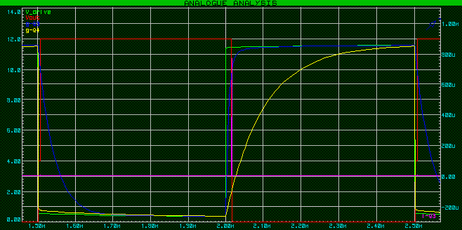

Cap's at the top seems to work.
I found this strange, so after trying another FET model I re-run the simulations. This time the delay was enough with a much smaller value of C (100pF) and the 7k resistor suggested by Styx originally.
That specific model must have been flawed as it made no real difference if I had a 1k gate resistor or 100k!
In the existing configuration (with the emitter the output), the emitter has to be 0.7V lower than the base - so you're losing at least 0.7V straightaway, plus losses in the transistor.
Then the base current, this is governed by ohms law, and is equal to voltage across the resistor divided by the value of the resistor. Because the base has to go high, you've got no voltage to work with - so the base can't go as high as 12V (again restricting the output voltage).
Assuming the base can get within 0.3V of the 12V rail, and the transistor has a gain of 100, and it's driving a motor requiring 1A. This gives a base current of 10mA. So to calculate the base resistor, 0.3/0.01, giving only a 30 ohm resistor feeding the base. The values used in the circuit shown will limit the output current considerably, resulting in a much lower voltage to the motor, and the transistors running MUCH hotter than they need to. There's also the obvious disadvantage of two 30 ohm resistors permanently across the power supply, wasting lots of your battery power! (one from each side of the H-bridge, either top or bottom, depending how it's switched).
My 'best case' calculation above would only supply a theoretical maximum of 10V from the 12V supply - but the values in the circuit would be far less under load.
With the transistors the other way round, things get MUCH better - for a start the voltage drop in that configuration is much less - 0.2V or 0.3V may well be possible, depending on the transistor. You've also got MUCH more voltage to play with for your base current, instead of the paltry 0.3V I suggested above, you've now got a whopping 11.3V instead! - so you don't need 30 ohm resistors anymore!.
If we assume a worst case of 0.5V drop across the transistors, we now have a reliable 11V for the motors, from the 12V supply, with the transistors turned hard ON, and running a great deal cooler.
