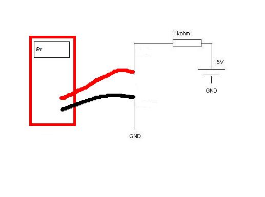

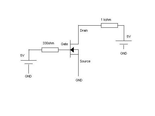

Do you guys mind to comment about this? I tried to turn on the mosfet by doing the following. With the circuit as shown constructed, I measure the voltage drop across the Drain and Source and I obtain 5V. But I'm not sure if Im doing the right thing as even though I remove 5V to the Gate, I still obtain a reading of 5V if I were to tap my multimeter on the Drain and Source...
Mind to comment about this? Please? Is it trut that I'm suppose to read any values if I remove the 5V source for the gate?
By the way, the MOSFET used is a logic MOSFET, IRL2703.

well of course ur gonna get a reading if you're putting your multimeter's leads on the drain and the source. just remove the fet and you are just measuring that battery voltage w/ the 1k resistor in series with the positive of the battery. take a look @ the picture.

Aikss...but if I were to try simulating it, I will obtain approximately 0V across the FET if I were to tap the voltage in the same manner....
By the way, if what I have in mind is totally wrong, do you mind guiding me how should I check or try out to switch the on/off of this logic MOSFET?
Thanks in advance...
devon . . . im sorry :oops: , actualy u r right. that WILL work :oops: :oops: :oops: :oops: :oops: :oops: i jumped the gun :lol:
i was forgetting that wen the FET is on, its like shorting to ground and therefore no voltage potential.
well, i see no reason why your circuit should not work. the only thing i can think of is that the voltage @ the gate is too high. on a FET that i was working w/, the maximum gate voltage was only like 4v.
VERY quickly, short the gate and the drain and see if this makes it turn on. if it doesnt, it might be shot.
also, the pinout on the FET is probably different from your regular ol' npn or pnp transistor, so beware of that. i forgot about that the first time i tinkered w/ FETs.
yeah but the MOSFET with which he is working with has a maximum gate to source voltage of 16V. and he is only applying 5V so that isnt a problem.
i would agree with you about the pin configuration. maybe devonsc has swapped two pins. check the datasheet and then make your connections
it was the best i could come up with :lol: . i just fried a FET cuz there was like 12v @ the gate (i thot it was higher)

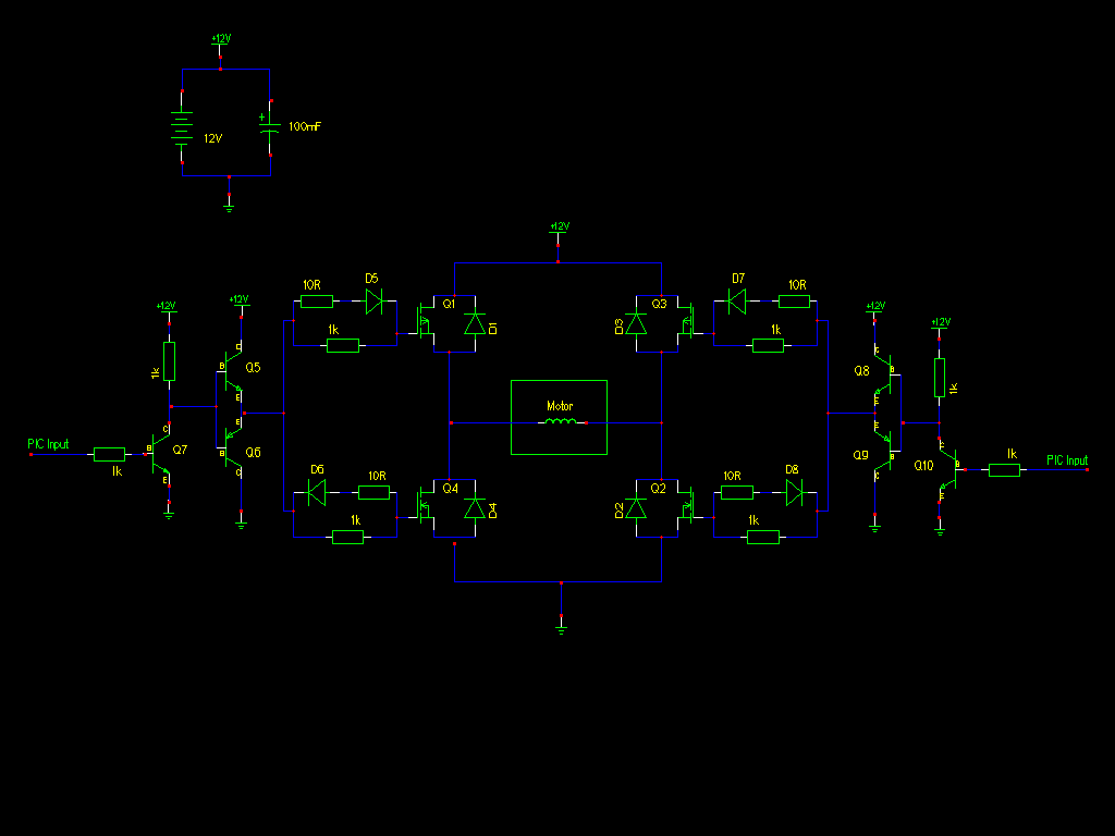

Can anyone tell me how does a MOSFET overheat?
Im currently attempting this circuit(U dont have to laugh at my circuit. i know its very lousy and crude. it has already been criticized. but since im using low current, it was ok). By placing 5V to the Mosfet , everything is fine. The motor works great. However, when i input PWM pulses into the mosfet( logic level mosfet), it heats up very very quickly.
Anyone knows why the pwm pulse can overheat it?
A MOSFET is no different to anything else, it dissipates heats based on volts x amps - W=VI.
When a MOSFET (or a transistor) is turned fully ON, it passes high current but only has a low voltage drop, so W is low. When it's turned OFF, it passes no current, but has a high voltage across it - so again, W is low.
If it's not turned on fully you get high current and high voltage, and the device (whatever it is!) gets hot. In switching circuits the speed of switching is critical, as the device will dissipate heat as it switches, so a slow switching speed will over heat the device.
I would suspect you either aren't switching the FET's on properly, or you aren't switching them fast enough - most probably the first option!.
I am guessing that the left and right PIC input signals are complements of each other - only way it will really work
The chances are it is overheating when you are PWMing it due to shoot-throughs.
If you look at your top FETS they have a 1k gate resistor to turn them off (slowing down their turn-off time)
you want Fast off and slow on when dealing with H-bridges (or have dedicated interlocks, which is better)

At a PWM edge where Left PIC input goes from HIGH to LOW and Right PIC input goes from LOW to HIGH:
FET-1 gate is now being pulled highby a 1k resistor (high value slows down swithcing - in this case slows turn-off)
Meanwhile FET-3 has had its gate pulled hard down to 0V via a 100Ohm resistor (via a BJT) This is a FAST-ON !!!!!. This puts the source at the rail voltage. This voltage now feeds FET-4 via the 1k off resistor of FET-3 - Slow-on
Thus we have a slow off of FET-1 and now a slow-on of FET-4 at the same time (is) thus there is a high possiblity of a shoot-though (more likely a soft shoot-through with the FET's in their active region)
The same will happen for the other FET's and equally for a LOw to a HIGH.
Sucha shoot-though looks inherent with this design (I never liked those 1k resistors for gate resistors)
Try this

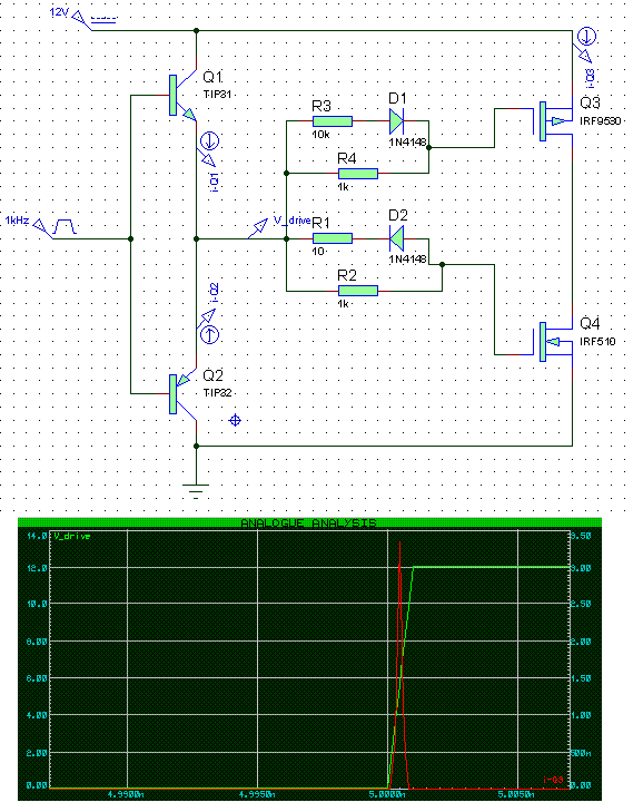

Using a new CAD program and forgot about the flip on the P-types
But I just realized that there's a bigger problem looking at it more carefully. The devices will be on at the same time, red current spike.
That is why I really didnt want to put actual resistor vaules to the gate-drive (the 1k and 10R)
That will be dependant on the FET's being used. Since I do not know the generation of FET or more importantly the gate-charge of the FET I couldn't spec.
With your simulation you will proably see that shoot-through happening when the P-type turns off and the N-Type turns on (and maybe to a lesser extent then N-type turns off and P-type off).
With the higher gate capacitance on the P-type, the 1k is probably too low to turn it off.

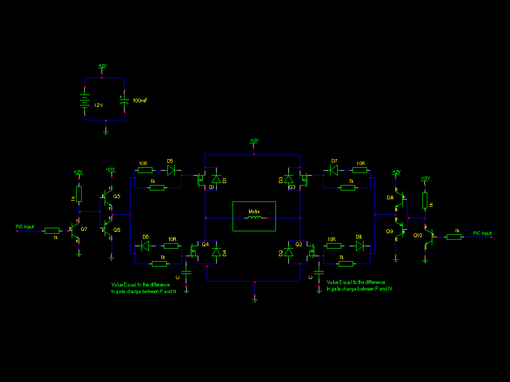

Since this is a low voltage/low power H-bridge (a higher power would use dedicated interlocks) - could you find out what the gate capacitance of hte P-type is, compare against the N-Type.
The difference in capacitance, use that value (or closes standard value) and put a capacitor of that value in parallel with the N-Type gate terminal (across the Gate-Source)
IF you remember the original problem Fabbie only had 2 pins on a PIC to use. Delaying the switching of the FET's via it's gate-charge is an ok hack, but really you need dedicated interlocks. You really need a dedicated drive signal (and thus gate-drive) per FET/IGBT. Since Fabbie is resitricted, this approach is good BUT it must be turned for the FET's being used
Re-try with an xtra cap
Updated...

Eqaully TheOne this was inherint in the previous design (if not worse) and is why I mentioned the heating of the FET's probably due to shott-throughs in a leg.
My approach with appropriate tuning (with limited control signals) will remove the shoot-throughs

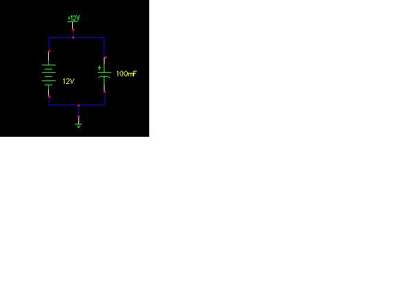

As to the final point about what is the battery and the 100mF cap. It is exactly that.
You said this wat to run form a battery (or some other voltage source) that I assume you can discconect via a swithc somehwere. However, you still need a DC-link cap. For the acceleration and the sudden changes in load the battery probably wont be able to source all the charge, the cap acts as a firmer source - has to very close to the H-bridge.
Probably doesnt need to be a big as 100mF but suitablly sized for the ripple current that you will be seeing
