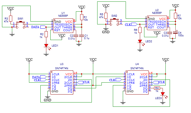

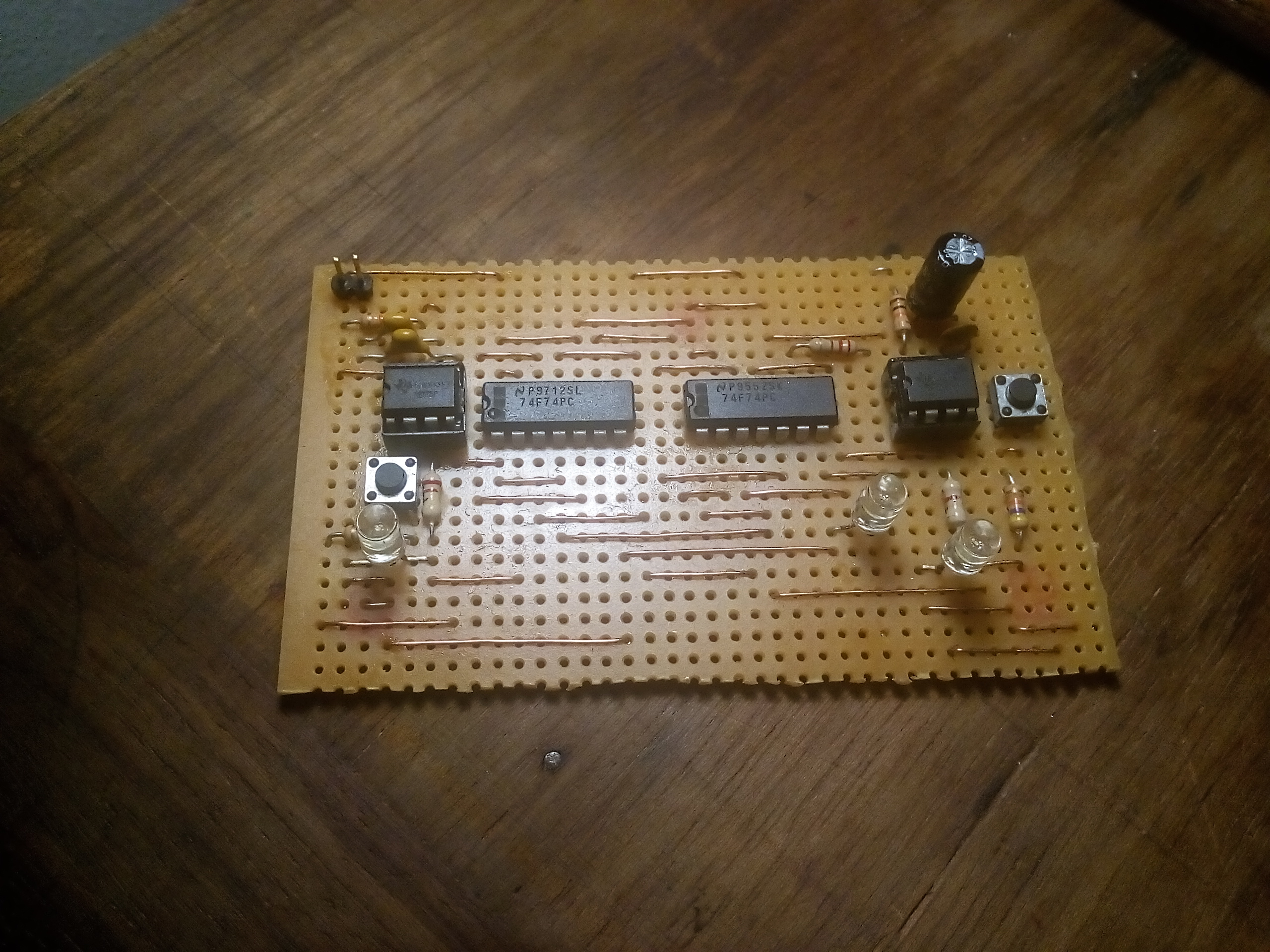

Ola ... Hmmm how to explain ... A flip flop is a type of temporary memory storage IC ... There are 3 common types: D, SR, JK ... The outputs of these devices can change states depending on what you set on the input and how the device is clocked (please search "<insert flip flop name> truth table" on the web to see what I'm trying to say) ... They can either be negatively or positively clocked ... Negative clock signal = signal that goes from on to off and positive clock signal = signal that goes from off to on ... 555 timer will come in handy for clocking signal because it eliminates something called bouncing when using mechanical switches or pushbuttons ... I found a great book on the web called "Digital Fundamentals" by Thomas L. Floyd ... It will explain it in a much better way so please try to download it ... Attached below is an application of a D Type FLip Flop to form a serial in serial out shift register that I had to do for school. YouTube Channel "Ben Eater" has the best tutorials on digital systems so check him out as well
