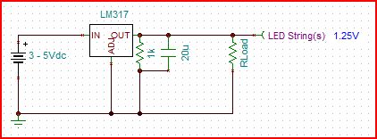

Seems to me that a simple voltage regulator circuit, using the output of the convertor you listed, would suffice.
For instance:
In a SIM it only supplies the current that the RLoad dictates (the resistance of the LED strings) with about 1.3mA being used by the regulator.
A very simple circuit to construct and probably capable of handling most (if not all) of your strings (up to the limit of the convertor - 600mA). I'd attach the strings, adding one at a time, and see what happens. Note that the LM317 will get warmer as you add load and might need a heat sink.
And, given the usage, probably wouldn't need the 20uF cap. If a Vo of 1.25Vdc is inadequate, it can be raised by adjusting the circuit.

An LM317 is a voltage regulator that you do not want for LEDs. But it can be connected differently as a current regulator to light LEDs.

An LM317 can be connected as a current regulator to light ONE LED product like a string of fairy lights, globe or a lantern. But Jagsy has many different LED products he wants to light, each having different LEDs and different currents.
Therefore we decided to regulate the voltage to about 7.5V and use a separate series resistor to determine the current for each product.
