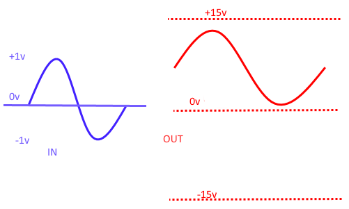

swing between 0V and the 15V
The amplifier can not swing to the 15V rail. It can not swing to the negative rail. I can not find what the max output is but I think with a 0 & 15V supply the output must be about 3V to 11V.

Thank you for your reply. I would like the output waveform to be identical to the input (not clipped as you show in red), but offset to swing entirely above 0V, and as close to the positive rail as practical.
Power supply is +/-15VDC as per previous circuit diagram.
What I want to do is simulate, using the TDA2030, what used to be termed a "single ended" amplifier. In other words, the output is monopolar and does not cross into negative voltage region. The DC coupling is to allow passage of sub-audio frequencies.

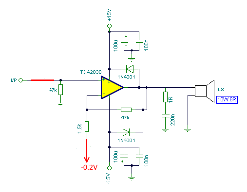

If the above picture is right; The output needs to be raised 6 volts. Pulling down on the (-) input a little will do that. (or pulling up on the (+) input.
The gain is about 31. 47K/1.5K=31. Need to move up 6V. So 6v/31=0.2v.
Just so you know this does not guarantee the output will not go negative. It only moves the "0" point up to 6V.

You can make the -0.2V with a 500 ohm pot and a 14k resistor to -15V.
One end of the variable resistor connected to ground. Wiper arm connected to 1.5k resistor. This will make about 0.5V across the pot and allow you to adjust the offset.
You just answered my next question as I was writing it.

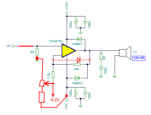

So a 500R trimmer as a voltage divider, one side connected to the negative rail through a 14K resistor and the other to ground, with the center tap to the circuit's existing 1K5 resistor.
If this is done correctly, is there anything remaining that could cause the TDA2030 output to swing negative?
I added a diode that will look for a case where the output goes -0.8V. If the output goes a little negative it will pull down on the (-) input causing the output to stop its downward movement.

Unless there is another solution, I will build the circuit Ron kindly provided and try doubling the load resistance to compensate for the DC offset.

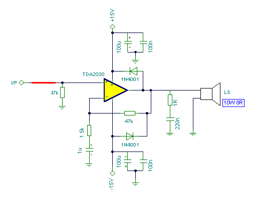

Why not use a single-supply audio amp circuit, that works between 0V and positive supply to start with? Leave off the output coupling can and you have a unipolar varying drive to your coil.
Starting with a dual supply is part of the problem and over-complicating things, i think...
You can even use the TDA2030 if you want, with a minimum 12V supply -
