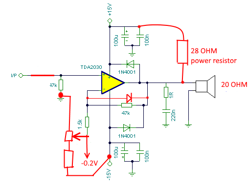

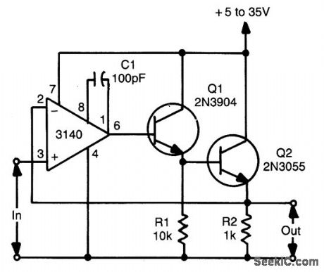

Yes, you are all correct. I thought I could simply modify the existing split supply TDA2030 device. Now I can see it will be more straightforward to just build a single supply, DC coupled op amp and emitter follower (see attached).
I should have made it clear at the beginning that I was not driving a speaker, even though one was shown in the generic circuit diagram I linked to. If the output swing is not bipolar, and has no DC component, I assume no decoupling cap is needed at the output.
Alternatively, I could stick with the TDA2030 circuit and add enough series resistance so the DC resting at 6V does not overload the output. Obviously not very efficient though.

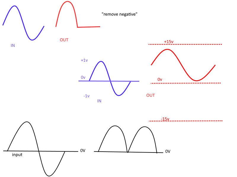

Maybe you should be drawing the pictures.
1) Remove the negative is not right.
2) Offset is/is_not right.
3) Rectification, no comment.
Now we are back to this: Which removes the negative. Was rejected before.

Your antique opamp driving a little transistor that drives a monster very high current transistor has no +6VDC input offset voltage so the circuit is simply rectifying the sinewave.
Being a bit of an antique myself, I have used similar circuits when the input signal is monopolar. For example from a function generator and not line audio. I would, by normal practice, add an input offset for the latter.

The signal I am intending to amplify contains both sub and low audio. The source is a type of magnetometer. Since these files are recorded, and played from an MP3 device into the amp, the signal input to the amp is bipolar. All I wanted to do by modifying the TDA2030 was to convert its output signal back to monopolar, as per the original magnetometer output.
The original circuit diagram shows a +/- 15VDC supply. How about adding some of the positive rail voltage to the TDA2030's output to offset it by +6V so that the offset current is provided by the supply and not the amp?
You can use a TDA2030A if you want. In your circuit on page 1 of this thread its gain is 1 + (47k/1.5k)= 32.333 times so for an output offset of 6V then its input pin2 must be -6V/32.333= -0.1856V with a resistor to -15V as shown in post #5.
The TDA2030A and all other audio amplifier ICs have an extremely low output impedance. If you try to force its output then it will fight back and cancel it making lots of heat.
An MP3 player will not play earquake rumbles, it will play music down to 20Hz and cut lower frequencies a lot.
Your coil will have a very low resistance to your +6V offset voltage which will need a very low resistance to make +6V feed the coil.
The TDA2030A and all other audio amplifier ICs have an extremely low output impedance. If you try to force its output with a DC offset then it will fight back and cancel it making lots of heat.
my meaning was to offset the TDA2030 after its output.
If the "0" point of the amp is +6V, then play with the value of the 28 ohm power resistor so that the load and the new resistor divides the 15V down to near the same 6V. This way some of the power that is needed is shunted round the power amp and directly to the load.
The new resistor will run hot but the TDA2030 will cool off.

The output of the amplifier has an extremely low output impedance (0.04 ohms or less) and will use all its power to keep the average output voltage at 0VDC. In order to offset its DC output at +6V then you need to add a series resistor between the amplifier output and the 28 ohms resistor but the resulting voltage divider reduces the signal output voltage swing.
It is much better to offset the inverting input and let the amplifier amplify it to an average of +6VDC.
