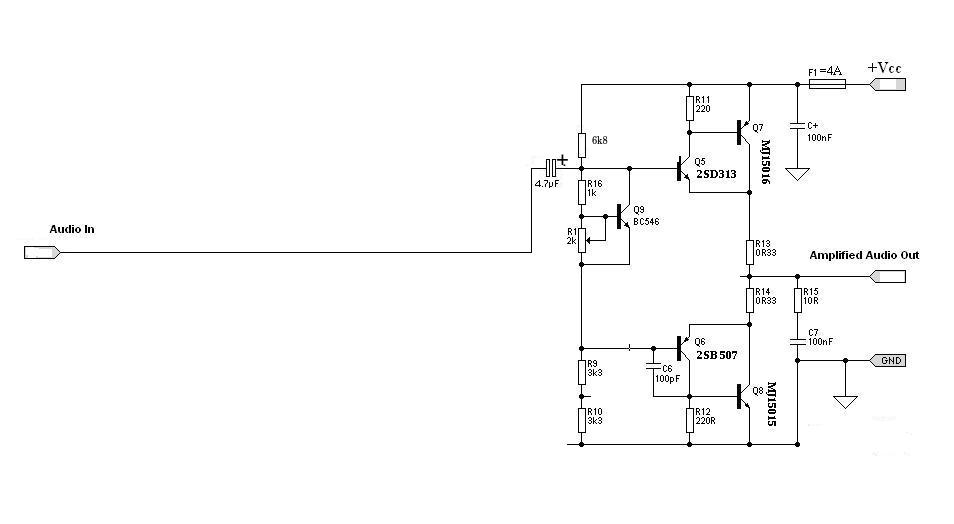

For reasons of experimentation, I was asking here for a way to modify that to a non-reversing current using passive external components. IOW to shift the bipolar signal entirely above ground potential.
ok, well that's at least a little bit clearer... couple the output through a capacitor, and either add DC bias to the signal, or use an added output pair that runs from a single-ended supply. here's an example of what i mean:
it's basically the same output stage as what you have in your original amplifier, and acts as a unity gain buffer, and a level shifter at the same time... depending on the frequency of your signal, you might want to adjust the value of the capacitor. any output stage configuration will work here, the one shown (copypasta from the schematic you posted) is a Sziklai pair output stage, but a darlington output stage will work just as well.

it's still not really clear what you are trying to accomplish. if you are trying to minimize magnetic coupling from the +/-VCC rails (to the input stage for instance, which could generate a small amount of even harmonic distortion), then the best method for reducing magnetic coupling would be to use twisted pairs of wire (each VCC rail and ground) to go from the power supply to the amplifier. this is the method used most often in commercial amplifiers. there is no "current reversal" happening in the output stage, except in the output wire to the speaker itself. the current never reverses in the power supply wires. you will have current in the positive side of the supply during a little more than half the waveform, and current flowing in the negative rail during a little more than half the waveform. hypothetically, there should be very little current at all in the ground wire to the amplifier, and the speaker grounds should actually come from a "star" ground in the power supply.
if you are trying to convert a bipolar (-50V to +50v swing for instance) into a single polarity output (0V at the negative peak, and +100V at the positive peak), then look at the circuit i posted, it will do the level shifting, and maintain the same current capability (it will need to have a positive supply equal to the sum of the bipolar supplies i.e. +100v if the amplifier supplies are +/-50V, and have the same current capability)... just keep in mind that a resistive load is going to dissipate a lot of heat when the amplifier is idling, because 0V at the input of the stereo amp, will idle the output of the level shifter at +50V. having no input (even if you biased the audio input to run the stereo amp at -50V, and bypassed all the protection circuits and offset decoupling) will still give you a +50V idle at the output because of the capacitive coupling going into the level shifter. do not use the level shifter to drive a speaker, it will roast the voice coil of most speakers almost instantaneously, if it doesn't launch the voice coil into orbit first.
