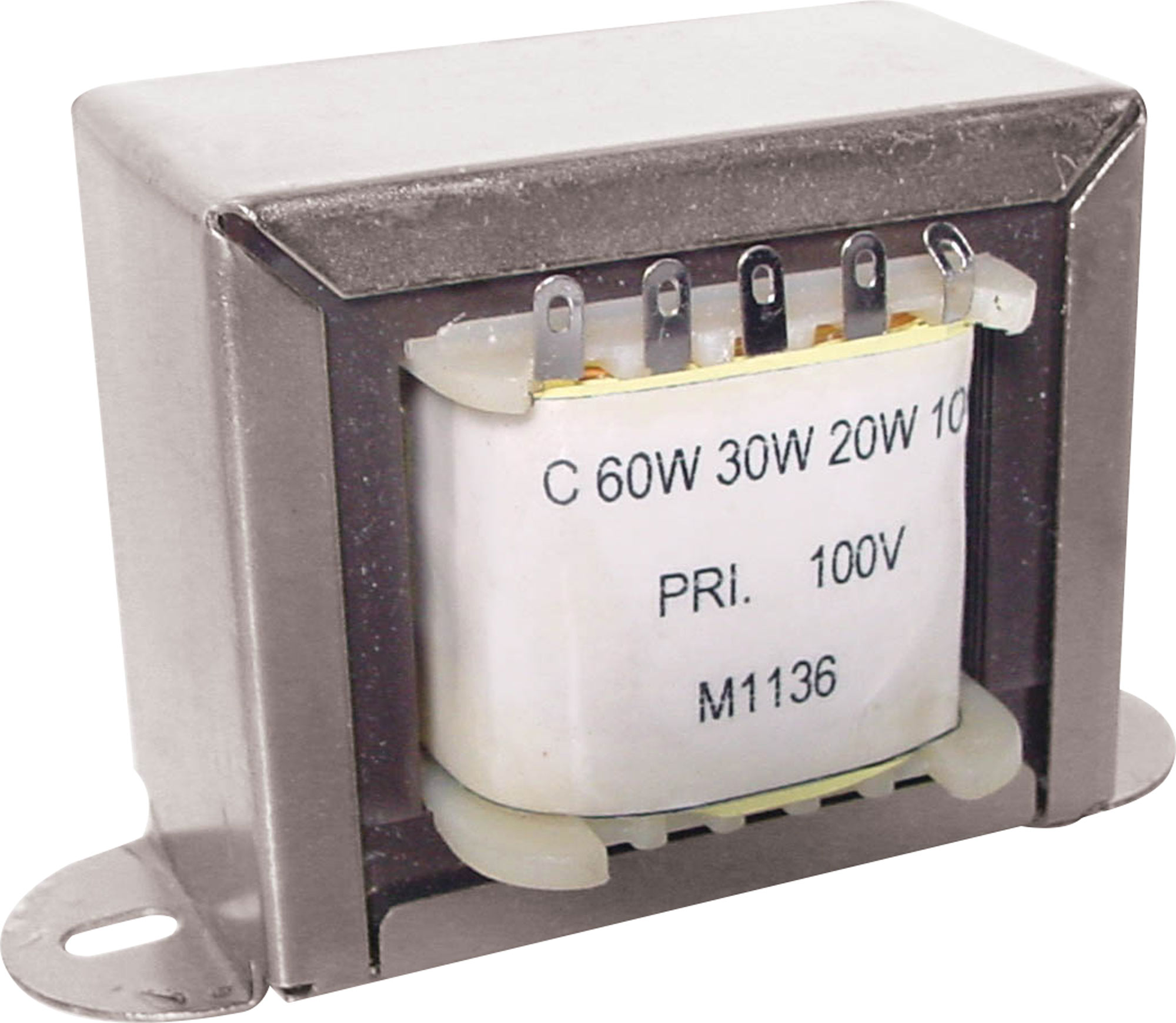

Can ChrisP58 please explain what type of transformer to use and how it would be wired? I have a few PA line transformers on hand.

If you do need a transformer, you want something with a primary impedance greater than that of the output of the MP3 player, with an acceptable turns ratio. The primary to secondary voltage will be be affected by that turns ratio.
By PA line transformer do you mean a 70 Volt speaker transformer? They should probably be OK, but you'll probably want to use the highest 'power' tap on the primary. (which will be the lowest P to S turns ratio)

I have uploaded an image of the type of transformer I was referring to.
If I understand your latest rely correctly, I would wire the amplifier output across the primary common and 60W tap, which is the highest power available on this particular transformer. The unipolar output then appears across the common and 8 ohm secondary.
Can you please explain how this removes the push-pull current reversal that would be present at the amp's output? Do the common tags need to be tied to ground?
On related point, it appears wiring the transformer as above will reduce the output voltage of the amp. I assume it would be OK to wire the transformer the other way around, i.e. amp output into the 8 ohm tap. That way I can step the voltage up instead of down.

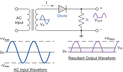

The reason for my OP was simply that a need an output that does not reverse in current, since this would double the frequency in my particular application.
How about a single series diode?
But, depending on the power, the amplifier may not be happy driving such an unbalanced load. You could use a full wave bridge, but that would double your frequency.
OK. I will separately try a diode as well as a cap to see which works best. But I am concerned the diode may alter the signal's waveform or DC level.
If an unbalanced loading is a problem for the amp, I can artificially load the other output terminal with an 8 ohm resistor to ground.
Still, I am hoping the amp I have is not BTL and will already be driving directly to ground. If not, I now have a few solutions.
A standard silicon diode will drop about 0.65 Volts. Depending of your frequency, you'll probably want a fast recovery or a switching diode. Schottky diodes are fast, and have a lower forward voltage, but have a higher reverse leakage current.
A capacitor (alone) will strip off any DC offset that may be present on the amps output. But will still leave an AC voltage that will produce an Alternating Current (changing direction) on it's output.
Thank you for clarifying that point. I was thinking though that the diode would clip any part of a BTL amp output that is negative with respect to ground. See uploaded image.
With regard to your comment on the series capacitor, if it shifts the DC level entirely above ground reference, then it would appear the current does not reverse relative to it. That is actually what I was looking for, and what I originally meant by no current reversal.

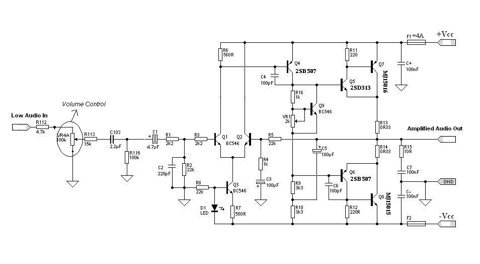

With regard to "unbalancing the amp", I was referring to Chrisp58's earlier post, which I had assumed applied to the BTL type, not push-pull.
Thank you for your patience.
The amplifier you posted uses a split supply, so the output varies either side of zero, i.e. swings both negative and positive. An older amplifier, with a single supply, uses an output coupling capacitor - and while the output on the transistors varies negative and positive with respect to half of the HT, the speaker output (after the capacitor) swings negative and positive with respect to ground, exactly as the split supply one does.
As I've said before, if you tell us EXACTLY what you're trying to do, we can make sensible suggestions - as it is your entire premise may be wrong?, as your questions make little sense.
