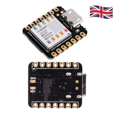

For an MCU, I'd suggest an ARM based arduino compatible board such as an M0. Using SPI as the main outputs, you don't need many I/O pins.
eg. These are cheap, program with the Arduino IDE once you add the seeed library files, have SPI that can run at 12Mbit I believe, with 256K Flash and 32K RAM:

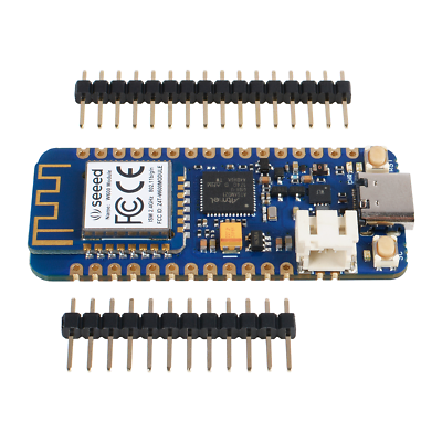

Or with WiFi included:

Those both work from 5V input, with onboard regulators and the MCU IC operating at 3.3V
