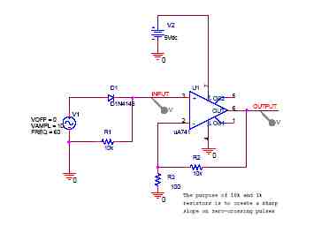

I'm doing a similar project where I use triacs to control the heater.
The zero crossing circuit is connected to secondary of 120:10 transformer (in this schematic I'm using 8V AC source).
The output of zero crossing circuit is fed to the pic (via interrupt) which controls the current amount within the heater (via firing angle). Like Nigel said, it is important to isolate the triac from the pic by using an optocoupler.[/img]
