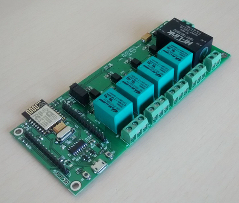

PC/Cell Phone ------ internet -------------- Raspberry / ESP-8266 + relay + Home Appliances
Here is a board I am looking at. I want to put many relays on a wireless network. I have the PC/Cell/Raspberry on the network and can get in/out to the internet.
