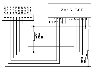

i using a PIC16F628 with PORTA configure just like Nigel's LCD board and PORTB with bit7 a the input and the rest as output, firstly i use bit 6 of PORTB as the input to the enable of the first stage decoders (consist of two 3to8 decoders) (with the second one control by 0 via a not gate) then bit 5,4,3 as the input to the first stage decoder select lines (which is tie together pin to pin) followed by bit 2,1,0 to the select lines of the second stage decoders (which consist of 16 decoders also tie together), the first stage decoders is use to control the enable pins of the second stage decoders and lastly the output of the second stage decoders are all tie together to bit 7 of PORTB
*this idea is contributed by amitak
now that i had configure the PIC this way, i written a program based on using the LCD Subroutines by Nigel, while i wait for the components to arrive for me to test, i tt that i upload the program i wrote and maybe can get some advices from you all because this is the first time i writing a PIC program

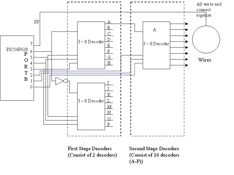

Do you have a circuit you could post.?
Using only LS138, IMO will not give the result you are expecting.:)
i think i better try to explain what am i writing
i try to set each output of the second stage decoder on one by one and after which check bit 7 of PORTB and if on, display PASS and if off, display FAIL
the setting of the outputs is done first by only setting the first 5 bits of PORTB(6,5,4,3 and 7 is output) and after that call repeat which is the last 3 bits which consist of the pattern(001,010,011,100,101,110,111) and then call check which is use to check bit 7 after that is the pass or fail
i display 'Wire' in the first line and after that by the number which is store in Acc (it increment everytime the program come into Check) and the value is store in the working register and display using Call LCD_CharD, the pass/fail is display on the second line..
hope i dont confuse you more..:eek:
I am not confused,;) just not convinced.
Post a sketch.:)
In my opinion... I would like to see a circuit diagram before looking at a program.:)
:D, ok i will draw one then

well, here is my circuit..
here is how PORTA is configure, the same way nigel did his..
the pic is taken from his website

hi nitE,
I guess you know the selected output of a LS138 is LOW.
As all the 100 wires are linked back to the other LS138 HIGH outputs, the active pin will not sink 99 high outputs, the LS138 is not tri-state.
I know my opinion has not been asked, but I will give it anyways. A 100 pin cable will be a disaster to build, and to be reliable will be an equal problem. The biggest cable I have ever seen built was a 96 pin digital video cable and it was a manufacturing nightmare. You would be better off to partition the 100 pin I/O into 3 separate cables. Perhaps your board design is already done, in which case I guess you are stuck.
yes as said by eric the active low out cannot sink the current of other outputs :(
maybe u can use a 1:8 multiplexer (and connect the input to Vcc) or look for another part number with trisate outputs
yes the lcd display routines take up most of the program ..
to me it seems that it would not be necessary to display the pass/fail for each wire ..
maybe scan through all the 100 wires and then just say if all are ok .. or the list of wires which are not (remember to leave some delay for the user to read the result
I use the HEF4067B analog mux/demux it this type of application.:)
100 pin cable still sounds like problems to me... I would not do it.
If one wire faults... what a nightmare.
I had to read this carefully, in case i got it wrong.
do anyone here know how can i build a continuity tester which can test 100 wires at the same time and the result to be display on a lcd? thank you!
After i read this thread a couple of times, i concluded that i havent got it wrong.
The poster doesnt say its a cable, he says "100 wires".
This may well be in the form of a loom, maybe for a motor car, or similar.
Being able to pinpoint a faulty wire easily could save a lot of time.
And if its a loom prior to being wrapped, then a wire could be changed.
Such a unit might only have to save a few looms to pay for itself.
To check 100 wires simultaneously requires a lot of circuitry.
i will appeciate if i don't need to use a MCU, i don't mind if the circuit is big..
So whats the minimum set-up here ?
A hundred connections with a light on each. And a hundred connections at the other end, all taken to common.
An unlit light should stand out clearly.
Complicated ?
Not really, its about as simple as possible.
Being straightforward means it can be made easily.
More importantly, its easy to understand. Which makes it easy to repair if needed.
Indication.
The OP says he wants to use a liquid crystal display to show the results.
These are usually matrixed up, which just makes more problems.
I would suggest LEDs, and a dummy load on each wire, to load each wire to its required current rating. This is in order that any wire or its associated connection would show up if it cannot handle the current required.
Such a unit would be easy to make, and would show all the wires at once with 100 LEDs.
I dunno, the more i read this thread, the more it looks like another introduction to MCUs.
Best of luck with it, John :)
