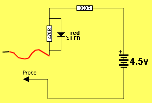

This is a continuity tester as well as a LED tester:

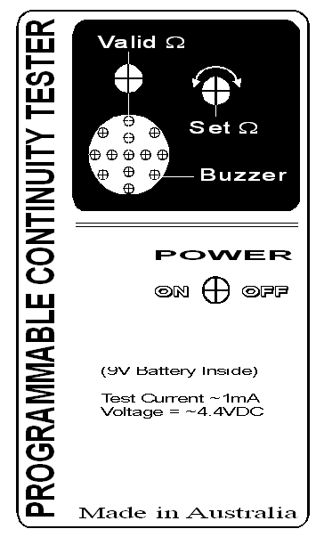

Why not make a meter to measure low resistance, say less than 5 or 10 Ohms, and have an adjustable alarm point setting so that as you are "buzzing out" a cable or whatever, the thing will sound to tell that there is continuity if the resistance is less than some value set by the user, say 2 Ohms.
Jim this project presented here does exactly just that. The threshold / adjustable alarm point is set by turning the trimpot. It can be set from anywhere between a few milli ohm to a couple of hundred ohms.

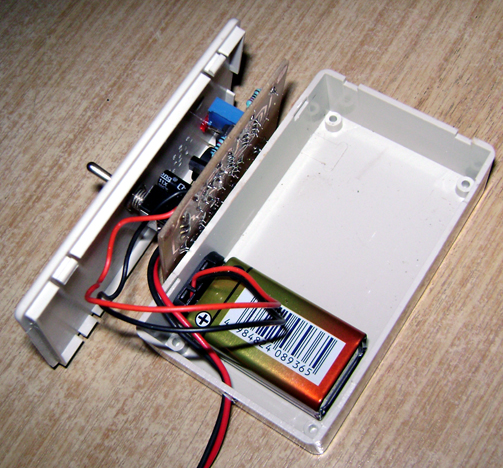

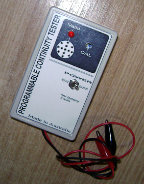

I now have this boxed up... and it works a treat! ...
a-jpg.92262
b-jpg.92263
