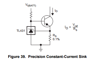

The TL431 has many good applications such as a CC sink
But I can't say it is better until you have an application spec.

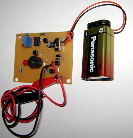

Well I made an PCB for it, built and tested. Circuit can be tuned to indicate continuity over an wide range. Below a few ohms or below a few kilo ohms. Calibration is done by adjusting the 25-turn precision trimmer. If to be used for detecting only dead shorts, connect alligator clips together and turn clockwise until the buzzer and LED comes on. It should be noted that the buzzer has its own internal driver circuit for oscillation / tone.

Interesting is that I simulated this continuity tester circuit in LTSpice and took and recorded many measurements. DC voltage measurements probing around the constant current source building block. But in the real world with an actual built, tested and working PCB prototype these measurements are different. The only thing I can think of is that I simulated with 2N2222 transistors but built the prototype with BC series BJTs.
Most likely it eh? The bug is me not LTSpice!
You might want to ensure Voc does not exceed a diode drop unless you want this to tests LEDs too as the Voc is high enough to indicate forward conduction on diodes as a short, which would be part of your spec. if you tried to make one. However , the pot could be adjusted for <15 Ohms ESR to turn on 5mm LEDs but not trigger the comparator & buzzer.
The 1N4148 ESR @15mA would be comparable to the 5mm HB LED with ~ 15 Ohm ESR.
Test it on CMOS input to ground in both polarities to see what I mean.
However 15mA may exceed CMOS ESD current rating for diodes.
I have not tried testing an diode yet. If it works would this be a positive or negative specification you think?
I do not think it will work since the circuit in essence measures the DC voltage drop across an constant current source, and this drop must be greater than the reference point, which is adjusted by VR1 (multi-turn precision pot) -- on the comparator for the LED and buzzer to be activated. The voltage drop across the CC for an dead short is very high. The higher value of resistance results in an lower drop. Now you can hopefully see why an diode will not register as an short.

If the threshold is set to trip with a 22 Ohm Resistor , then a diode will trip the buzzer.
If set to a 1 ohm resistor then it wont.
Where are your specs? I dont speak from theory, but 40 yrs of work.
Yes Sir. Correct ;)
And in all practicality if you are probing around testing for actual continuity -- you want the tester programmed to 1R right?

Depends on application. Agreed but if that is all, then no need for 25T pot.

Beware that probes will try to inject constant 15mA up to 3.5V + on Red clip., and that some Semi's like CMOS input ESD protection diodes might only be rated for 5 mA.(?)
The CC is 6.5mA now.

This CC cct has 2 load lines controlled by 10K and 47R determined by Vbe of Q2 for the 47R and the 5V for the 10K load line.
It would have been more accurate to use the 78L05 as a CC source alone then current sense outside the loop on a series R set to <=100mV or so to a filtered comparator for indication. Buzzers are usually 0.25$ in volume including oscillator both piezo and magnetic.
This CC is an textbook building block. The schematic has changed slightly. The shunt resistor in the CC is now 100R.
The two NPN transistors and resistors in the CC workout to be cheaper than an 78L05.
