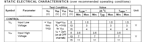

A lot of chips nowadays have have digital inputs that will work with 3V or 5V logic threshold voltages, even if the chip itself is being powered by a voltage higher than 3V or 5V. Your demux chip is NOT one of them.
Page 6 of your datasheet has the following table. As you can see, if you provide it with higher supply voltages, the logic threshold for HI and LO signals also rises and above 12V it is at around the limits of what microcontrollers can output.

Your MCU is not providing high enough voltages for the digital input thresholds of the demux. A lot of chips nowadays have have digital inputs that will work with 3V or 5V logic threshold voltages, even if the chip itself is being powered by a voltage higher than 3V or 5V. Your demux chip is NOT one of them.

Any voltage below the logic LO input threshold voltage will be recognized as a LO by the demux. As you increase demux supply voltage, this threshold just keeps getting higher. So any LO signal output by the MCU will still be below the threshold and that means your MCU can still send zeroes to the demux.
Any voltage above the logic HI input threshold will be recognized as a HI by the demux. BUt the HI voltage threshold for the demux increases as you you increase demux supply voltage too. Your MCU cannot output a HI signal to exceed this voltage threshold. Even when the MCU tries to send HI signal to demux, the voltage is so low that it is less than the logic LO threshold so your demux will see it as a LO signal.
So your MCU can still send LO to the demux, but not HI. If your MCU sends HI to the demux, demux will see LO. So if switching channel 0 only requires all LO signals, your MCU can do it. But it can't do anything that requires a HI signal.
But I need i/o output of MCU, in this case what kind of component should I add on the i/o port of MCU.
You could use a pull-up resistor to 12V on the input pins of the demux and use a pull-down logic-level MOSFET that has it's gate driven by the MCU. SO when the transistor was off, but the resistor would apply a HI to the demux input, but when the transistor is on it would pull the line LO.
