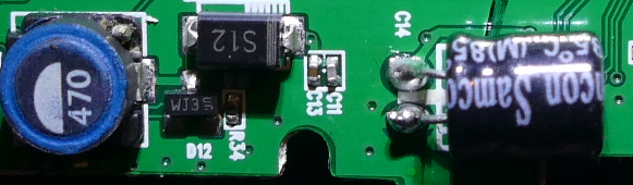

No, the charging circuit will almost certainly be crude, nasty, and really horrible - probably just a single resistor.
There seem to be an awful lot of heavyweight components for this to be a crude and nasty circuit:
And doesn't explain how a 4.5V minimum chip runs off 2.4v.
Eg. The component bottom right labelled WJ3 is likely a " SOT-23-5 Linear voltage regulator IC LDO, 3.5V±1%, 200mA, +CE, CL, PDR" which also requires at least 4.5V input to produce its 3.5v regulated output.
Just because the overall phone is complex does not mean the battery charge is - for NiCd or some extent NiMH, all you need for slow charge from a known voltage is a resistor. Anything less than 1/10C rate can be applied forever to NiCd, or somewhat under 1/20C for NiMH.
With the right values of resistor and supply voltage, they can can charge relatively fast when dead and the charge current drop to below the safe value just as they reach full charge voltage.
A lot, lot simpler than lithium types.
At a guess the inductor-diode-capacitor etc. in the lower right block are part of a boost converter to give the main system voltage from the batteries.

FInally I have some actual readings.
On-hook     2.6 mA.
Off-hook     60 mA.
Speaker     190 mA
Ringer     >200 mA
There doesn't appear to be any standby mode, unless one kicks in when the batteries get low.
The speaker/ringer is a 16 Ω 0.5W unit driven by one channel of an LM4808 Audio Amp being supplied with 3.51V, which proves there is a step-up (boost) circuit being employed.
The left-hand terminal of the component labelled S12, has the NiMH battery voltage, the right-hand side is at 3.51V. (Good guess ;) )
As is the upper pin of the black capacitor.

It's a boost converter, as you say to generate a higher voltage than the battery - and also regulates it.

I wasn't commenting on the complexity, but rather the substantiality of (many of) the components on the left hand sde of the board between the charging pins and the battery leads. There are two substanital Zeners, 3 beefy transitors (2xHALY; 1xH5C), a couple of largish, axial inductors(?), the yellow blob.
Given the layout of the board, it seems (to me) these components can only be to do with charging the batteries.
Once I've let the batteries run down to check for a standby mode; I'll look at voltages flowing in these components when recharging. Whilst running on batteries there in no discernable activity on this part of the board.

Extremely unlikely, as already suggested they normally crudely charge via a simple resistor.
It'd be nice to know if this board could handle charging a LiFePO4 cell.
NO NO NO!!!!! - don't even think about it.
And yet, there are all those power components...
And you'll say: "Of course, it's a constant current source with voltage dip detection."; once I prove it is.
Just like you said " It's a boost converter, " once I'd proved it.
I've never seen a cordless phone with other than a crude resistor (no need for anything else), but regardless of what it might or might not be, it's ONLY for NiCd or NiMh.
