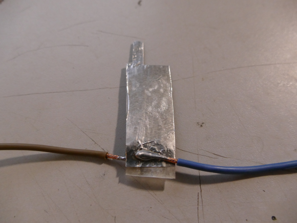

Attempt 2: Glued aluminium foil to both sides of a piece thin (0.5mm) stiff and relatively heatproof plastic. Soldered wires to both sides.
Good continuity between cable and foil both sides; and total isolation side to side.
But when I insert it into the battery holder and connect the meter set to the 2000 µAdc range, the phone does not power up?
Well the 'quality' of the soldering certainly suggests you used aluminium foil - which was why I suggested tin plate :D
2000uA is only 2mA, which is too low a range, and the voltage drop across the meter is likely to stop it working.
Stick a croc clip lead across the two bare copper wires you can see in the picture, to ensure that the phone works then (proving the adaptor you've made is working).

Is that such a bad job?
Most of what might look like excess solder are just wrinkles in the foil.
Have you ever tried soldering copper to kitchen foil?
I did look at that, but with two layers of bean can, the battery wouldn't go in the holder.
Why didn't I think of that!
Hmph.
No - aluminium doesn't solder (with normal tin/lead solder) - so you don't ever try to solder it. You can get special aluminium solder, but I've no idea if that would solder to copper or not?.
And yes, that looks horrible - the solder around the wire is floating above the aluminium - there's no actual joint.
Take the beans out first! :D
How thick are your bean cans?.

Hm. Close the circuit direct and the phone works.
Put the meter on Vdc and it measures 2.29V.
Put it on Adc (whatever range) and nothing. On the meter, or the phone.
I can only suspect that the NiMH charging circuit is detecting the increased resistance and switching the battery out of the circuit.

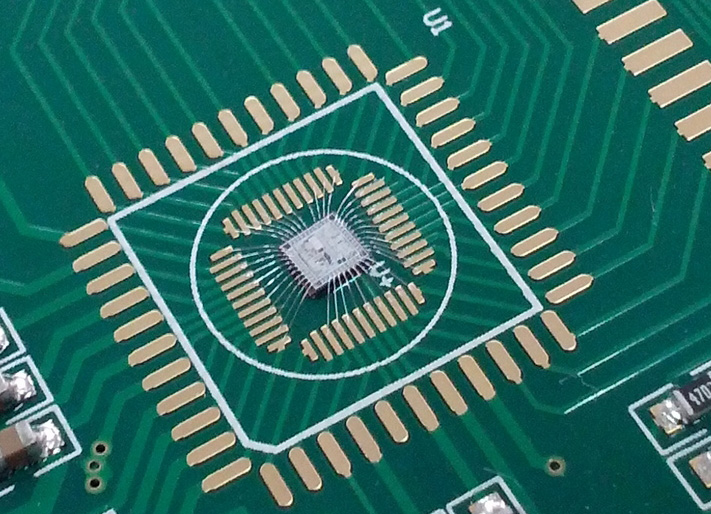

Also, do you guys know what the black blob (with a letter K) that covers/hides the main chip is? It is literally rock hard. I tried to cut into it with a penknife, and it blunted the tip, without leaving a mark on the blob.
It's a COB (Chip On Board), nothing you should be concerned with, you can't buy it, and you can't replace it - the entire PCB is effectively the chip, with the silicon wafer covered in epoxy.
To clarify Nigel's answer, something like this (obviously not the same PCB).
A bare silicon die, bonded directly to the PCB rather than bonded in to a carrier package and encapsulated in that, like a conventional IC.
The epoxy glob is to protect the bond wires.
Is this a reasonable conclusion?
Are you keeping your test leads connected to the same solder pads for both VDC and ADC?
Do you have extra fuses for your meter?
No, the charging circuit will almost certainly be crude, nasty, and really horrible - probably just a single resistor.
I explained the likely reason in post #44, you had the meter set to much too small a range, so much too high a resistance. However, this assuming the 'soldered' connections to the foil are working (which is dubious) and that the foil itself is making good electrical contact.
