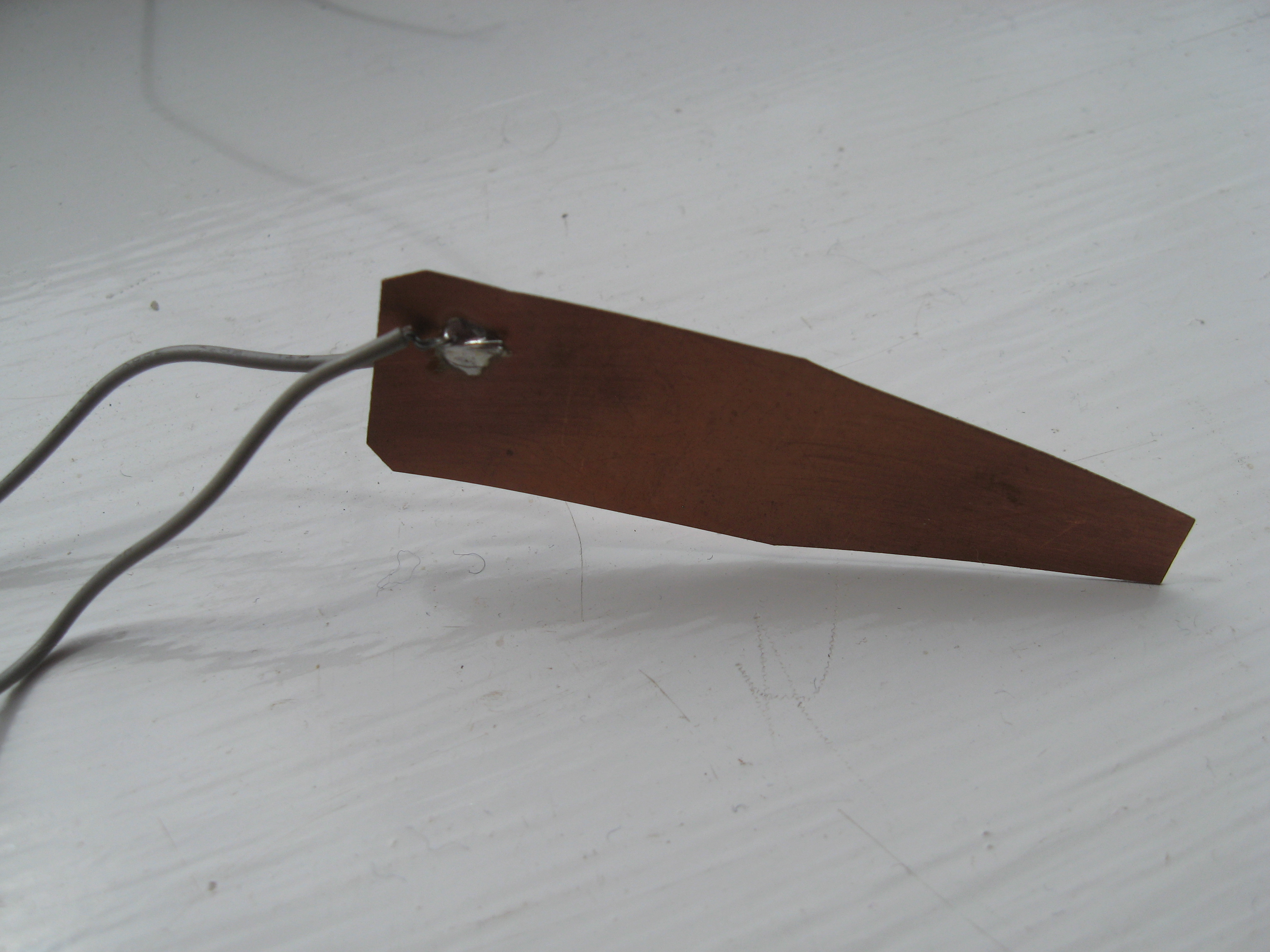

For measuring the current when the cells are in a battery holder I use a piece of thin double sides printed circuit board. A wire is soldered to each side of the board and the board inserted between the cell and the battery holder connection. This is what I use.
I can't remember where I obtained the very thin (0.2mm thick.) board.
Les.
Les.

I found an old circuit board that is thin enough and cut out a section with ground plane on both sides and filed it to fit the battery terminal:
Unfortunately, it seems that all the little dents where the laquer remains after I rubbed most of it off:
must be plated through vias :(; so it's back to the drawing board scrap box.
