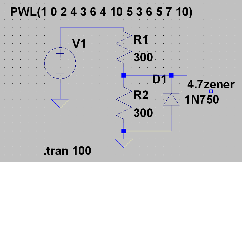

started computing for voltage divider where the voltage is 24 volts and need a min of 15ma.
looked at specs a second time - output is 0-10 volts so all I need is 5 volt output.duh= 2-300 ohm resistors in series will get me just under 17ma.
now wattage??
if I win auction, plan on using 1% resistors. maybe lowering the lower resistor for little less than 5v, like 4.5, just to be safe.
perhaps a zener diode to protect PIC?
but that might affect my voltage reference of 0-10v output from transducer??
not sure about using the zener?
will it mess up the voltage output thus screwing up the pressure readings?
if so, suggestions?

I think you are confusing some things up:
1 - Your transducer needs 24V @ 15mA to work. (Your psu needs to stand a current of, at least, 15 mA at 24V).
2 - Your transducer will output a 0 - 10V . (You don't need a minimum current to have this output. It will output 0 - 10 V, period. Of course, if you have a low resistance load, you gonna degrade the output level).
3 - 300 ohms is too low, you don't need that. Your uC's analog input is high impedance and will not overload the the voltage divider. Use resistors in 'k' range, like 4k7 .
4 - Protection is a good thing. But remember that zeners begin to conduct before the nominal voltage, so you are going to have a small degration.

As Colin and I said, for the voltage divider use resistors in k range. Colin says any from 10k to 47k, I say that you can go from 4k7.
4k7, due the uC datasheet specs, that says "The maximum recommended impedance for analog sources is 2.5 kΩ." (page 184, 17.1)
As the source impedance is the 1/2 * voltage divider resistance, with 4k7 you are going to have 2.35 kΩ
Think about it:
If you use the voltage divider with 300 Ω resistors, you are going to drain about 17 mA from the transducer, which I believe that is too much ( near the limit). And the each resistor will dissipate 83 mW.
If you use 4k7 you are going to drain ~ 1.1 mA from the transducer (you won't overload it, so you are going to take much more accurate measurements), and each resistor will dissipate ~ 5.5 mW (1/180) W (so you can use 1/4W or 1/8W instead of 1/2W).
And you can find 0.5% tolerance resistors, if needed.
The zener you can use is 5.1V, but you must test the accuracy of your measurements.

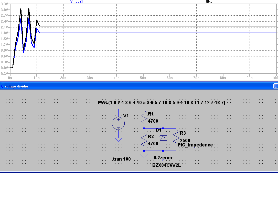

will sim in LT Spice using two 4700 ohm resistors and a 5.1 zener.
Sounds a waste of time? - the PIC input has a minimum source impedance, NOT a resistance, I don't think LTSpice simulates the internal working of a PIC?. Basically it requires a certain amount of source (or sink) current to charge/discharge the capacitor in the internal sample and hold.
If the source impedance is too high, then it slows the rate at which the capacitor charges/discharges. This only really matters (within reason) if you're switching channels - and too high a source impedance will give the wrong reading on both, UNLESS you delay before reading (but after switching channels), to give it time to settle.
here is a sim
with 2.5k load or impedance it drops the input voltage.
Nigel, are you suggesting not to worry about impedance.?
I get lost in this area anyway.
I inserted a 6.2 zener.
The transducer has an adjustment for the span of desired voltage output as well as low output level.
may just do the voltage divider then adjust transducer for actual pressure in tank.
No, with a 2.5K RESISTANCE it would, but it's not a 2.5K 'resistance', it's not really an impedance either.
It's a high resistance/impedance input pin with a small capacitance across it, it's the charging of that capacitor which determines the maximum source impedance.
Which was why I said you're wasting your time trying to simulate it in that way.
